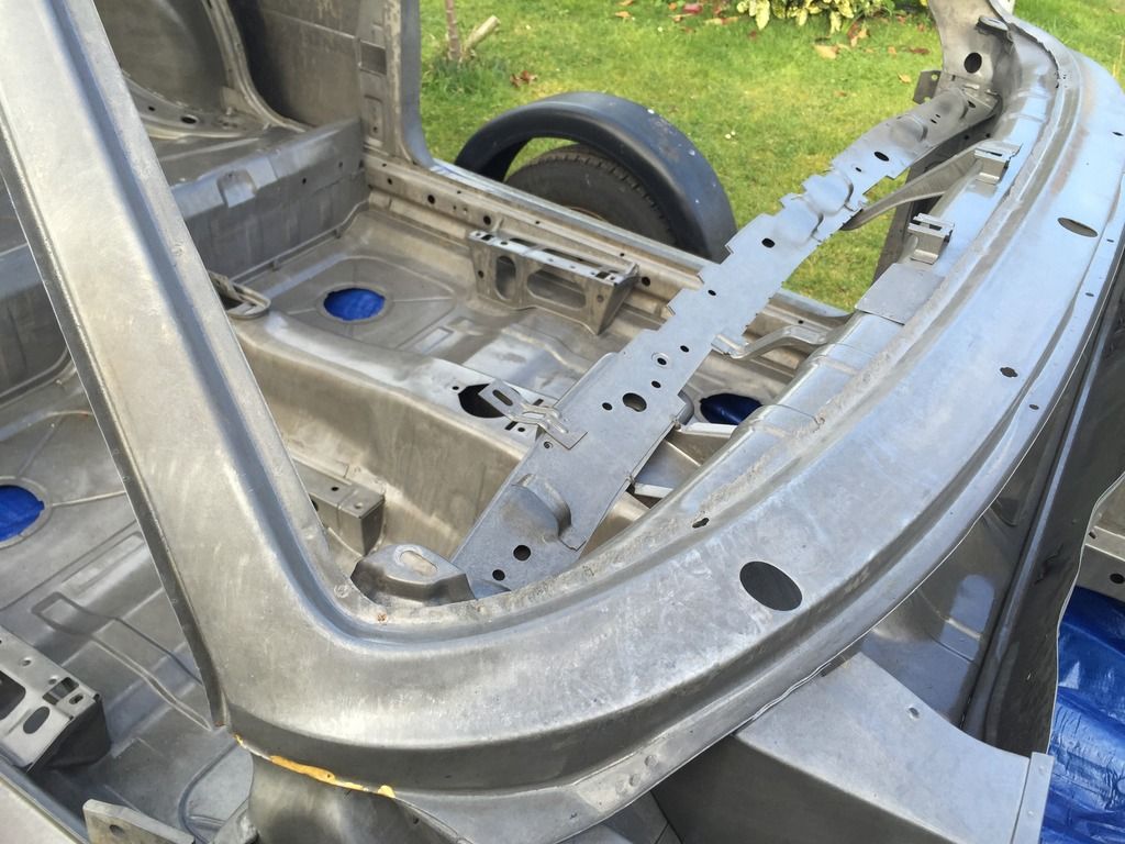

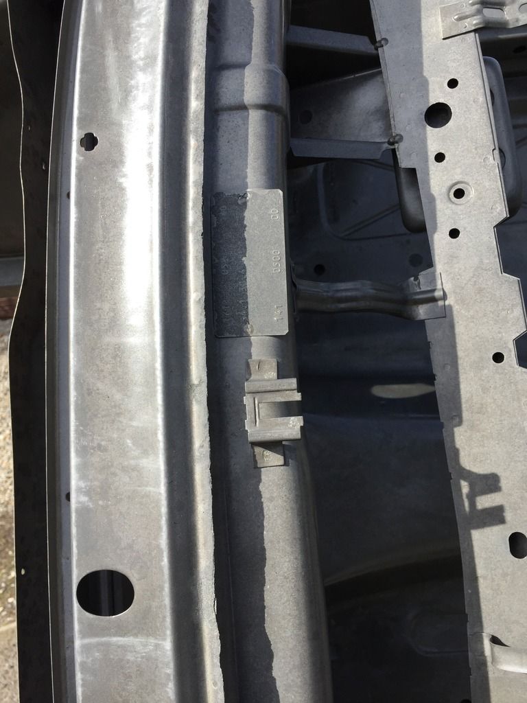

Example under dash tag, this is a 316 but 323 is in the same place.
