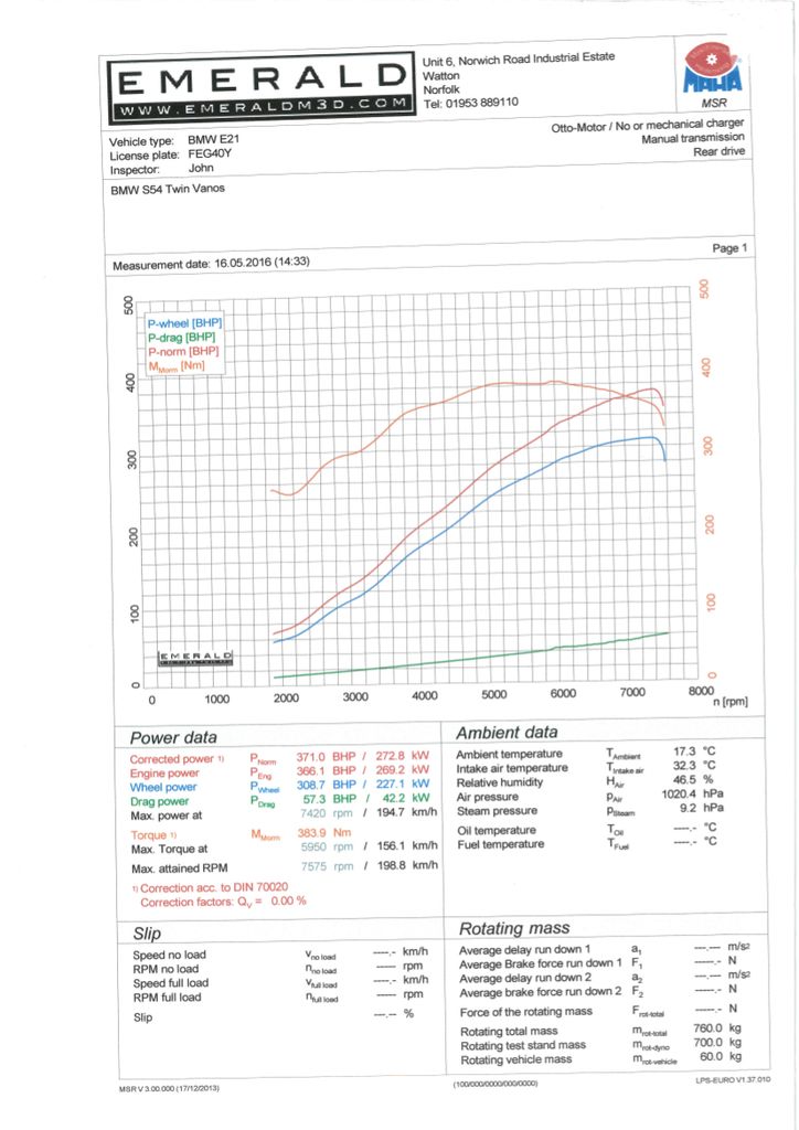

Headline figures from yesterday:
Power: 371 bhp (308.7 bhp @ wheels )
Torque: 383.9 Nm ( 283.1 ftlb )
I'll post a dyno trace later today, you'll see the lovely smooth power delivery its got now.
Very pleased with that, 4 years ago it made 329bhp and 263ftlb with the restrictive exhaust. Was hoping for 355 but got more :D

Posts: 19265
Nice and flat, no strange dips or peaks! All nice and lineair and impressive!

uwbuurman wrote:Nice and flat, no strange dips or peaks! All nice and lineair and impressive!
Exactly, should be nice and controllable with the delivery. He did a lot of work on the vanos control and the fuelling to get all the gains (raise any dips) on full throttle.
He also spent lots of time on part throttle settings as well so it should be controllable/responsive at any throttle position on the road.
I'm very impressed with 114bhp/litre from this bog standard engine.
Maybe in a few years I'll look into cams and compression but for now its enough :mrgreen:
