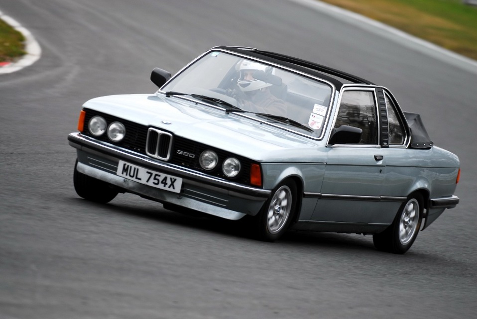

Have lots more, will post soon, but you can see how fast it was going!

1982 Saphirblau Baur 325i

Looks great!
This is a good one... You can see your determination in the mirror!
