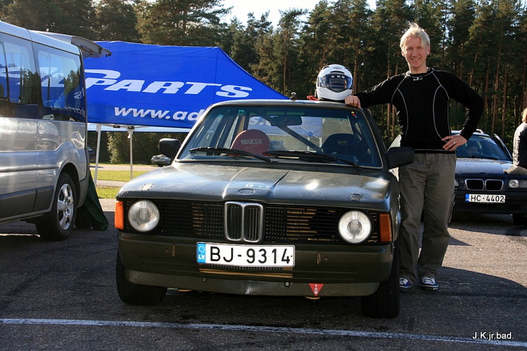

So finally in mid of 2013 my car was ready to go to track and have some fun! Of course some issues were still present but they didn’t keep me from running this green sharky.

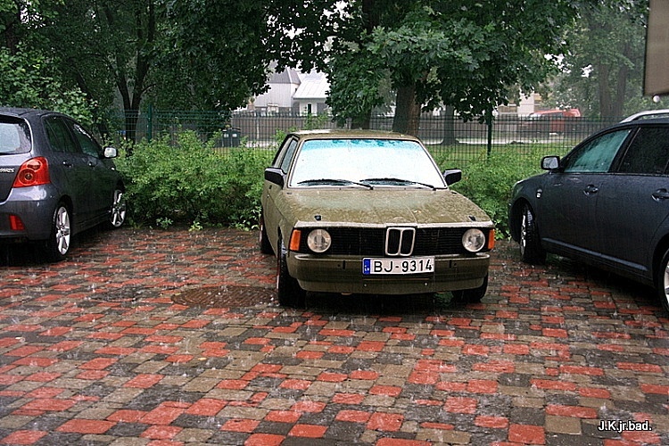

So first baptism of fire was on 18th July. It was damn rainy evening. But that couldn’t keep me from going to track! Too much waiting!
Remember I was talking about sex with this car. So I very hoped that this sex will finally give me some pleasure.
Let it rain!
In the same day car got tuned with a help of specialist on the phone. It gave some results. Car got little bit more power. But still there were some strange issues. Time after time it felt that one of cylinders is not working. Later problem was found. Bad coil. So they all were changed to brand new.

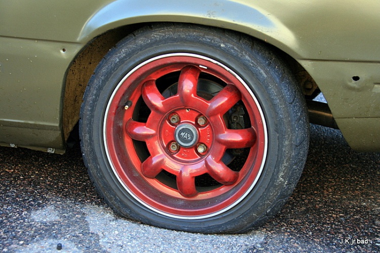

On first training session everything was fine till I started to feel some misbehavior on corners. Stopped for a look and found that rear wheel was flat.. thanks to stiff suspension I didn’t damaged tyre.
And I had another problem. I even didn’t had a tire wrench.

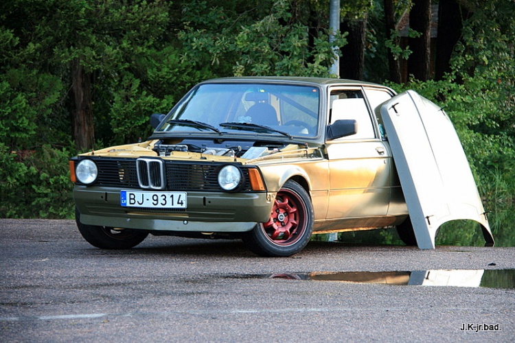

Some small photo session before something will be damaged.

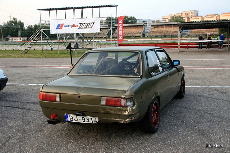

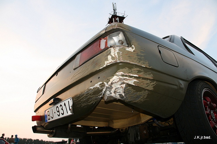

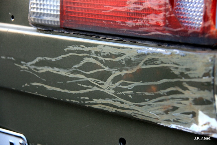

On some lap trying another way how to pass a corner car got little bit out of track and uncontrolled sliding accured. Thanks that it was only a wire fence not concrete blocks.
After some minutes of fresh air and I was back on the track. No regrets. This car was built for going on track on to the exhibition hall.
Later just rear light was changed and nothing else.
The rest will be repaired some time later.

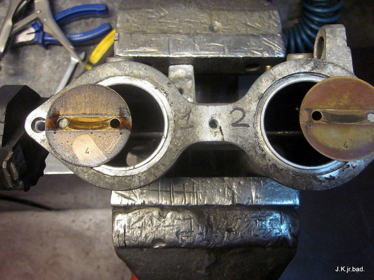

After some training I felt that car is running nice only on full throttle. Later we figured out that TPS is gone. Changed it and everything was fine again. While changing it I noticed that left side engine mount has broken. Alloy couldn’t hold that sport stress.
Luckily I had one spare steel one in garage.

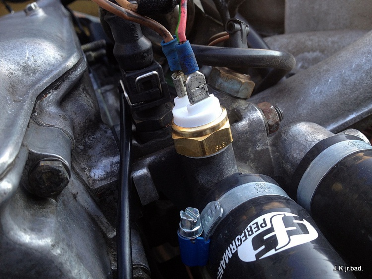

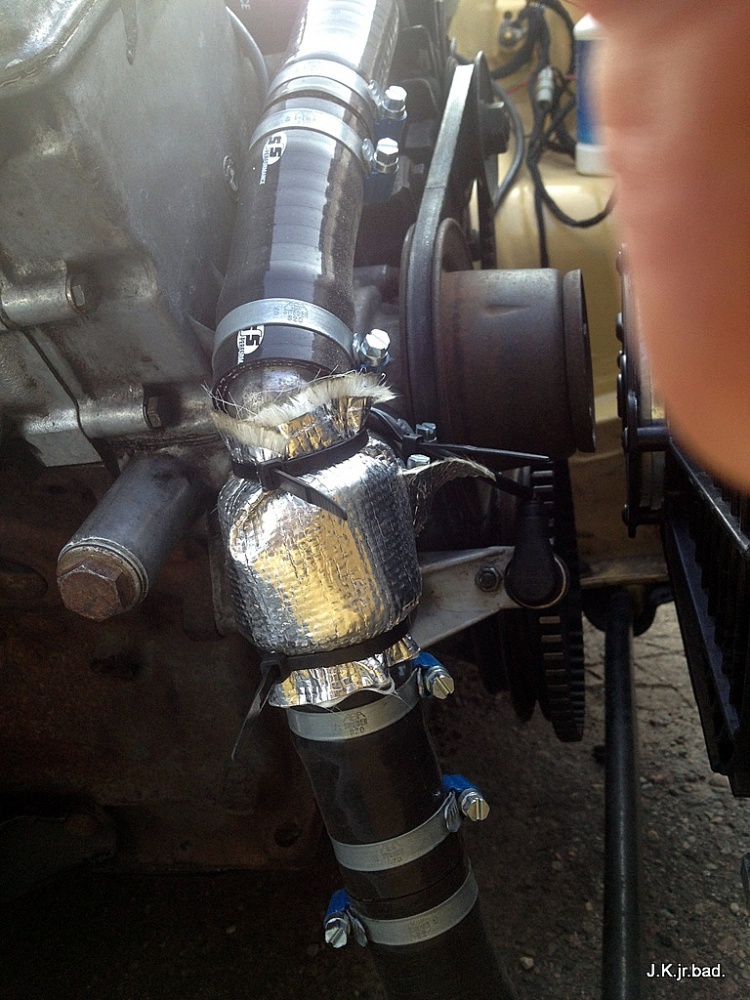

My next upgrade was putting a coat to thermostat. Driving in race regime I noticed that temperature was a bit too high although I had big radiator and powerful fan. Somehow I figured out that perhaps air that was getting on to thermostat body cooled it and didn’t let it open wide. I don’t know if it was true but it helped me.
Also I found some faulty thermos switch for radiator fan. It was switching on too early. It was changed to new.

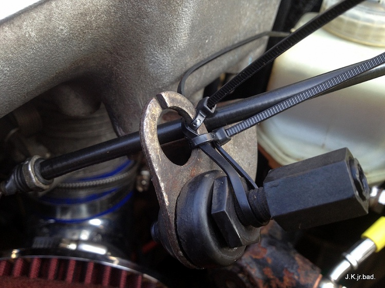

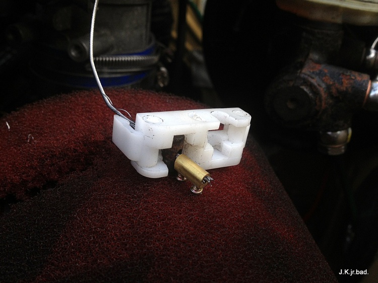

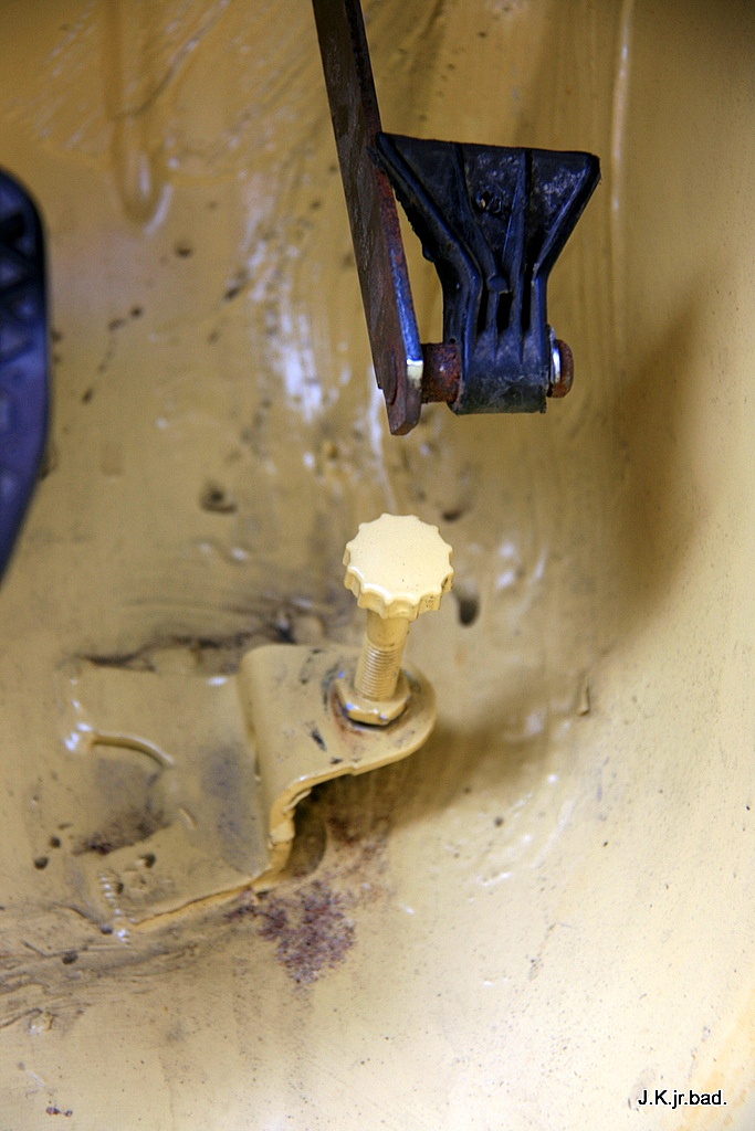

And suddenly I lost connection between throttle pedal and throttle it selt.
Yes I broke the cable….
It was my fault as cable setup was faulty.. Original throttle pedal was incomplete and I could push pedal deeper than it should go…
This is how it looked like. I think you have noticed what’s have been missing…
And once again I was on track naked as church rat. No tools at all. Just Cola and Snicker.
Lucky my teacher had something and with improvising he managed somehow to renew throttle connection so I could get back to my garage.
Bunch of cable straps and here we go!

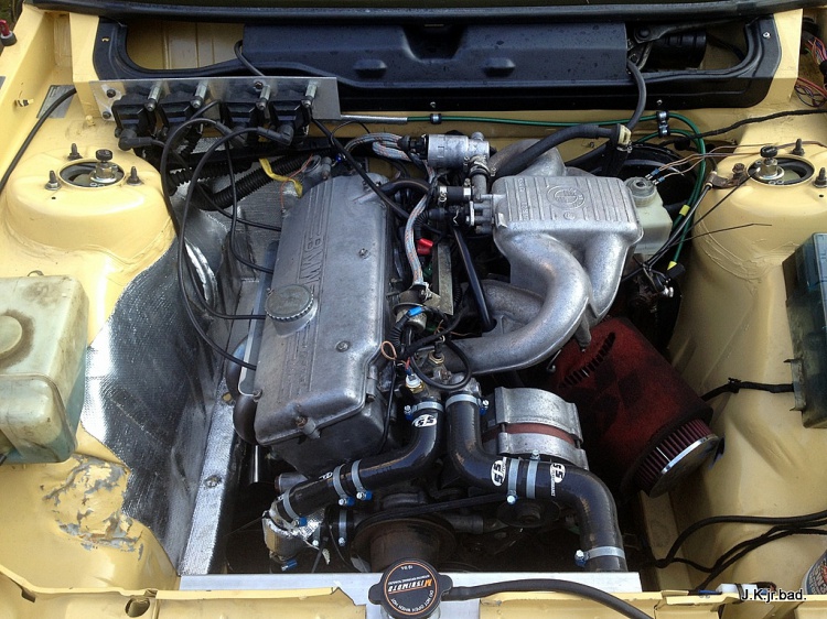

Just some picture of engine bay

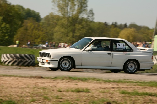

On September 22nd I participated in local Youngtimer event in Sigulda.
More info on Youngtimer events:
http://youngtimerrally.lv/
Event went well I took a third place in “sport” class. But it could end in ditch as well.

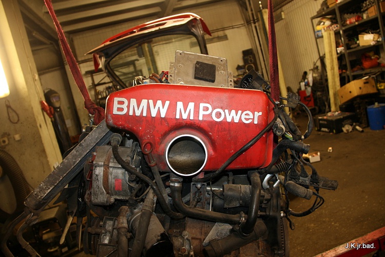

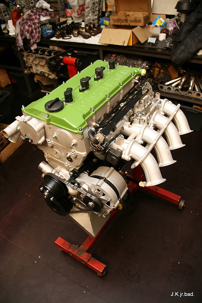

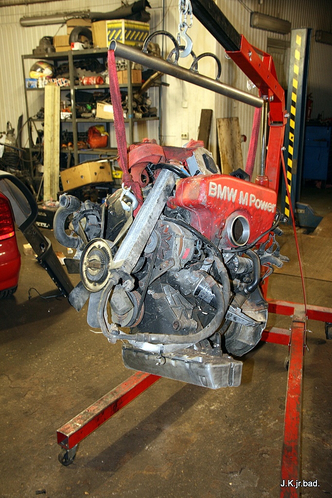

After season 2013 I decided that I need more power. So I took out my m10b20, gave it to one guy who knows something about building performance engines. He had a look at it, we made a list of what we could do and almost started to work on it. But then somehow remembered that couple years ago we tried to get s14 engine from some guy who kept it in basement for several years and didn’t want to sell. We did another try and we were lucky to get for my car s14 engine! Much money but we got it including original gearbox.
This engine use to be in one very well know M3. It use to belong to owner of Latvia’s biggest BMW forum owner. So everybody new it. This car even use to do some small competitions.

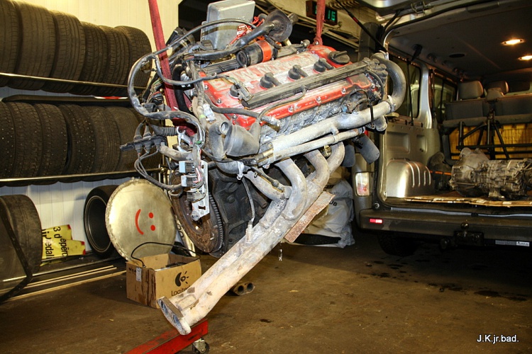

This is how it looked when it was in one piece. For some reason engine and gearbox got to one guy and the rest to another who installed some bigger M engine in it.

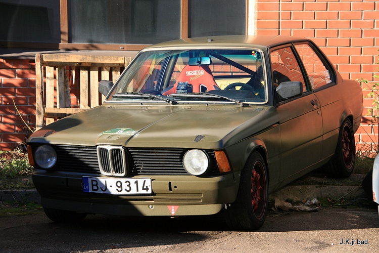

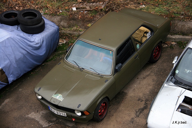

This is how car looked and the end of season waiting for new heart

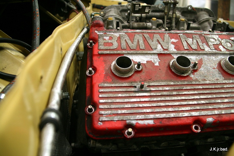

This is how new engine looked like when it was bought

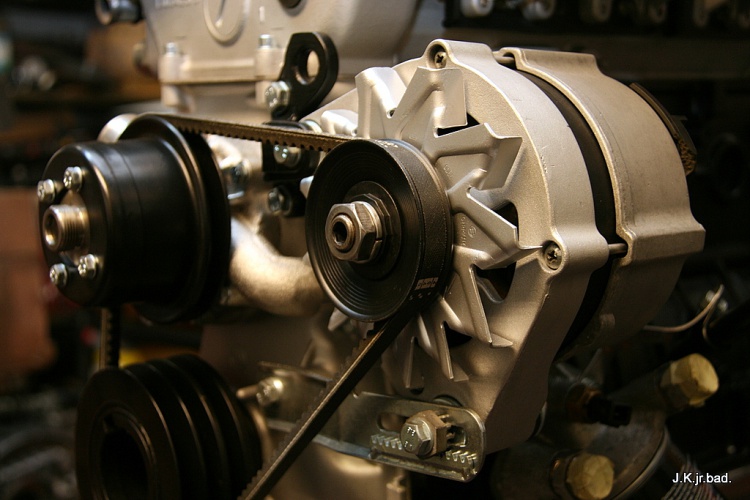

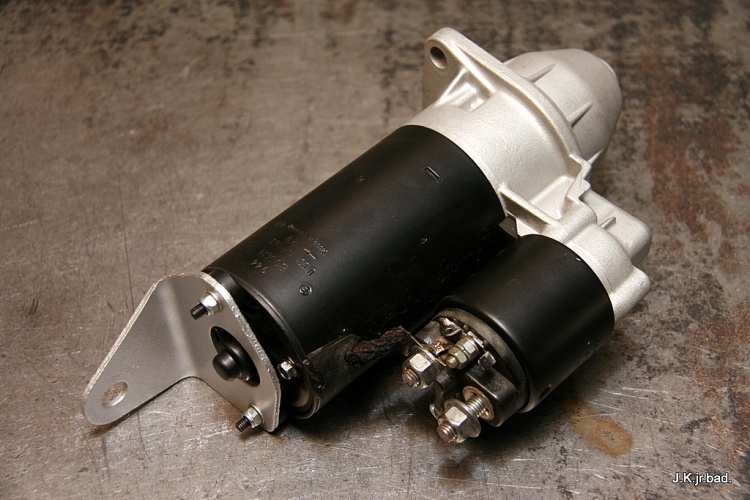

As you see it is fully equipped including starter, alternator, all the wiring, ECU and gearbox. Car originaly came from Switzerland so it had 194Hp.

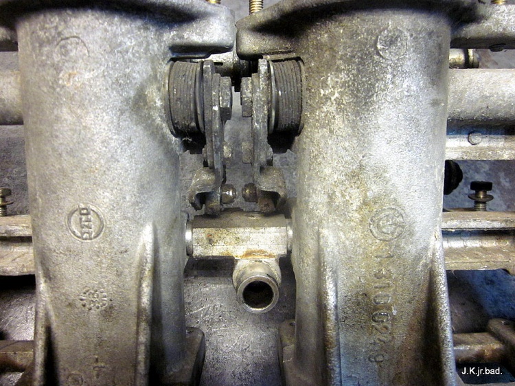

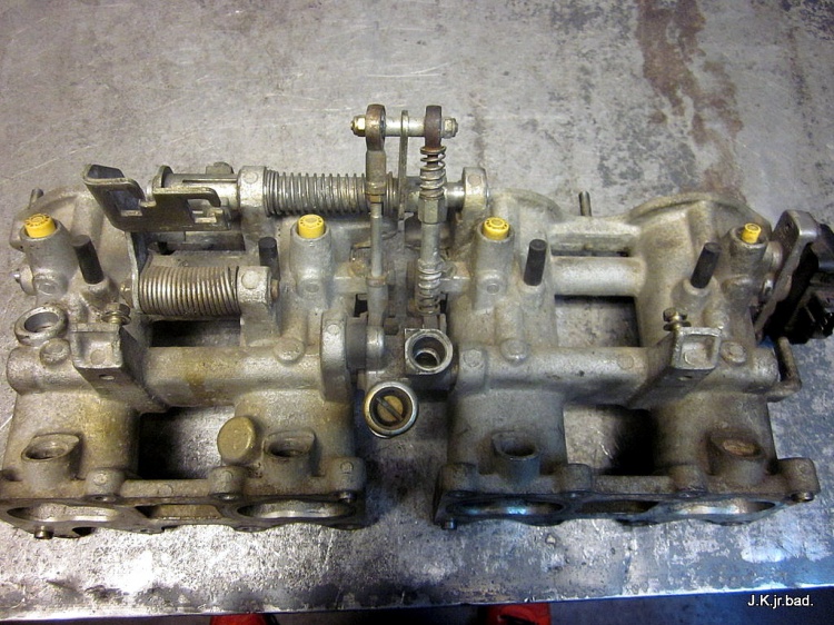

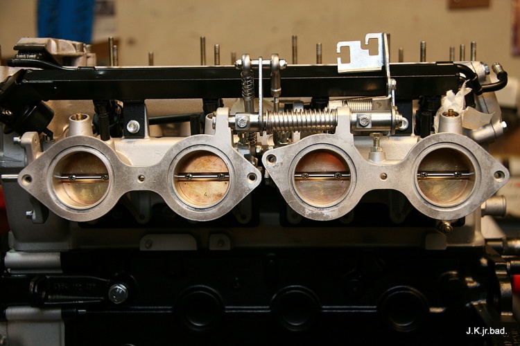

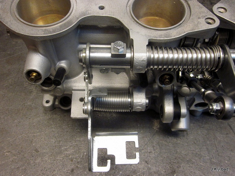

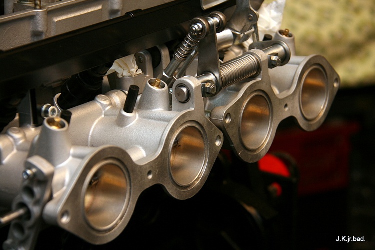

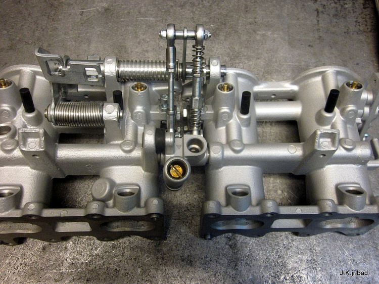

Original intake manifold will be changed to some sporty carbonfiber one

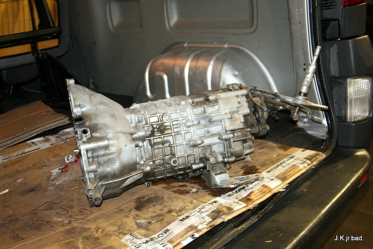

Dogleg. Now I have three of these boxes. Each from different car.

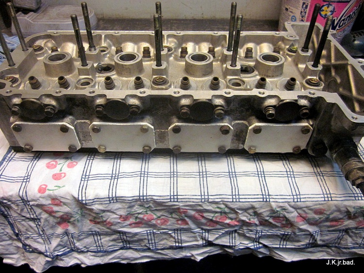

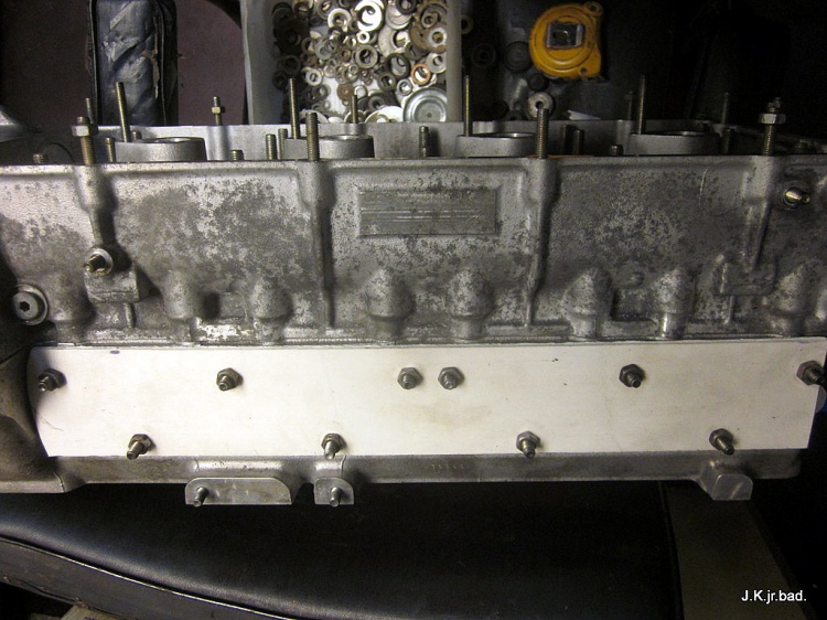

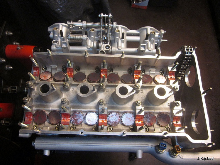

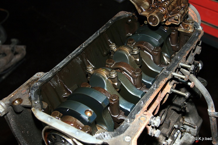

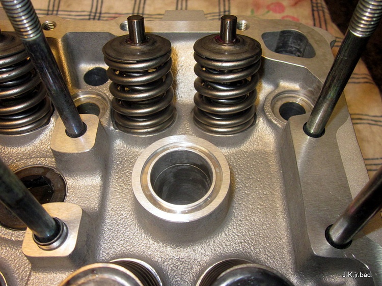

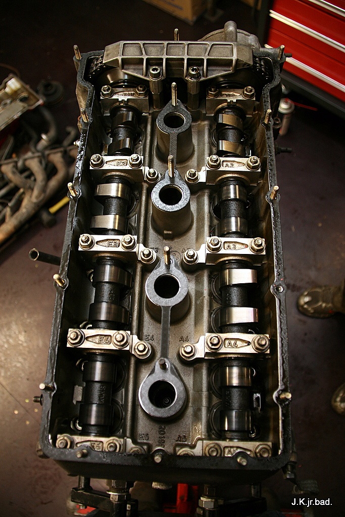

Always such engines have to be stripped out to have a look if something have to be changed. Otherwise very expensive damage could accrue.
But everything was looking very neat!

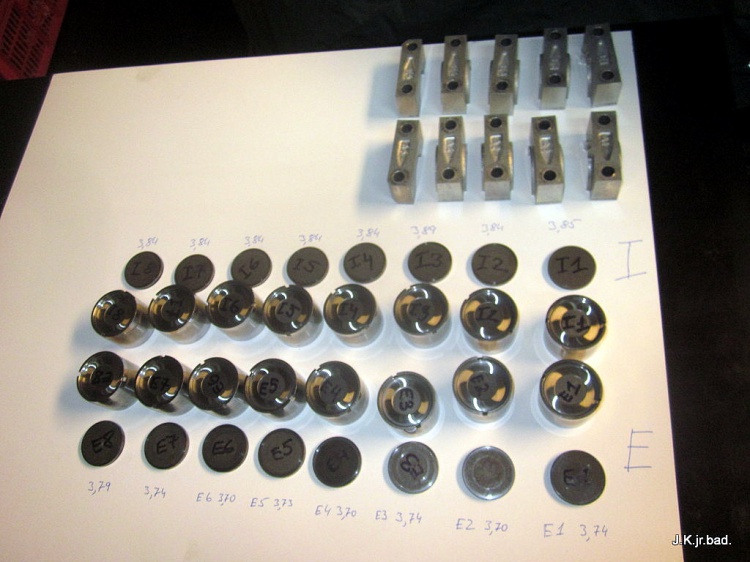

Some measurements were made and everything was fine

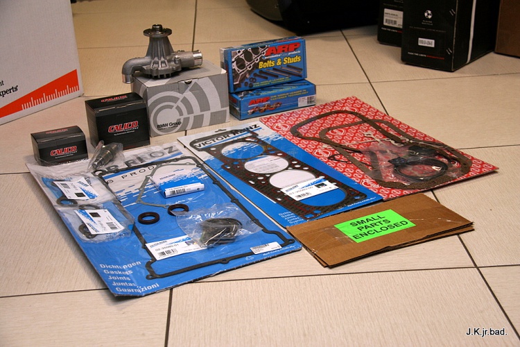

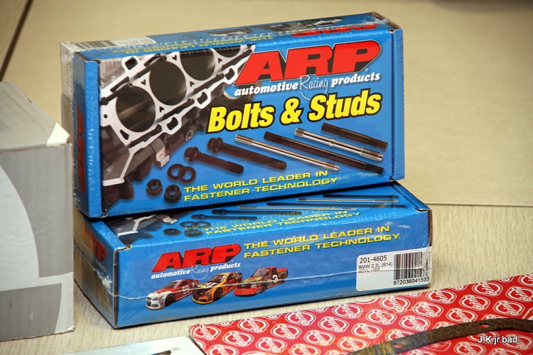

Anywas some special parts were ordered

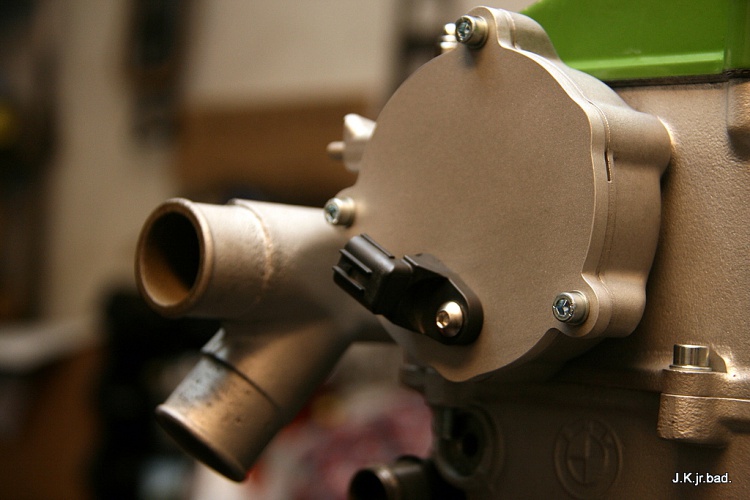

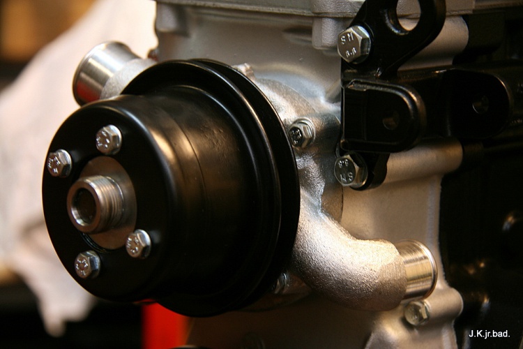

ARP studs

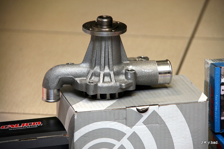

A very expensive watterpump…
Some NASA out of space bearings.
Black hole edition

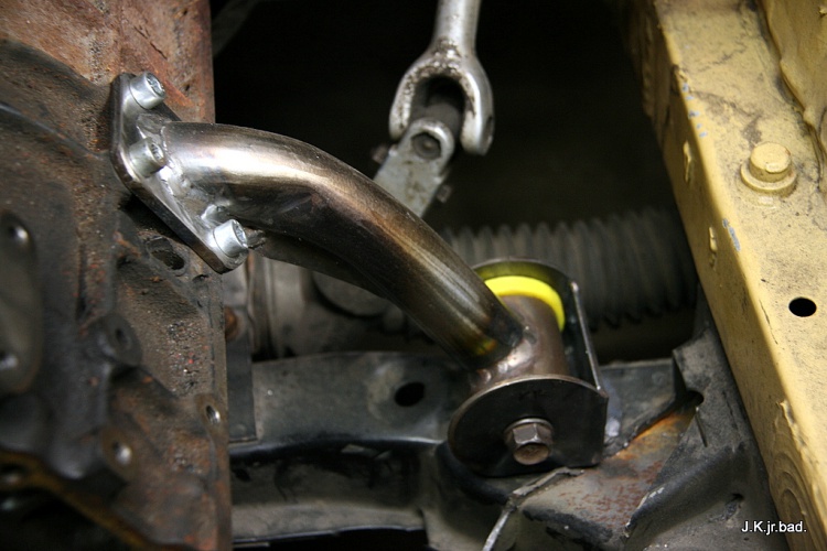

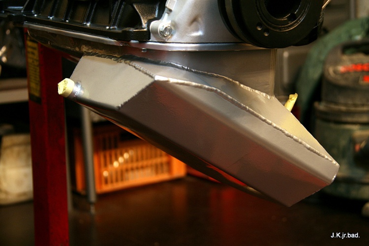

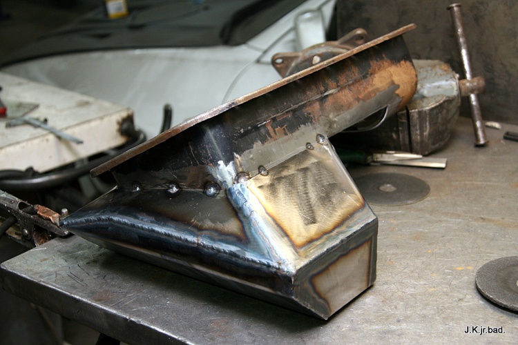

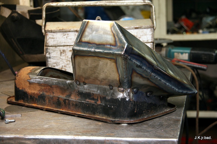

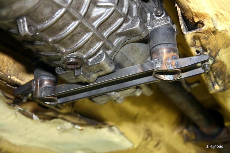

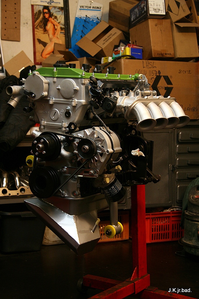

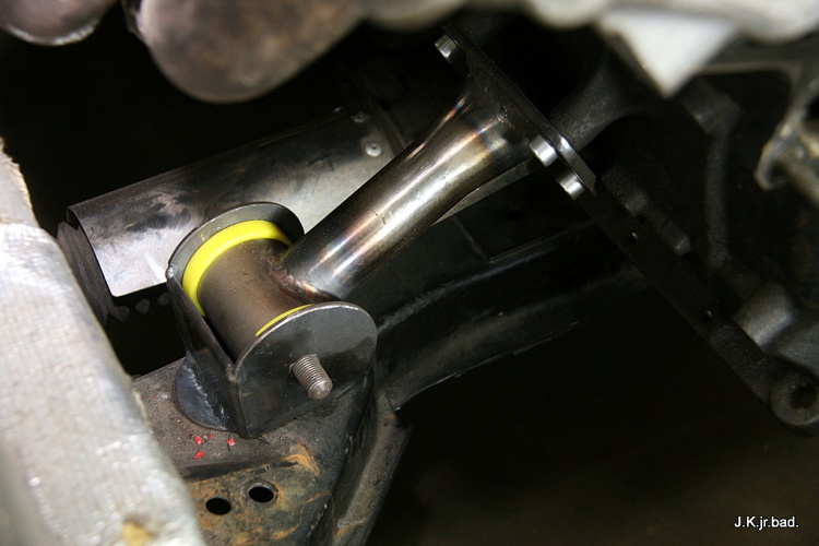

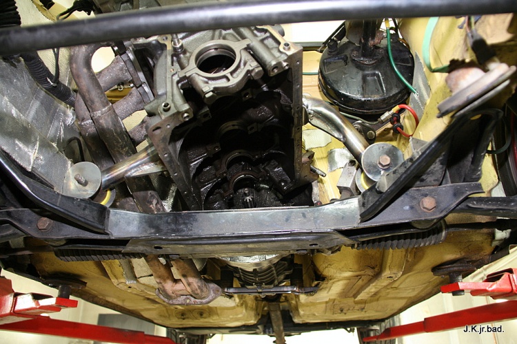

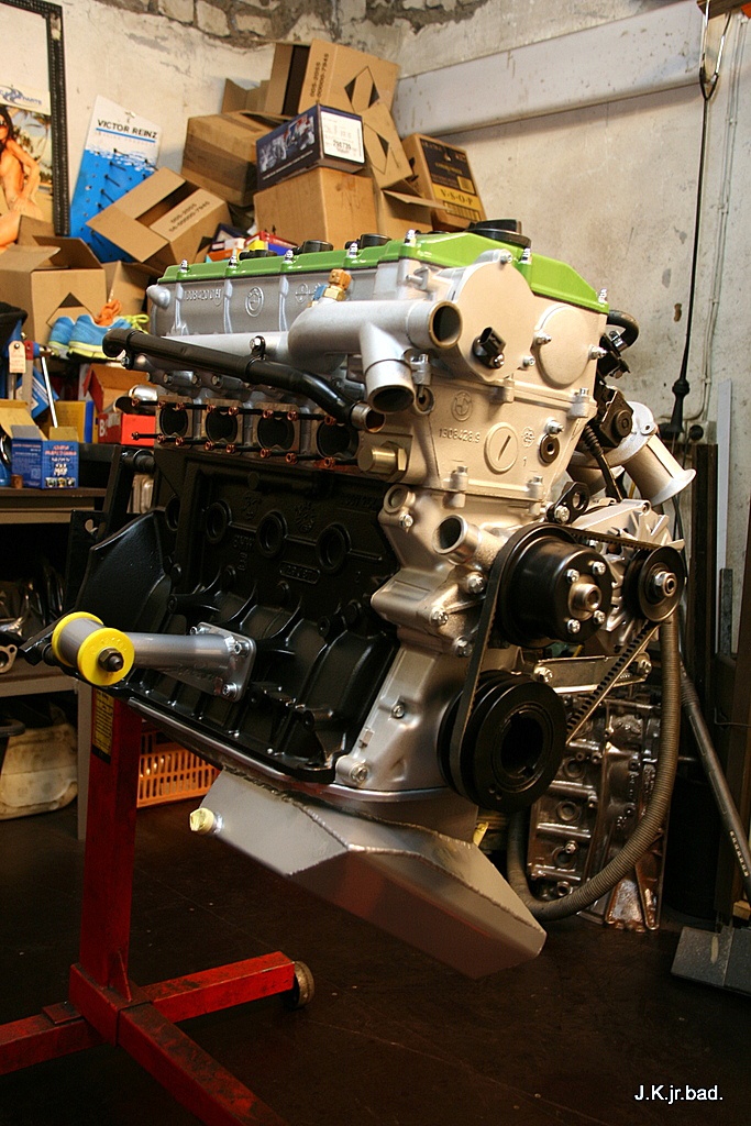

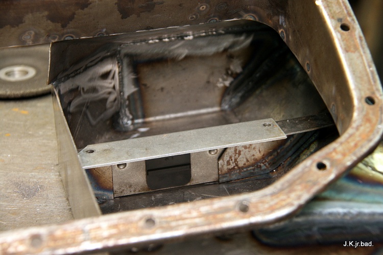

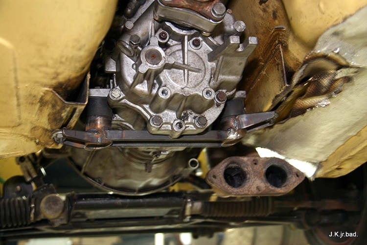

As original s14 oil sump didn’t fit in to e21 we decided to go hardest way. Put engine back as much as possible and make a new sump. Of course new engine mounts were made as well

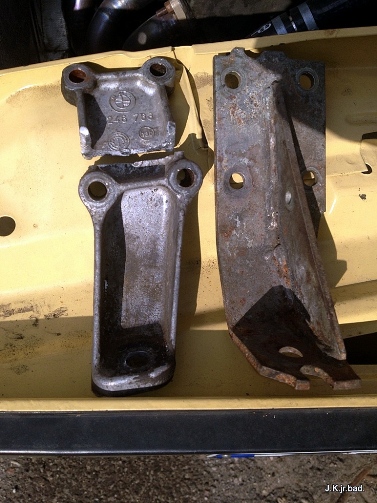

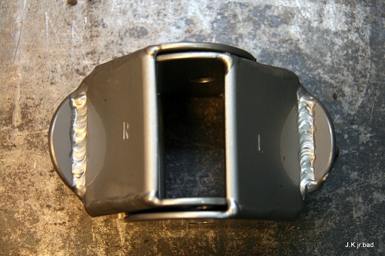

Custom engine mounts
New brackets for gearbox as well
Propeller shaft had to be shortened to fit new setup
New oil sump getting done
Oil gates installed
Some cubic piece of art

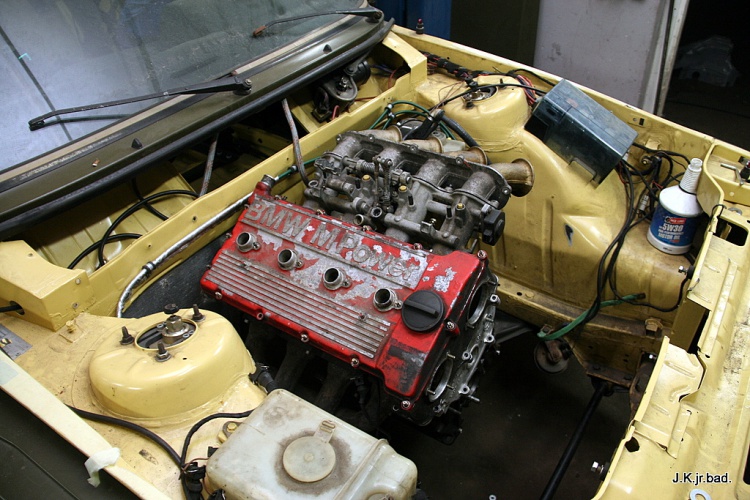

Before renewing engine it was used as dummy

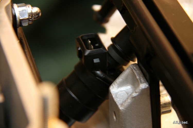

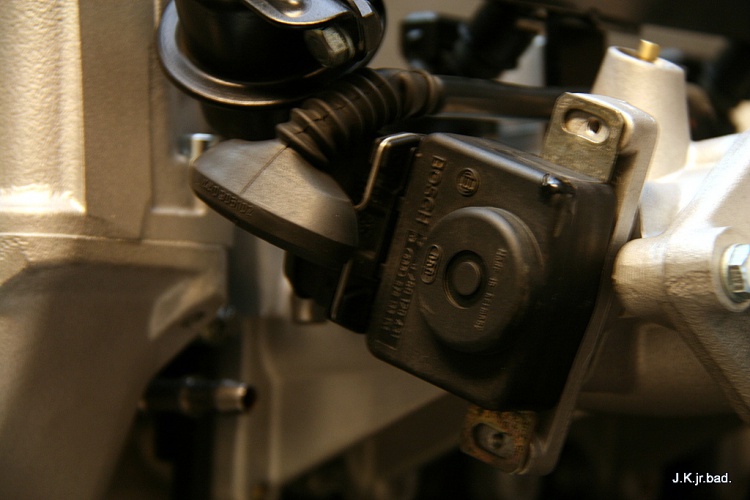

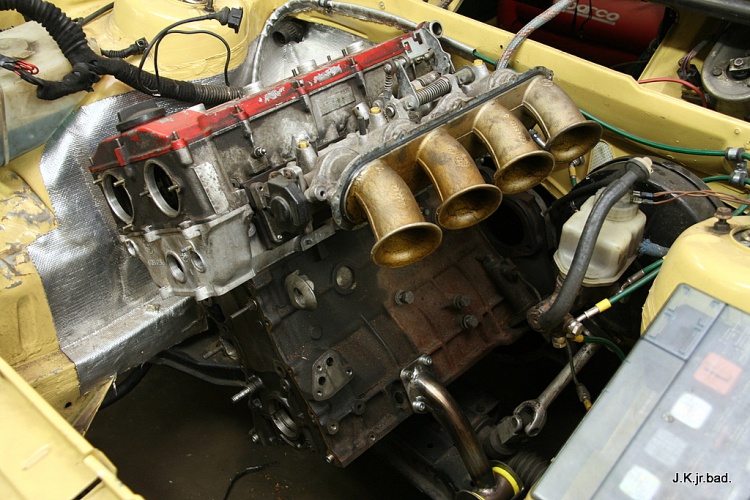

Some 5cm of space were eaten. Looks fantastic, but it has one drawback. Now it is very hard to take off gearbox as you almost can’t tilt the engine back.

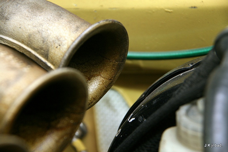

That’s how intake trumpets look inside manifold
Few cm clearance between trumpet and brake booster. After some time brake booster will be deleted

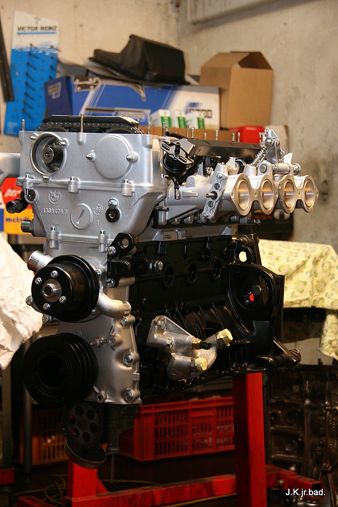

When engine fitment was done engine guy started work on engine.

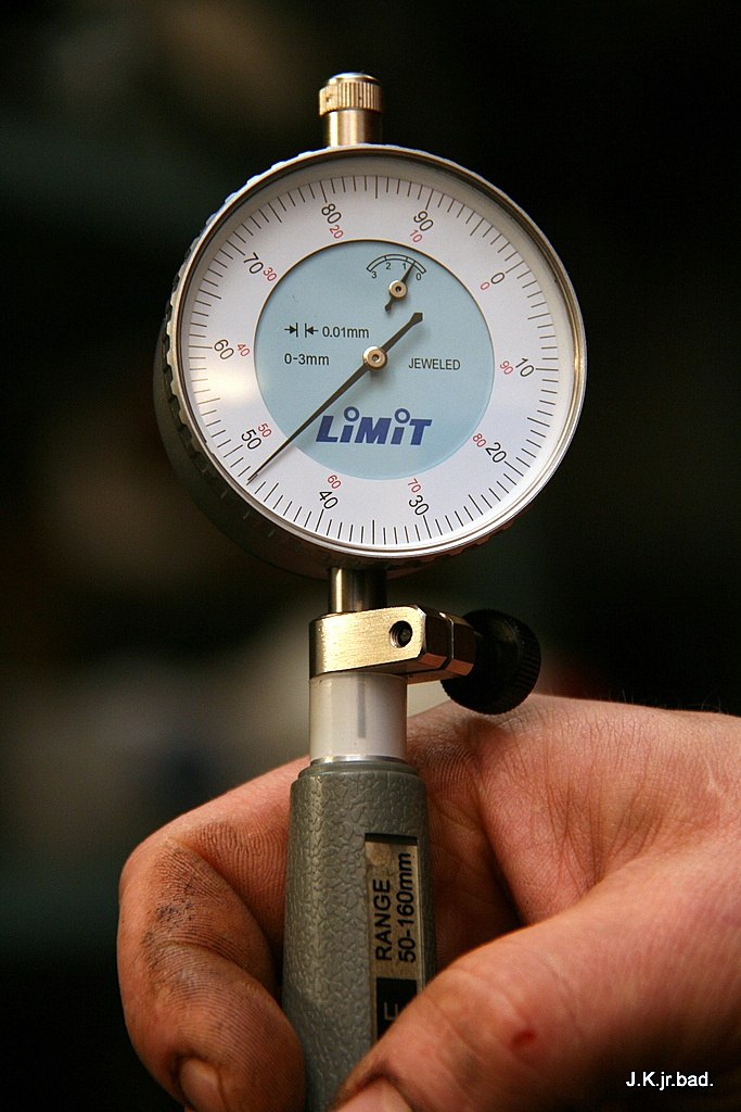

Everything was cleaned and measured. If needed painted.
As engine stood for a long time it had as we say big cultural layer on it.
Everything numbered

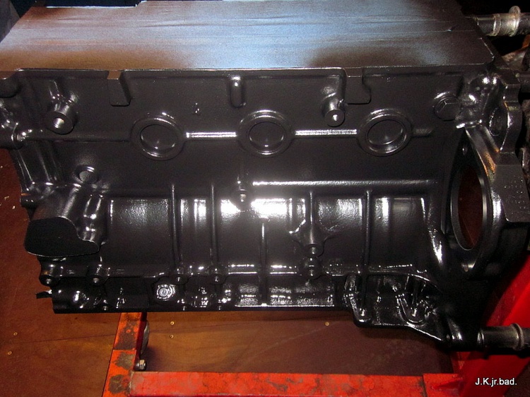

Everything was cleared with ultrasound and later with glasblaster
Some cosmetic work on engine block as well

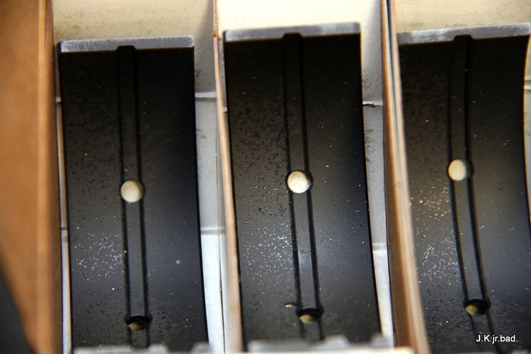

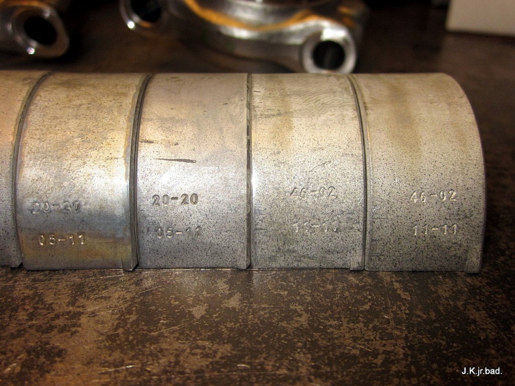

Old bearings

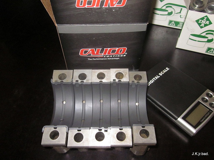

New bearings
Slowly but surely moving to finish
As new!

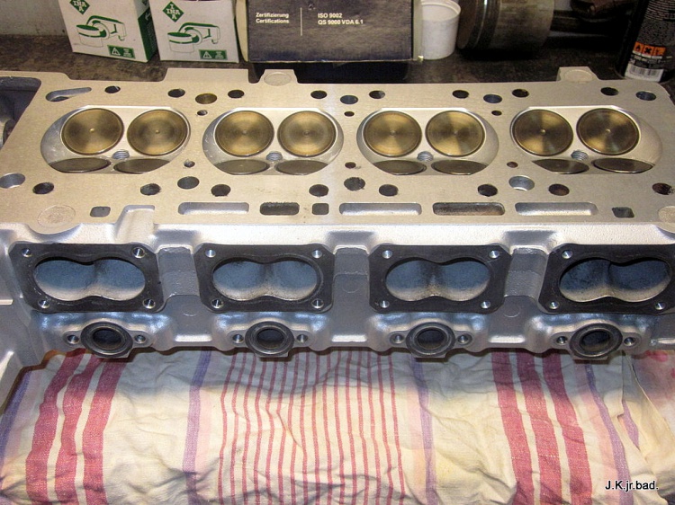

From both sides

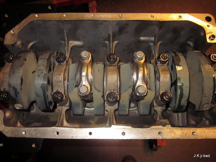

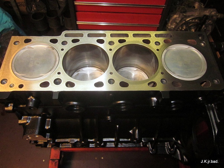

Everything numbered and measured to get best results
Isn’t it pretty now?
None of parts were changed!
Everything assembled with RedLine Assembly Lube
Just need to feed gas and crank it!
Awaiting for new studs for exhaust manifold

Alternator was rebuild
The same with starter
New TPS came from some Opel but latter was changed to BMW. It was smaller.
Original spark distributor was change to back plate and camshaft sensor installed for fine engine tuning

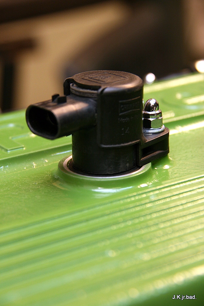

Intake temperature sender. This is from BMW but will be changed to VW which will work faster.

At the moment engine is in car and some other work is done slowly. Unfortunately season 2014 was skipped due to lack of time…
ARP studs
Black hole edition
Oil gates installed
Everything numbered
Old bearings
New bearings
As new!
From both sides

Injectors were checked and were in good shape!

30.05.2014
That day had come! Engine done!
Car freak test.
What did you noticed first in this picture?
All beautiful from both sides!

Car finally arrive back to home.
Almost everything in its place and wired.
Nice and almost neat. I would have done some things different way but visual quality is good.
