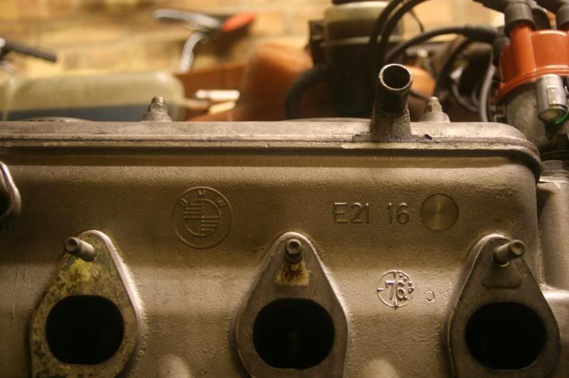

Hey,
You are right about the kidneygrill. The black shell is different at a VFL E21 then at a NFL E21. The chrome part you can keep.
Gr Peter V
Gr Peter V

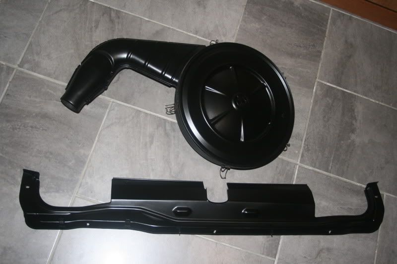

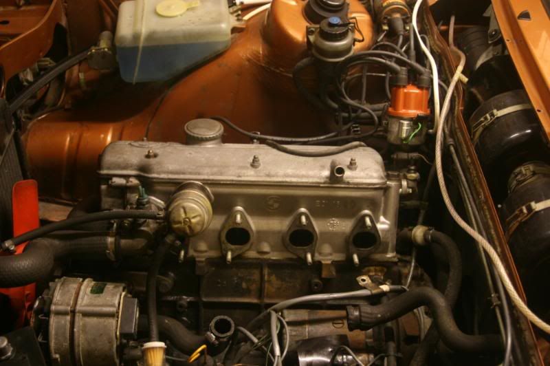

Just a quick update.
There has been a lot of stripping down going on under the bonnet. The manifold is off and getting ready for paint. The carb is just about to get a full re-build, all the parts have arrived and Friday night is 'carb night'
Just a quick pic of my spray work.
I will get a few clean engine bay pics soon as its put back together.

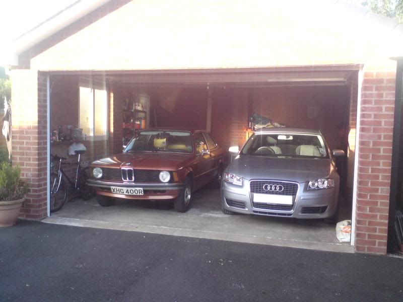

One small pic.........Old skool german against new skool
I have however fitted a set of front brakes and given the old girl a blast around, mainly to try and clear a miss fire I have. Due to the car standing for some 12 years it has a sticky valve or atleast something not quite right with it anyway. When on the open road it runs very very smooth, far better than my daily drive 316, mind you its done a fraction of the miles. I'm hoping to get it MOT'd this coming week, its gonna be more like a hit list of problems but until then I will remain positive!
