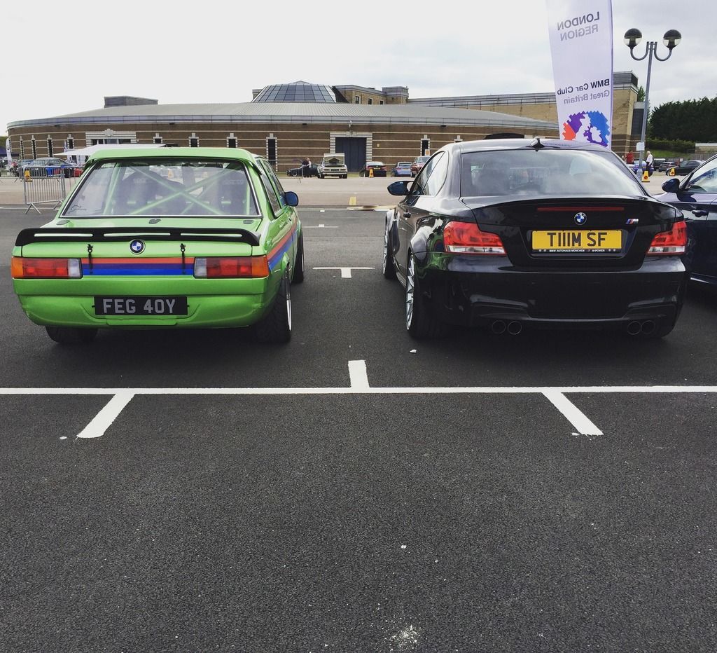

Long time no update, after Shaarknose last year I got the car MOT'd and n the road and drove it up to the National BMW Car Club meet at Gaydon.
Parked up next to a 1M to see the size difference lol.

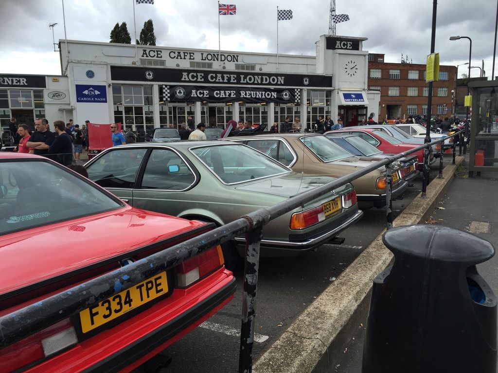

After that Kos (Pukar Designs) organised a Sharknose meet at the Ace Cafe so here are a few pics:
Cheers

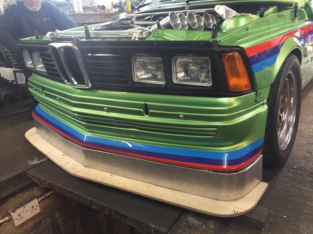

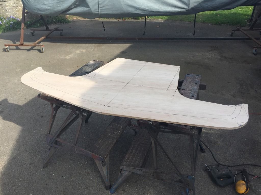

Then started with the Marine Plywood splitter, which reaches back to the subframe:
Then painted it satin black to try and blend in a bit:

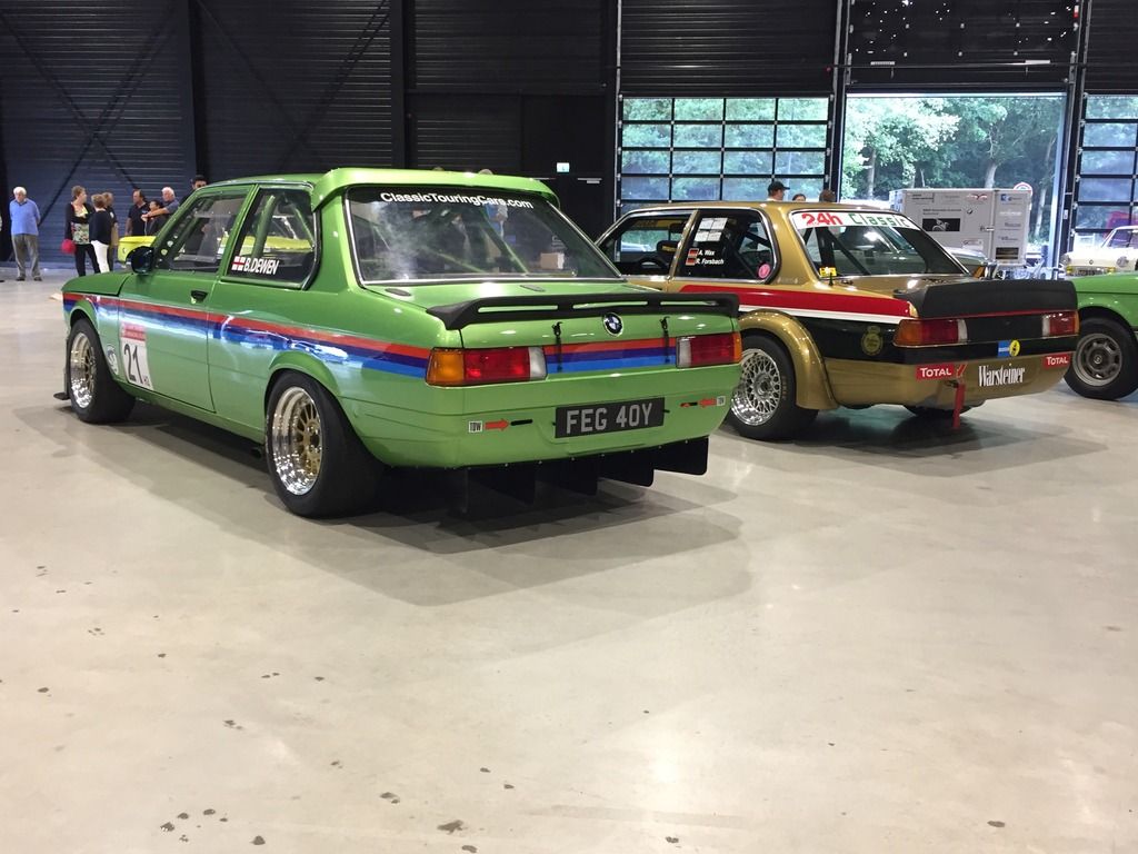

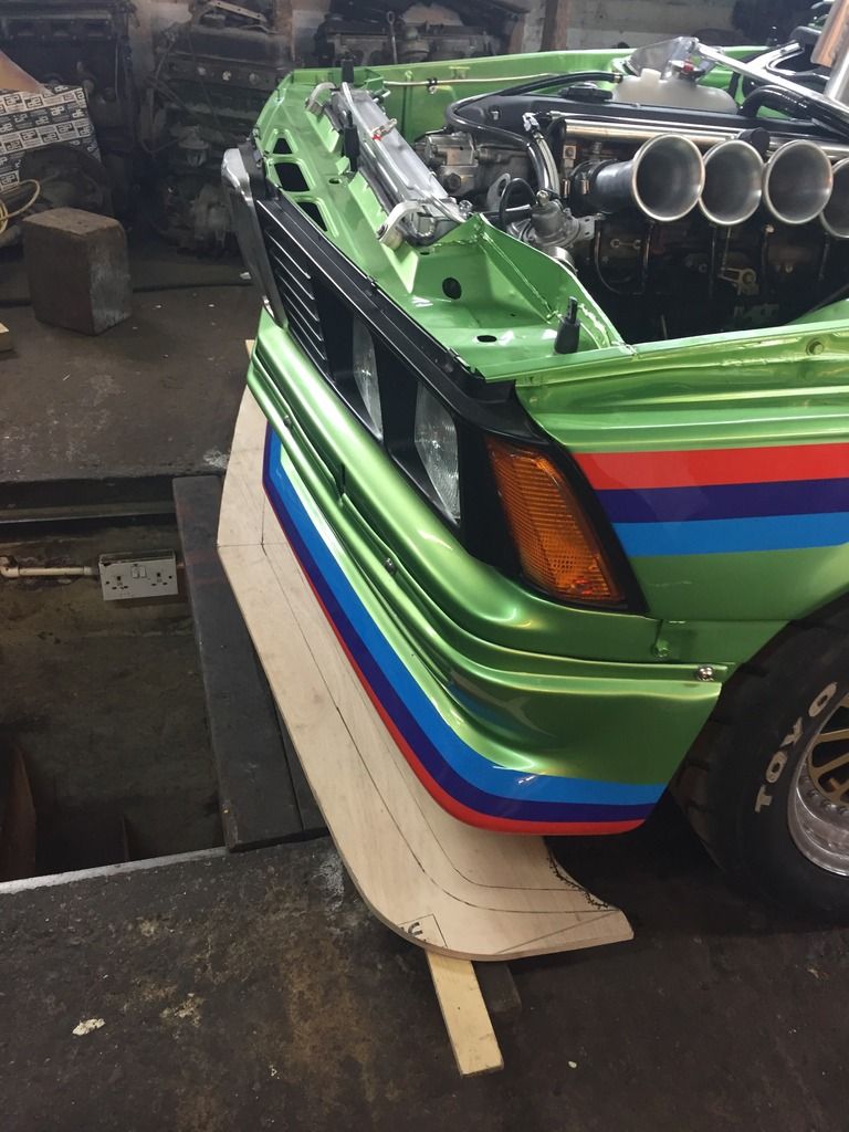

After Rockingham I decided to build a diffuser to get rid of the parachute style rear valence and maybe get a bit more rear end grip on track:
Then there was the trip to Sharknose and the meeting with Jeroen's Apple and an original Group 2 car:

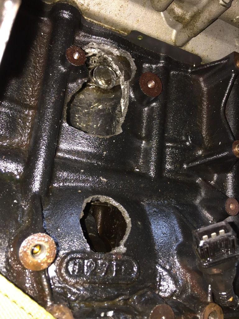

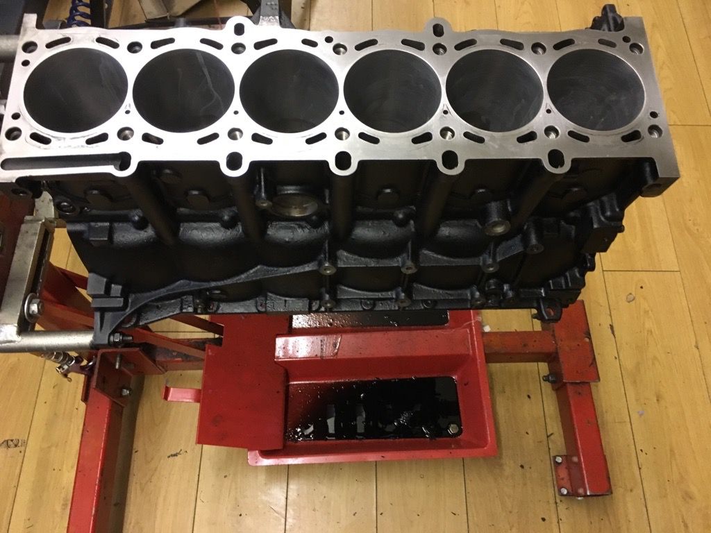

Then disaster struct with oil starvation siezing a big end and snapping a conrod:
Duracel79
Posts: 811
Post by Duracel79 »

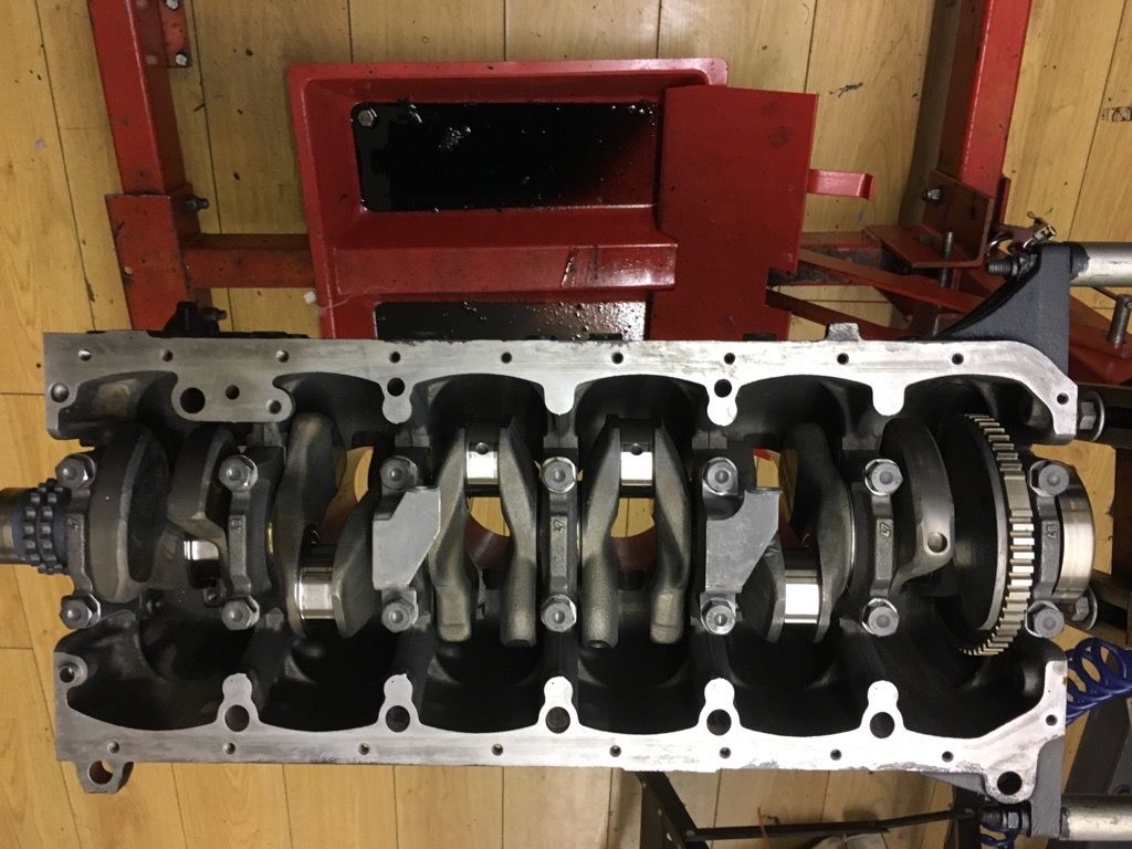

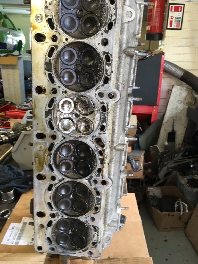

The S54 was toast, with not very much salvaeable:
So a large bill later with a replacement head/crank/block sourced and then some shiny new bits:

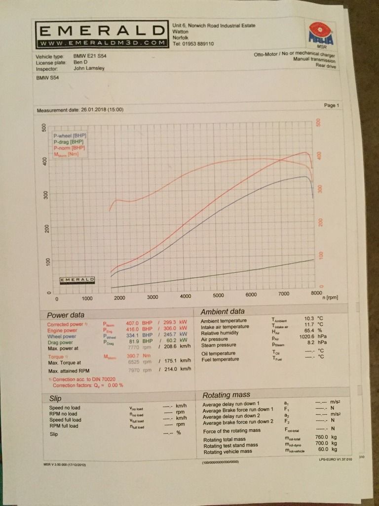

And the result of all this after mapping up at Emerald:
I think I may need a big rear wing to get traction now :bag
