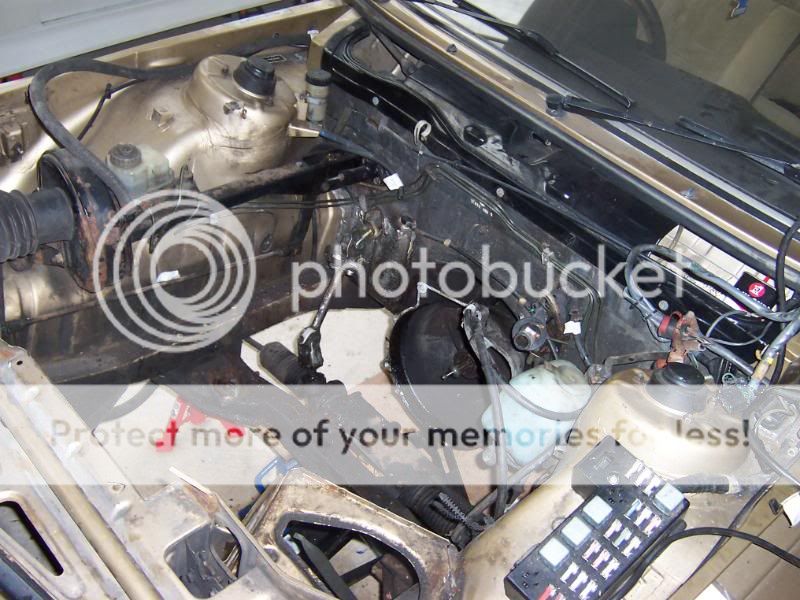

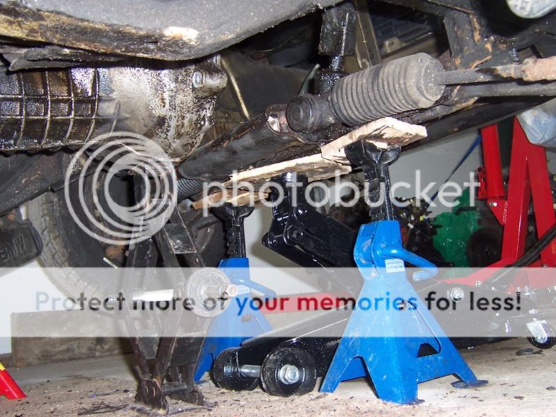

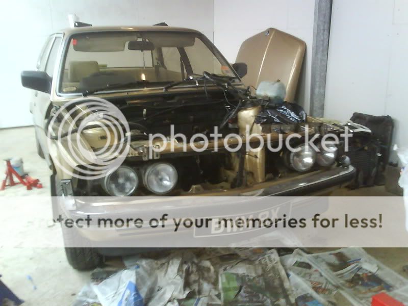

Been down to work on the car today and progress has been made. Check it art!

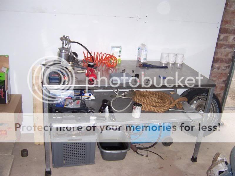

And 2 new additions to the workshop that made things alot easier
Whipped the battery tray of before we left
Cleaning time tomora!

ooooh yeah, its out! good show!
you left the box in then? any other problems?
all ready for next weekend.
dont throw any of the e21 loom away, we need to cut it up to pinch some wires out of it. have you got a soldering iron and stuff?

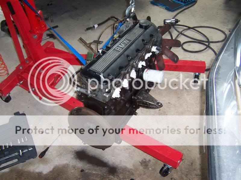

Think i got a flywheel cover plate with the new engine. Is it the same kinda thing as the one thats held in by 4x 10mm bolts on the 320 engine ? Didnt have too much trouble taking it out really. Was a bit of a squeeze without taking the fan off but dont think we damaged anything in the process. Im goin to start grinding rust, spraying and cleaning the engine bay and underside of the bonnet this week, then we can hopefully get the engine in on the weekend.

i just reused the flywheel bolts. put a drop of thread lock on them and air gunned them in.
Re: DrGonzoPOW's 1981 320/6 - M20B25 It Begins!
Same as. They should be fine with a drop of thread lock.

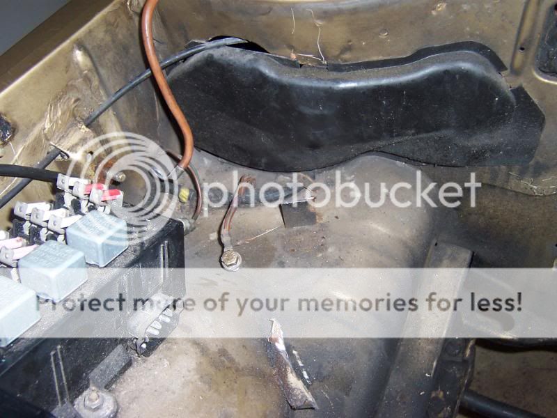

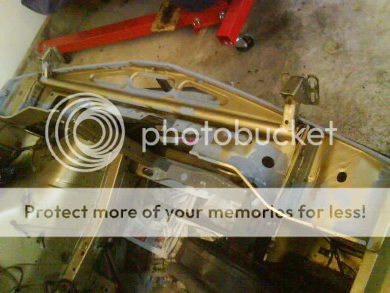

Been down again today for a spot of tidy'in up. Here's the engine bay before elbow grease (and masses of gunk)
The pics look better than it was. Some of it was like half an inch of sticky oil shit.
Afterwards (shit phone pics)
Did a bit of wire wheeling on the tat and primered it up. Think im gonna spray the whole of the engine bay and the underside of the bonnet now the compressor is up and running.
The old girls looking a tad sorry for herself now

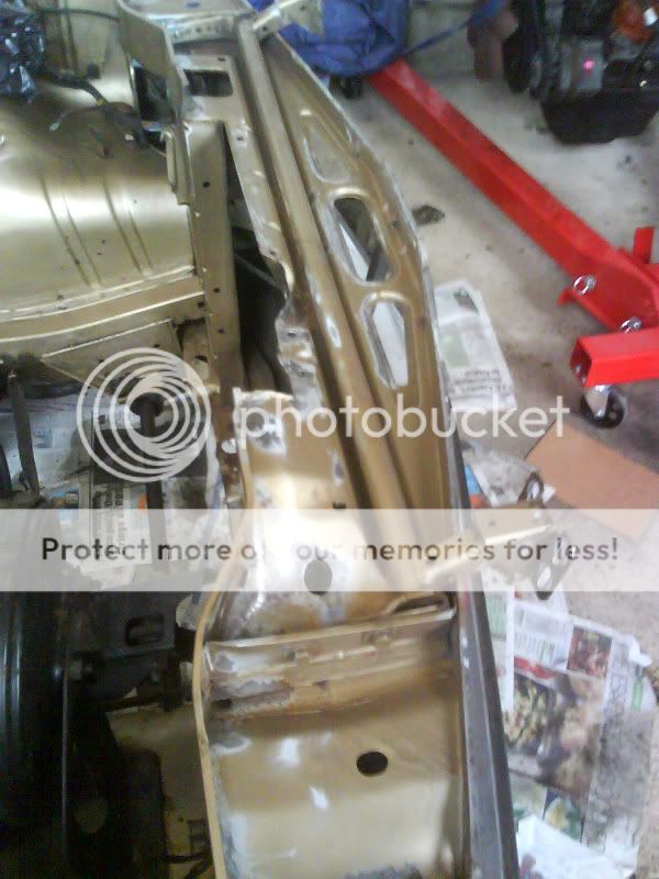

Hey Murran, do you have a welder at all ? Found a nasty crack in the chassis rail just infront of the left engine mount. Its been in an accident at some point and its not a nice thing to have found. Could do with maybe welding a patch over it ?

At risk of being called a git, I'll point out that you have a welder yourself!
Roll of gasless wire or a disposable cylinder from machine mart should sort out one patch.
