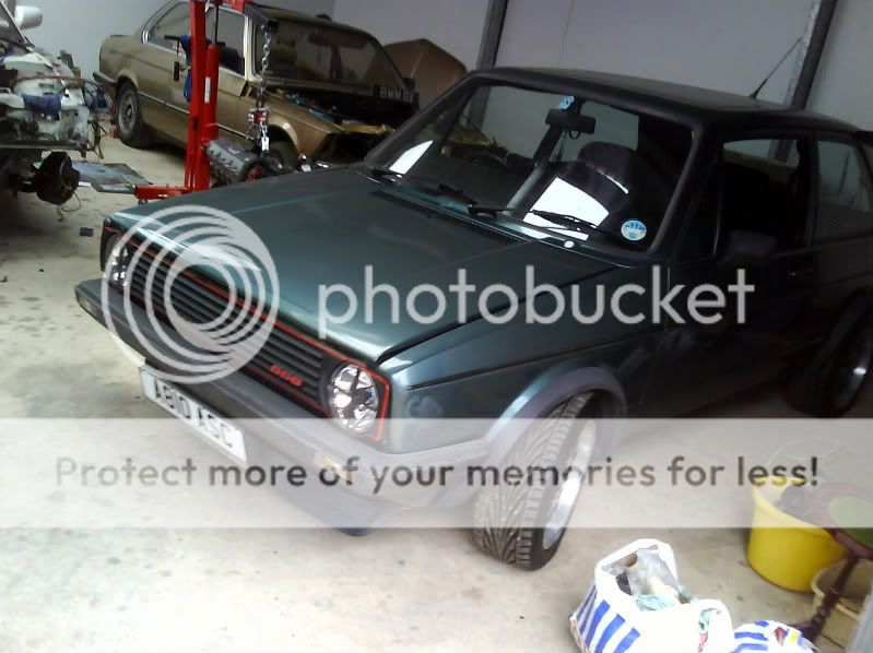

And most of the day was taken up by getting the new member into the Fantasy Factory
Has a 1.8 supercharged Corrado engine in. Just needs bolting back together and tidying up and it'll be a nice little weapon indeed!
