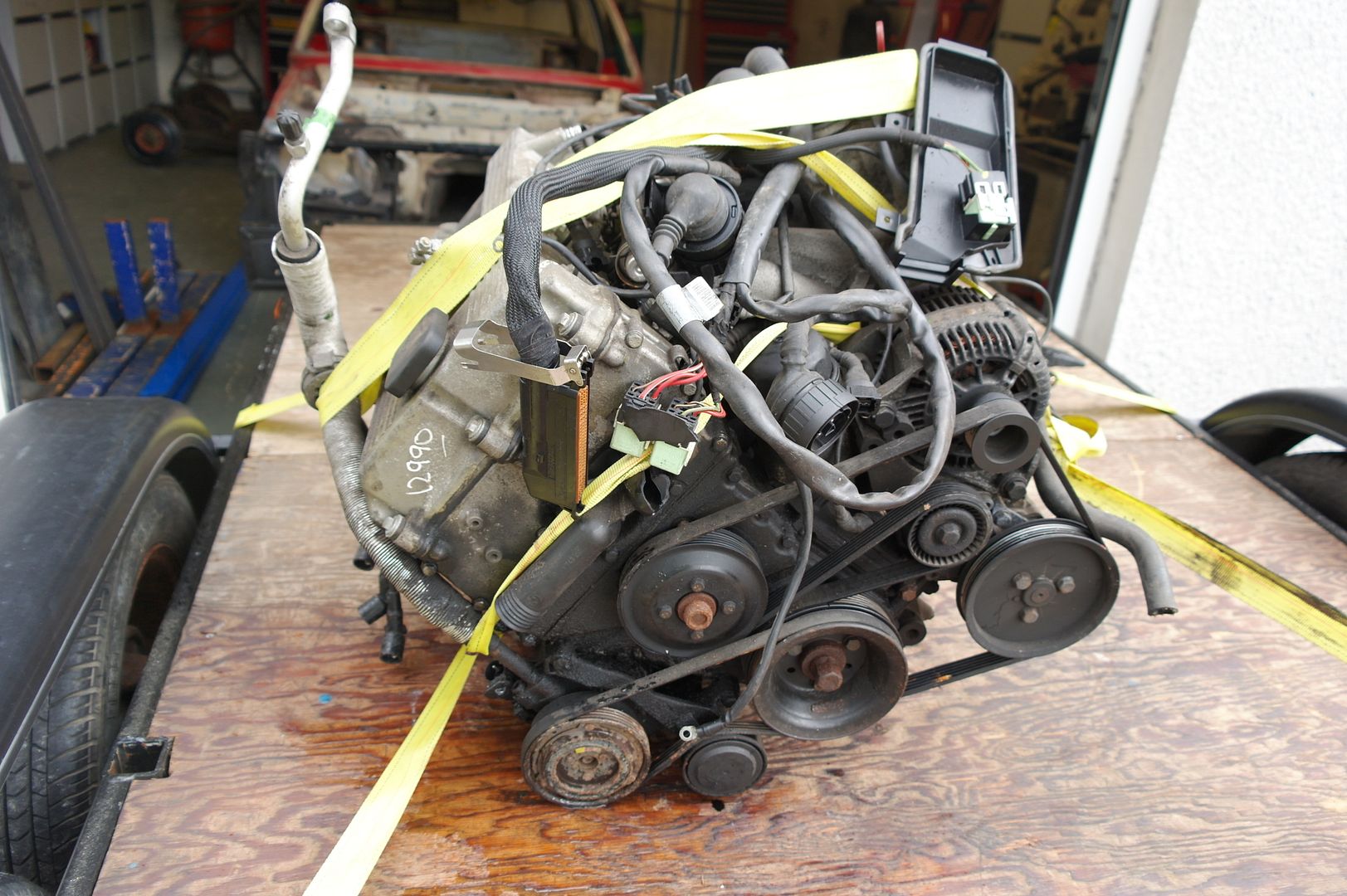

What's the plan for the engine? I've not had experience of the M42/44 engines, are they based on cut down M50 dimensions and bell housing pattern?

As far as I have seen so far they are just a cut down m52/s52, so I will be robbing a lot of valve train stuff from them if possible to build a 2/3rd s52/54 engine.polov8 wrote:Trailer came out well.
Been looking at gearboxes, would like an m3/330i 6 speeder if budget allows, but failing that there is always the e30 318is getrag 240's which are cheaper, but implode at 300lb/ft, which is still more than enough.
more likely to be supercharged, i think, but really trying to resist the temptation to start chasing numbers. I set out to get 200hp n/a but if i fall short a few psi may be required.
