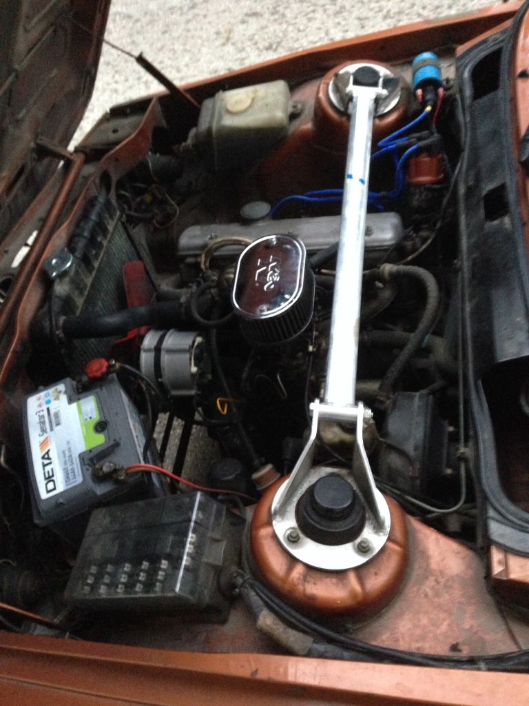

Re: 316 - 1977 - petroscf - Greece
A fresh photo of the engine bay with the new spark plug cables:
In nice blue colour, too!
