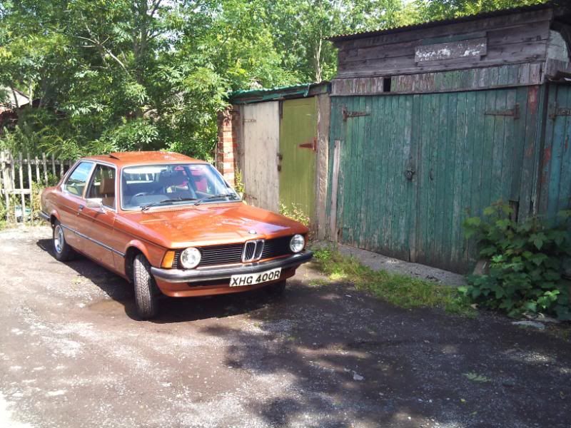

I brought this car back to life after it was stored for a very long time. Alan (creedon) told me had sold it on.
This was the last picture I took of it. Parked outside the garage when it was left to rot away.
Keep up the good work.
Alan.

Alan wrote:Great car this.
Brilliant to see its getting the attention it deserves.
Alan.
Fantastic stuff mate, I love to know about the history of the car, when was that photo taken, if you don't mind me asking?

Hi Eddie.
The picture was taken just before I sold it to Alan (creedon) a few summers ago. The garage in the back ground was where I first saw the car looking rather sorry for itself. I had to buy it. Have a look at my post from a few years back. Theres a 'story so far' which should tell you most. I have no probs telling you anything about the car. Its great to see it again and your progress.
