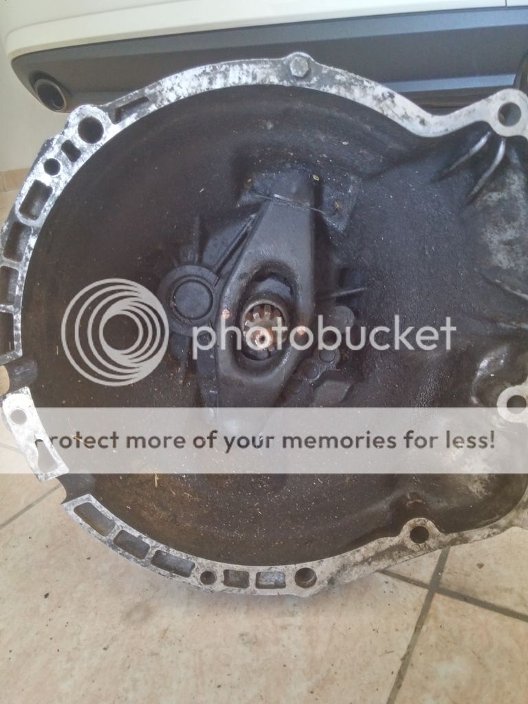

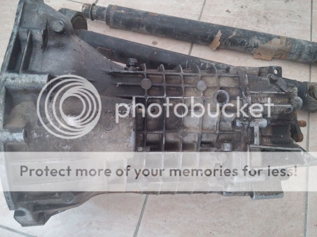

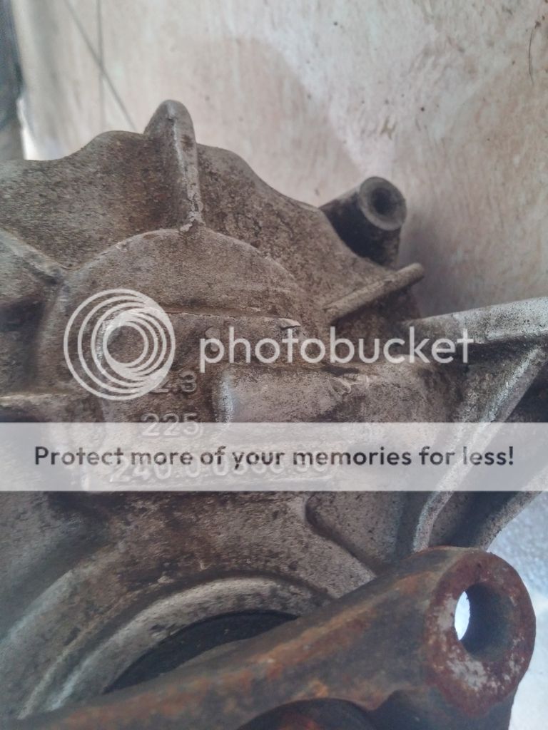

These are all the photos i took: http://s324.photobucket.com/user/Deleth ... how/Getrag
Numbers on the back
side
front
more numbers

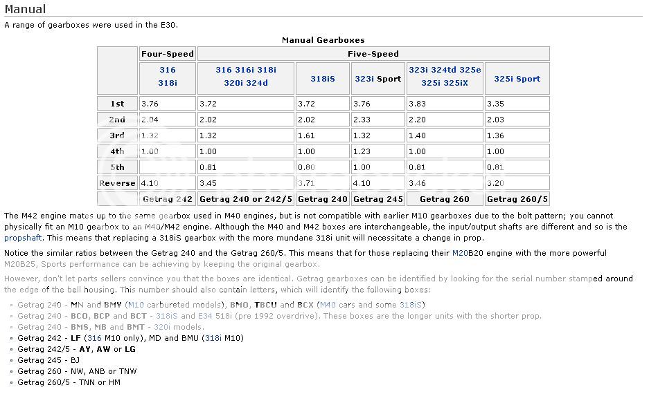

Appears to be a late model just like the 240.0.0266 we have in our own article. Give that a thorough read for all the details!
http://www.bmwe21.net/?page_id=124

Yes! indeed it's only one number different, 3 instead of 2!
Could it be this?
I am wondering, are gear ratios on this box the same as on the other ones?

It seems like this one. I really believe giorgo that you are a very lucky guy, now pray for it to be in good shape

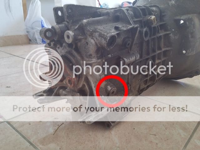

Could this be for the mechanical speedo?

Re: e21 differential
Post by E21noob »
Wrong side for the speedo.
Did you find any markings around the top of the bellhousing that include two letters?

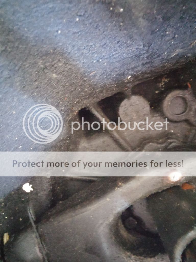

I have found inside the bellhousing two numbers: 1.1
Beware of the shark

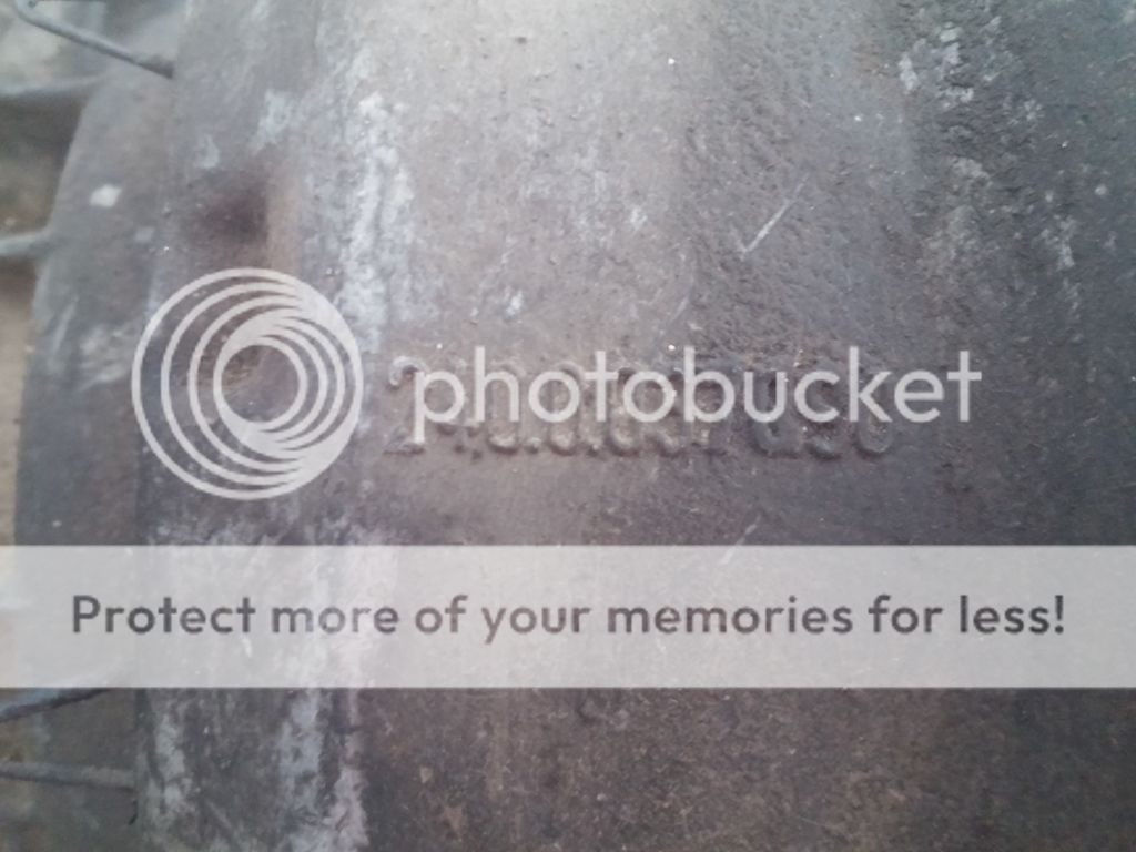

Not there. Just on the edge. Look at the photo I posted. You should find the letters ME or MF.
giorgio2g
Posts: 40
Joined: Wed May 31, 2017 9:47 pm
My E21(s): '81 315 5speed manual
Location: Hellas
Post by giorgio2g »
E21noob wrote:Not there. Just on the edge. Look at the photo I posted. You should find the letters ME or MF.
After removing a thick layer of dried motor oil, this came up.

And of course you can just push a long screwdriver through that pin and test out the gear pattern, see if that 5th really is there

The mystery is over mates, this is a Getrag 240, 5 speed manual gearbox from an e30.
Beware of the shark
Posts: 30216
Couldn't see a connection for the speedo drive on your pics. So this now means you have an argument with the seller?
