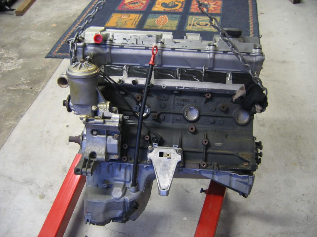

M50 has been progressing, found a non vanos e34 engine with 63.000km! Picked that up yesterday with loom, 328 tubular exh manifolds, alternator etc. Engine should be going in (and out) tomorrow to mark the sump and then start cutting it up for clearance!

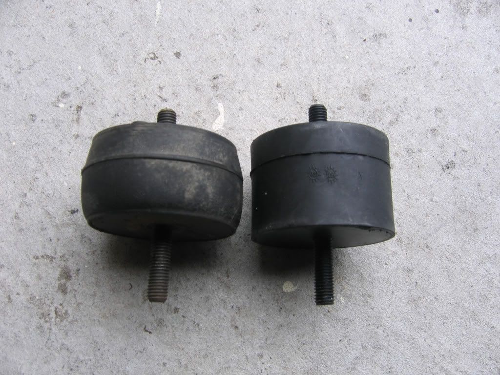

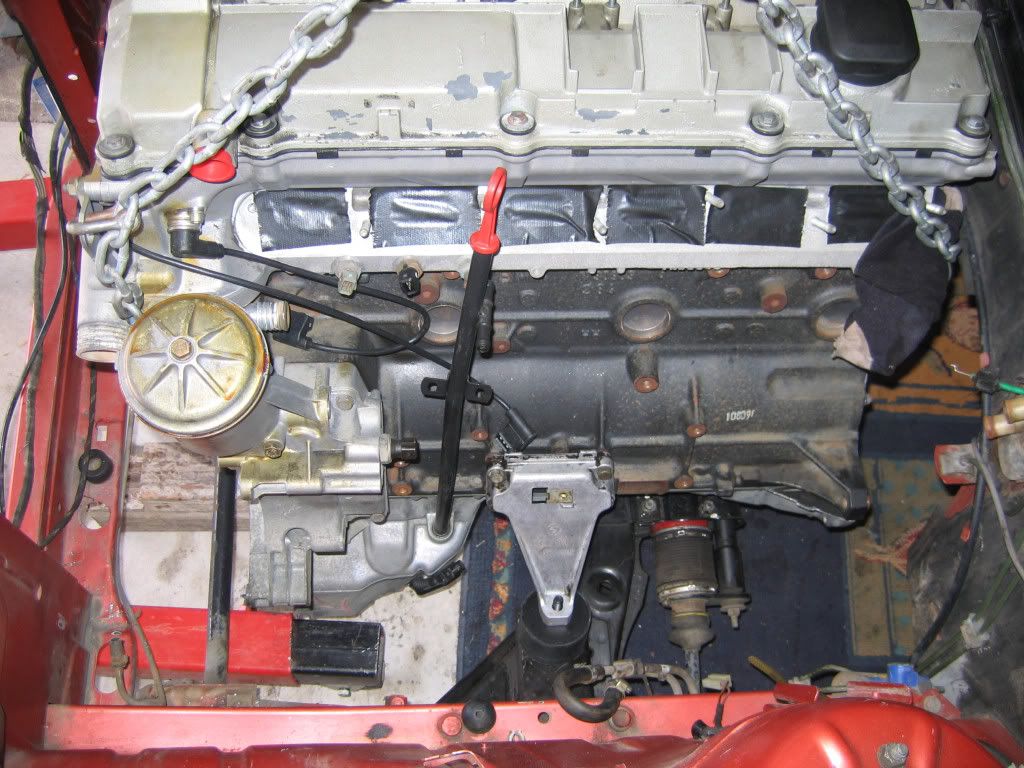

Got some more done on this. Engine is in, im quite happy with clearances to the booster etc. I used new e30 m20 rubber mounts which were at least 10mm taller than my 27yr old ones.
battery tray out
Old e21 m20 rubber mount, and new e30 m20 rubber
The sump clears the steering rack by about 15mm even with the cover and damper in place. Might trim some more clearance just in case.
The sump is now marked up, will pull the engine out tomorrow and start work on the exh manifold and check to see if the oil pickup pipe can be shortened at all.

jesus christ that sump is low!
out of interest what are the down points of actually making the sump a lot smaller by cutting a section of the bottom
less oil so overheats? (requires better cooling i guess)
less oil pressure? (wouldnt think so because pump is same?)
what your thoughts? there must be a reason for making sumps so big

I started on the two more challenging jobs. Routing the exh manifold turned out to be easier than expected, just ran it as close to the block as i could. The sump however is a little more tricky, i cant weld aluminium so had to send this off to be done. Should have it back in a few days. Going to add a wing on one side, right next to the pickup. Leaving some of the wall there with slots and holes machined into it to act as a baffle also.
Pickup is die cast ally so cant really be welded, most likely going to sleeve it and braze. Should have the sump back in a few days.

Pickup needs to be fully submerged at all times. Oil pressure is not related to capacity, however if you are pulling high rpm through a long left hander, and the pickup is dry you would essentially have zero oil pressure and would kill the motor! :shock:
My local circuit (Sandown) is anti clockwise, so lots of lefts! The new sump with wings on both sides, should have similar capacity to standard m50, and more than any m20. Also the wing on the RHS has a baffle too so hopefully it will be up for some track duty, if im brave enough.

I am doing the same engine conversion on my e21, only it is a m52 engine. From your pictures it seems like you are using the m20 engine mounts (the alu brackets). I tried this too, but it resulted in several problems. The sump is way too low (as you found out) The intake boot (where the air mass meter hook up) will hit the shock tower, and the engine sits at a wrong angle in the engine compartment.
The engine should be more "tilted" over to right side of the car. That means that the left engine mount should be higher and the right engine mount should be lower. The engine will then sit at the right angle. I am making custom engine mounts for my engine now, and I do not need to cut anything off my sump. My sump is at the same height as it was with my m20 engine.
