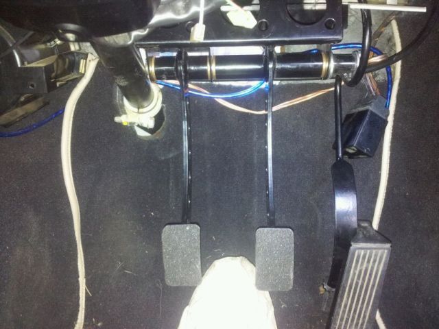

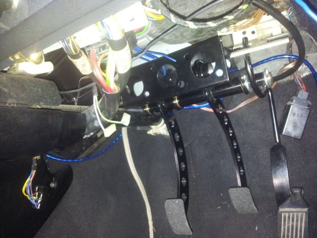

Well I took my old pedal box out... And plonked / jammed the new one in.. Access to it seems ok..

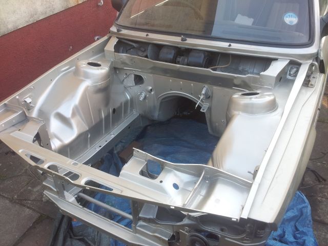

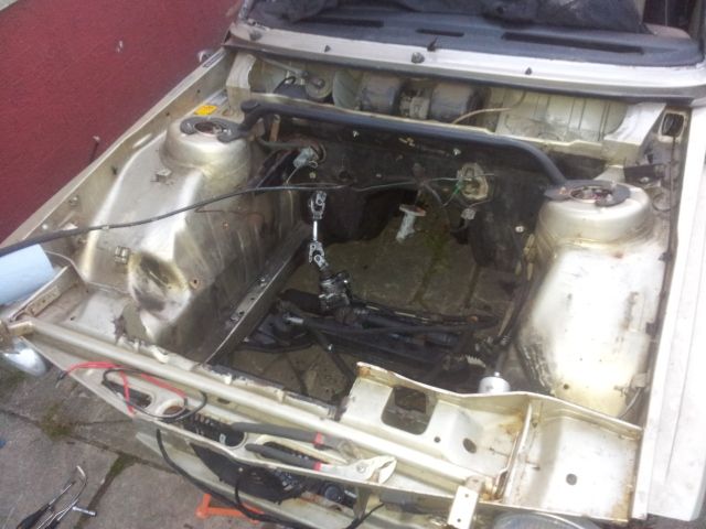

Cut some brackets off. Welded up holes and fresh paint.
Before
After

Nothing like a fresh bit of paint
Re: 316 beige uk
Nice.
Re: 316 beige uk
Certainly does make a big difference..
The new paint is lighter then the old and needs to age a bit. So this means ill have to do under the bonnet too so it matches.
Not going to be fitting the sound insulation on the bulk head. Hopefully it won't be too loud. Just like how it looks with no tired old insulation.
