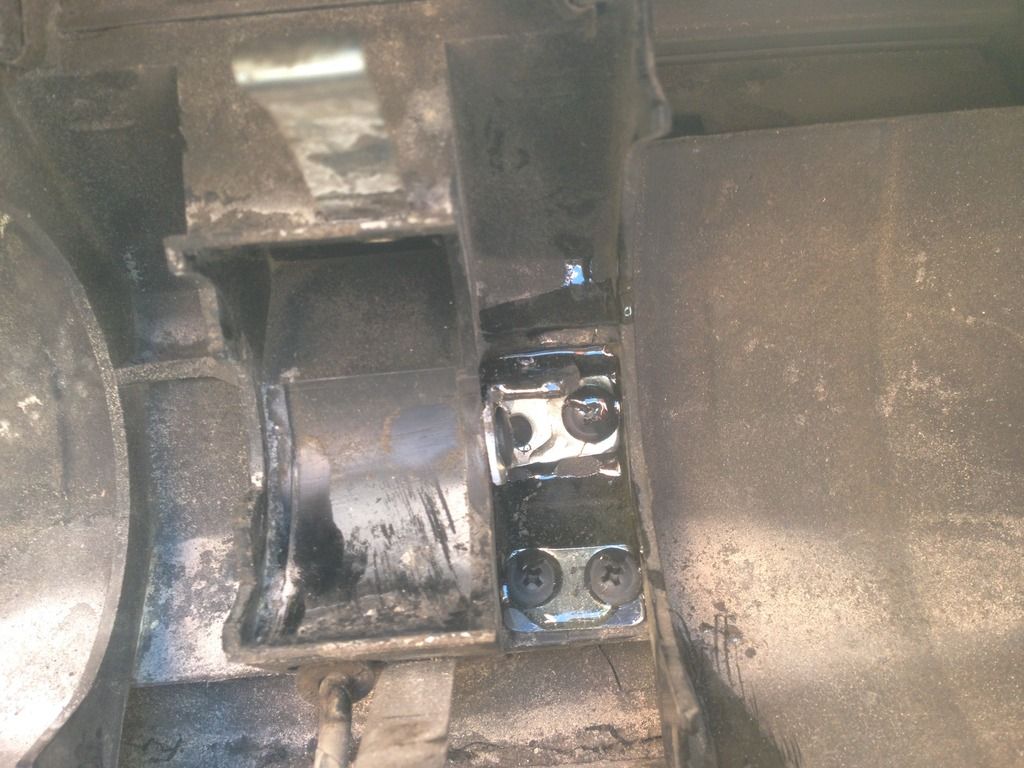

The mechanic repaired the cracking locally.
I do hope this lasts some time, in the meantime I am looking for a NOS heating system, or for a used part in good condition

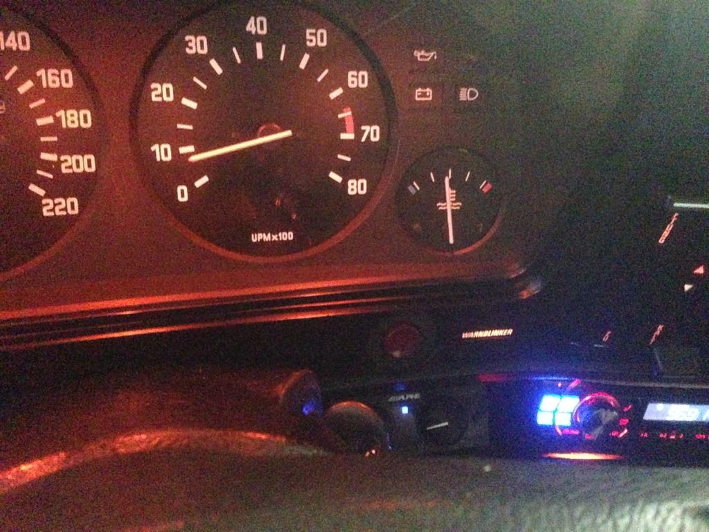

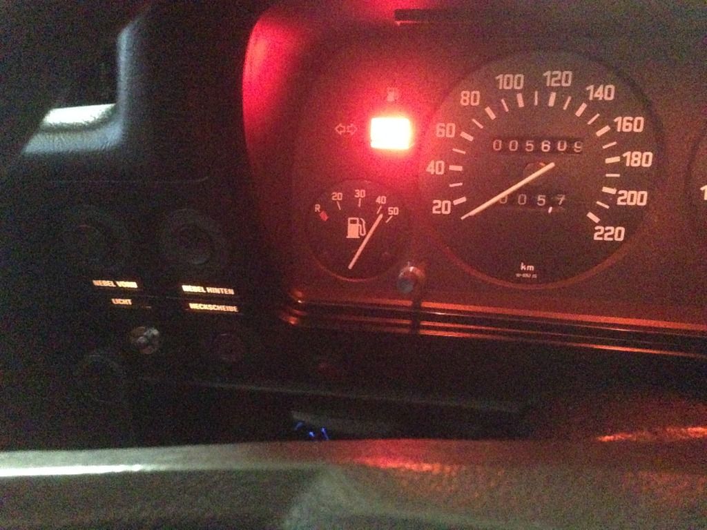

First impression was very good though: THE NASTY NOISE SEEMS TO HAVE VANISHED! AFTER 15++ YEARS!
Just had the chance to check this from garage to home, but I drove through parts where I have been used to listen to this, I it had just vanished. The car feeling now way smoother than before.
Also after yesterday my dash is 100% illuminated :
The plaquette came from Walloth&Nesch without any orange filter cover so we had to custom fit something, and the result is that it could be a bit darker or more red, but this is the easy part - we can always change the colour

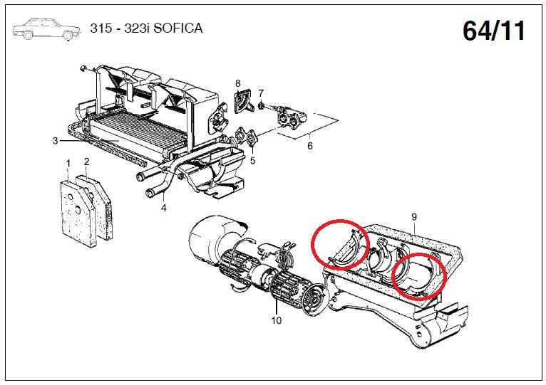

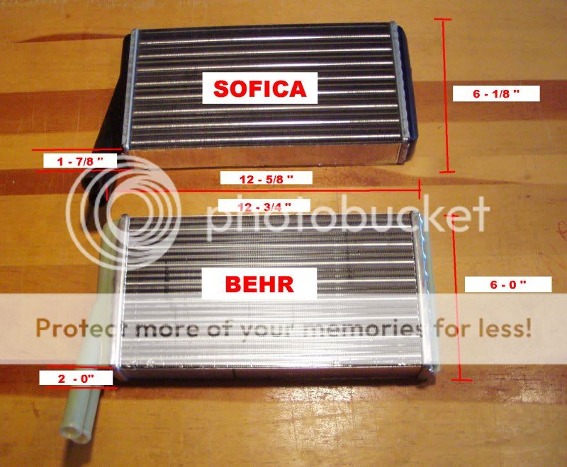

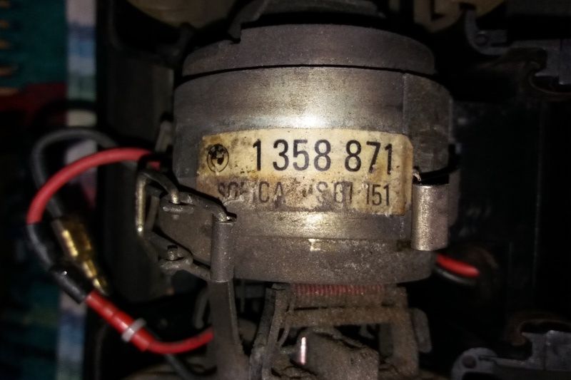

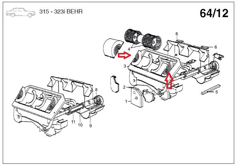

Can anyone tell if this is the BEHR or the SOFICA unit?
In order to know what I should be looking for

e-einundzwanzig
Posts: 889
My E21(s): '82 318i manual
Re: 316 - 1977 - petroscf - Greece
Post by e-einundzwanzig »
Have you tried to find an inscription/type plate/sticker anything on the casing or on the motor itself?
Google also came up with a number of threads/pics on how to tell the two apart...

petroscf
Posts: 1478
My E21(s): '77 EU 316 manual
Location: ATHENS-GREECE
Post by petroscf »
Thank you mate
I have a suspicion it is the Behr, if the catalogues (the sketches showing all parts) from BMW are absolutely exact, as there is a difference between the Sofica and the Behr, and mine seems to have a closer resemblance to the Behr sketch.
I have sent an email to W+N and hope for a helpful answer even though they don't have the part (only currently I hope)
Although the locally repaired system might go for many years without having any more problems, I would not like to leave it as is, but ideally I would find a nos one and store it for the future

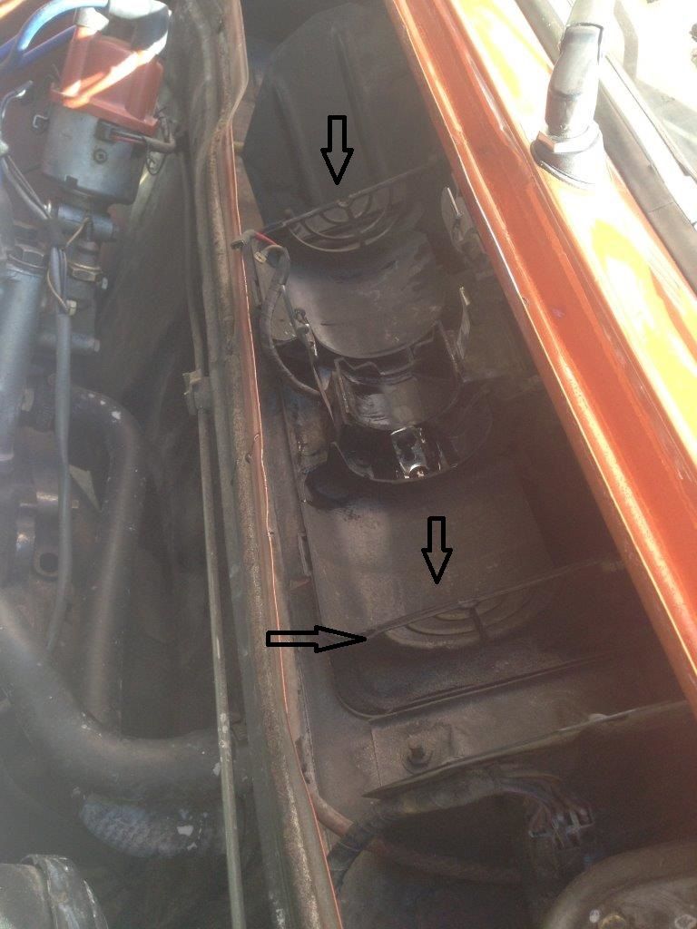

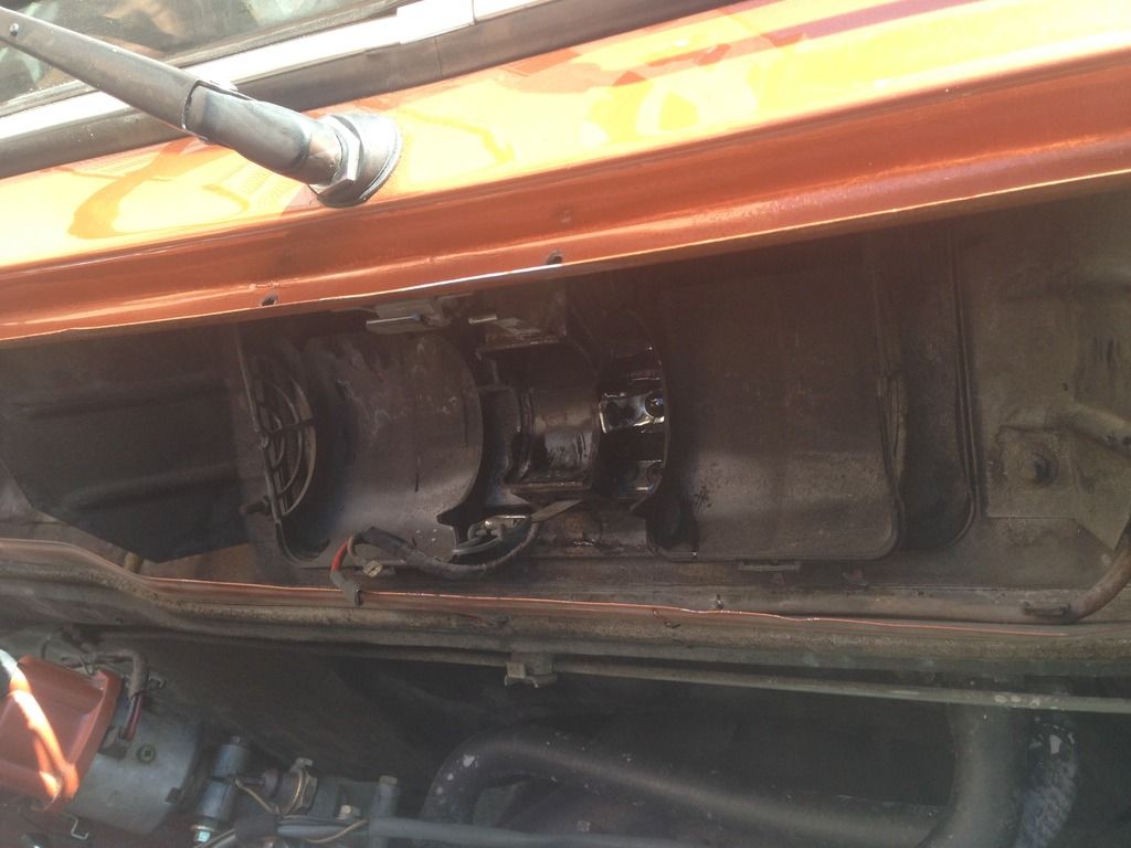

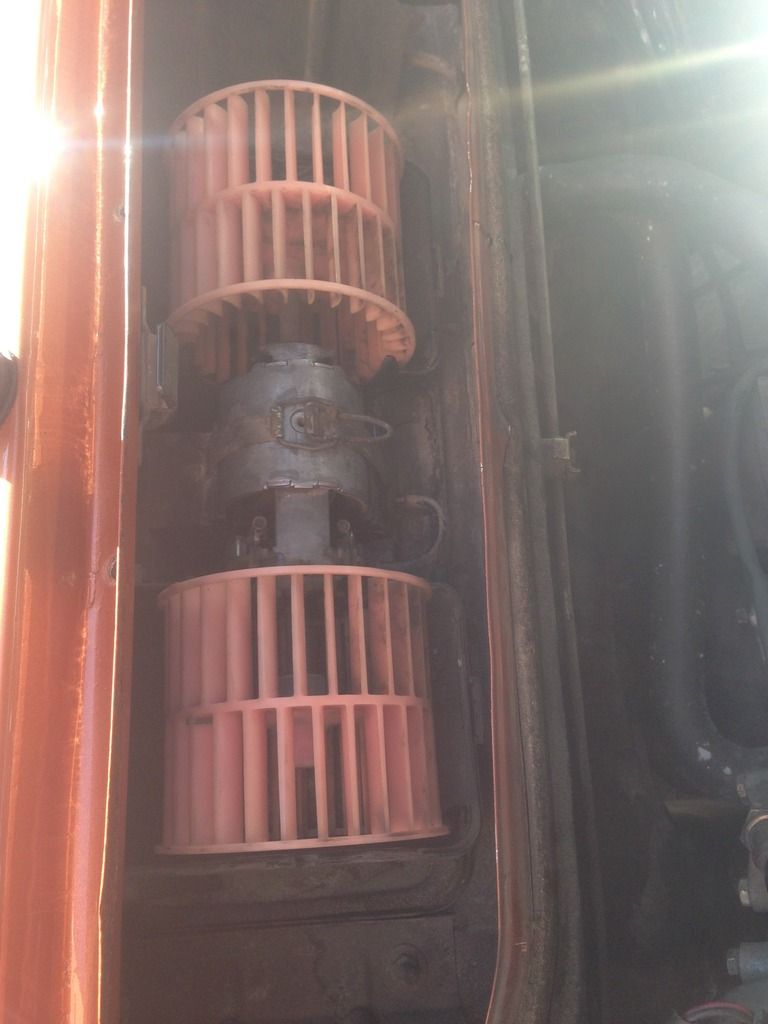

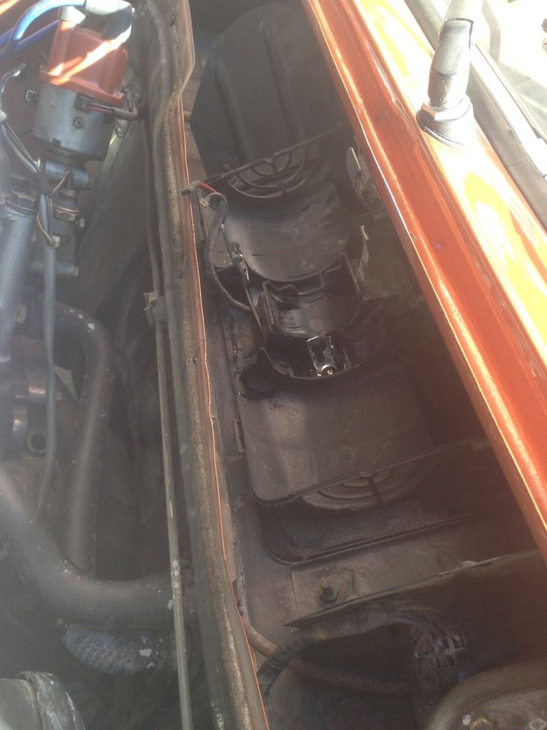

The cracking was found on the black box
We started opening/removing parts from the engine bay side, so we did not reach the heater itself
(although we might probably have to, as there is a heating issue as well, which may not have anything to do with the cracking.)
W+N were immediate in their reply, I must admit.
I have a suspicion it might be the Behr, because of a such resemblance, if you have a look at the following photos:
Of course this resemblance is depended on how exact these sketches are.
However, they (W+N) replied that they can't tell by the photo and that the brand sign can be seen on the black box from the inside (which means that at least the console if not the whole dash has to be removed)
:wtf

Posts: 19262
I am sure that there are a couple of complete units available, used condition, here in the Netherlands.
So if you take out the center console, you must be able to see the marque. If you have that, it will be found over here and shipped, I think. Just place an add in the Dutch marktkraam topic.
Posts: 19262

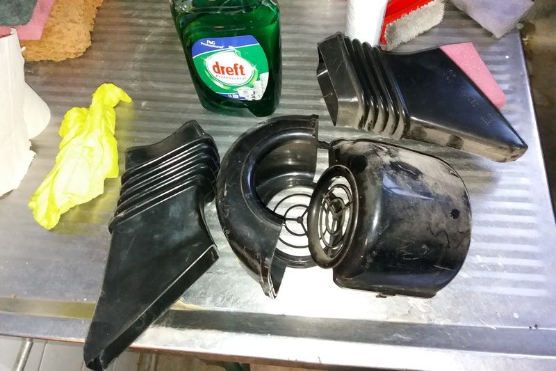

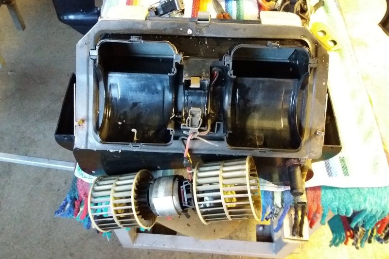

Here is mine, which is a Sofica
uwbuurman wrote:Then it was time for the heater. What a dirty part that was.
Full of little seeds and leafs.
Small parts cleaned.
The type of blower I have, Sofica. They used different types over the years.
petroscf
Posts: 1478
Post by petroscf »
Wow! what a work done
Thanks for these pics, I have now one more clue to believe that mine is from Behr, as your pics verify my showings in these sketches
Even better of course if someone can also post a Behr unit
/oo=00=oo\
E21 Forever
