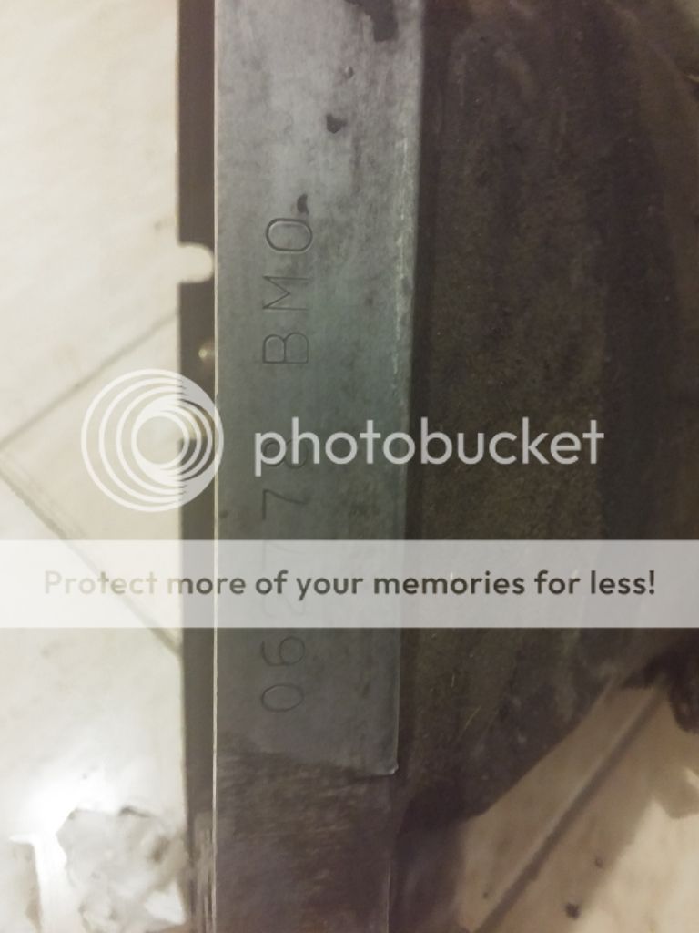

giorgio2g wrote:
E21noob wrote:Not there. Just on the edge. Look at the photo I posted. You should find the letters ME or MF.
After removing a thick layer of dried motor oil, this came up.
Thats the right marking.
https://www.etkbmw.com/bmw/en/parts/inf ... 3001220986
E30 m40 engine.
Wont fit your m10.
Sorry for the dissappointment.
If you get seller to show these marking we can confirm m10 fitment.

So if i have a picture of the markings on the top of the bellhousing, that is enough to identify the gearbox type?

giorgio2g wrote:So if i have a picture of the markings on the top of the bellhousing, that is enough to identify the gearbox type?
Yes.
But to be sure as many pics as possible.
