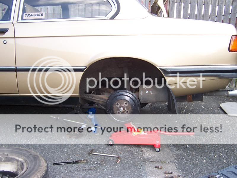

Nice write up of all blood, sweat and tears! Love your garage jack :mrgreen:
But that bump stop seems way too long to me.
Now over to the rear I presume? That's an easy one, 15 mins each side, just jack her up slightly and you can just grab the strut.

Whats that about my jack Jeroen ...... do i hear a slight ping of sarcasm ?? :D I have a sweet ratchet one that came with the car and a nice £15 shitter from Argos, they sure did the job!

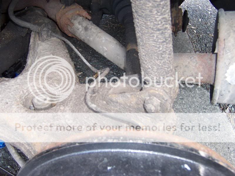

As for the ARB Wizor, i found that i had to take it all off to give me enough movement in the control arm so i could un-do the bolt that held it to the cross member. As i mentioned in the pic on the write up, i struggled to get either sides bolts out due to the steering parts being in the way. I put those bolts back in backwards so i could extract them from the front if needs be again. Taking ARB off was more hassle yes, but it did the job

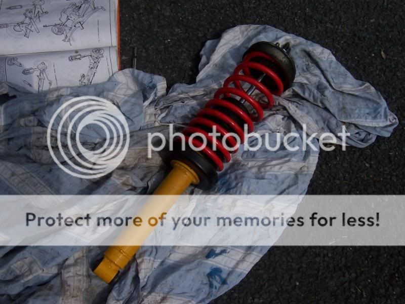

Well, Wednesday us upon us and work once again begins. Good news is ive managed to get it finished this avo. Took me around 2 hours which im quite happy with considering my caveman style tools. Have'nt tested it yet as its time for some food! Plus i need to sort the brakes out which have gone shit. Here's some more pics for y'all bitches
Lovely pic of my jacks here just for you Jeroen
Very simple stuff, i was suprised
Again, old and new
Et Voila
Happy days !

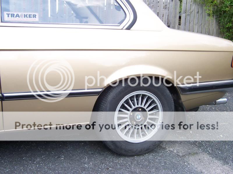

Once more.....the results, which i must say im very chuffed with (as long as it does'nt come apart when im driving it)
Thanks again to everyone for the help, im glad i decided to take the task on myself. Its saved me a few quid and given me some good knowledge of the car. Cheers!

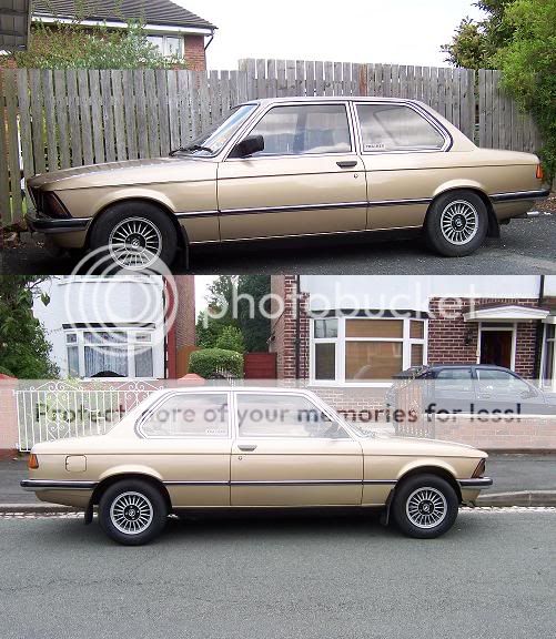

Just thought id throw in a before and after shot, although in this pic its after then before

No it looks da BOL-OX...LOOOL, need some 15" alpinas matey or BBS deeeeeeeeeeeeeep dish.... then all is sweet!!

Nice job, car looks more purposeful now and some 15"ers will finish it off. Have you checked out the Lenzo replica's which do BBS's lookalike. Not sure on quality or weight but they do look good. Google (lenso retro) . BSX in Black would look the Dogs b....ks on your car 8)

Took a quick drive earlier but just kept it slow to check things out. The brakes are still playing up after bleeding them so think its time to get the new calipers on. Cant really give it a proper test till their sorted.
I had all the shocks on the softest setting and it appeared slighty stiffer than the stock setup. Was deffo no where near as much roll in tight corners. The kit cost me around 350, bump stops and dust shields were 30, so got a nice setup for under 400 quid which i dont thinks too bad at all. Took me around 11 hours to get it all on, but i could easily half that if i were to attempt it again. Feels very strange to drive with the drop but i like it. Will prob take it to the garage to get the tracking sorted on the weekend
