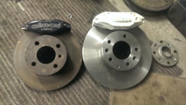

side by side comparison - still waiting on the rear disks and pads to show up. on the rx7 you get rear vented disks as well and ill need to make brackets for the rear calipers.

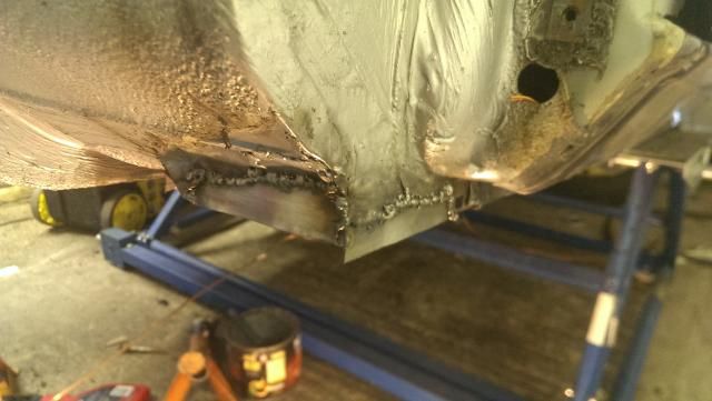

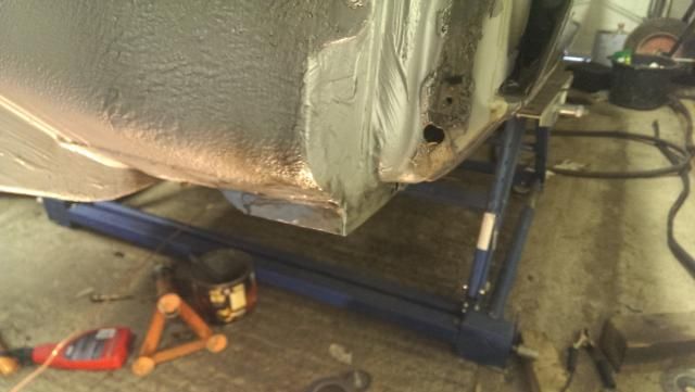

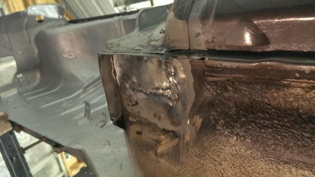

I did some welding on this corner because jacking point rust trap. not sure if I should put the plate back on as from now on no one jacks this car up from the sills.. only subframes! :hammer

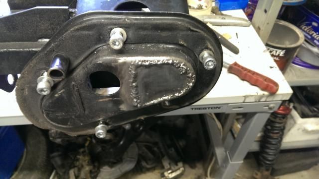

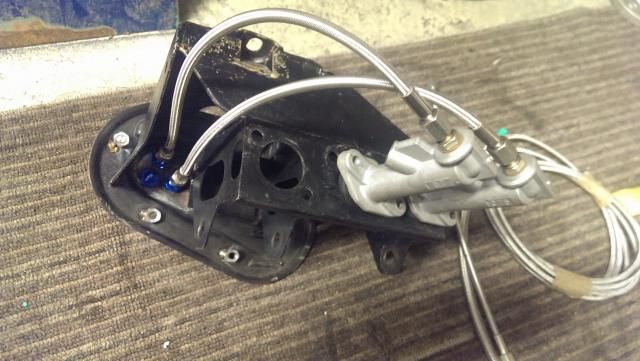

then I welded up my pedal box, because the holes here are not needed now... im no expert welder but im getting better everytime I do some. once I grind em down the welding looks much better :p
filled in the other hole didn't get the new bit level so you can see where I have been, so I will have to skim with filler, which isn't a problem really,

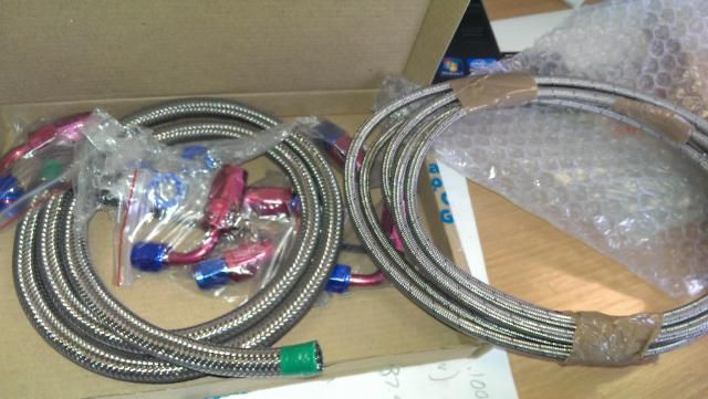

some stuff arrived

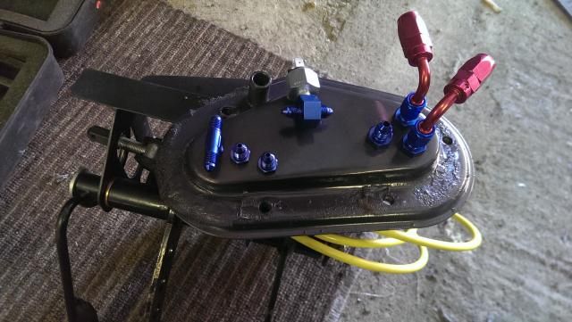

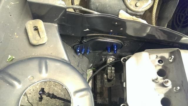

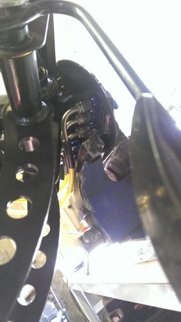

theres a limited amount of room on the other side. but theres just about enough to squeeze these bulkhead fittings in. ive got some remote reservoirs to fit in the engine bay but im probably not going to finalise the placement until later as i cant remember how much room is left on the bulkhead when the bonnet is shut
this week, disks are getting redrilled and the brake brackets will be made (ive done the template for the front already) then ill test fit the bias box and make some brake lines up . finish painting underneath the car and then fit the engine and box in.

Top work my man, I would of approached the pedal box the same way, if you want to keep a bit of an oem look use 2/3 clutch reservoirs I think the cap with the fluid sensor for the brake reservoir should swap over

I've been welding up that "jacking" point on mine this week, came to the same conclusion, the plate stays off and I'll use the subframe for lifting. Great thread btw! :thumbsup
Andd yes, the level sensor cap fits, I've used BMW clutch reservoirs on VW's a few times.

I got those universal girling ones with the an4 screw fittings. They are on the big side. But ill change them for cool billet ones when i save up some cash.

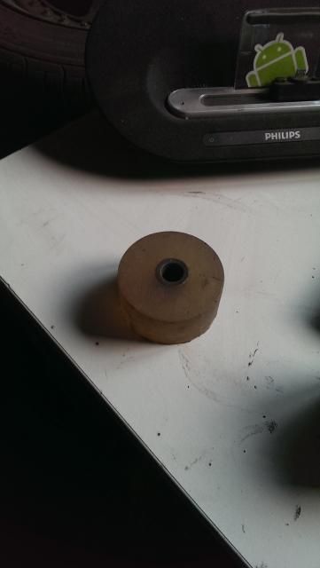

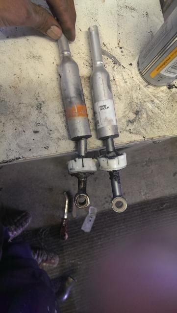

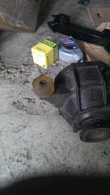

started out making a bush for my diff mount.
used an insert from another bush and just cut it down
thatll do it

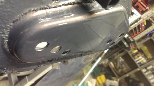

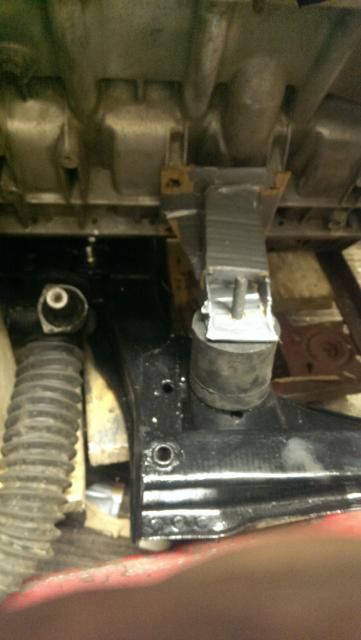

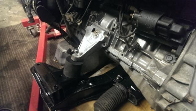

next issue was that the engine mounts from the e36 dont work like they do on e30s lol. which is a shame so with a little help from Propan (thanks!) he suggested i use the m20 mount on the intake side and then create a new mount on the exhaust side.
cue the blue peter music!!

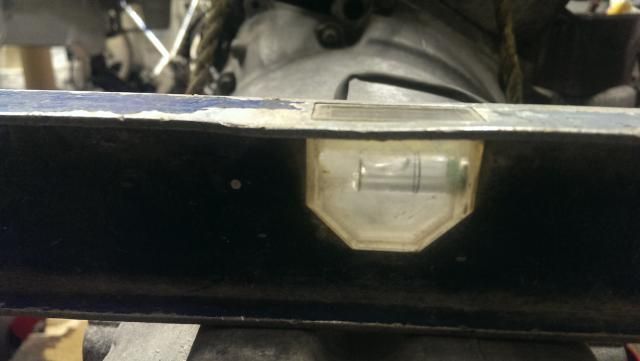

get your engine in position, measure measure measure, prop it up so it doesnt move using whatever you can find close to hand which your holding it with the other. measure again :)
i fine tuned the level but here it was at the first guess.

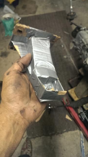

intake side

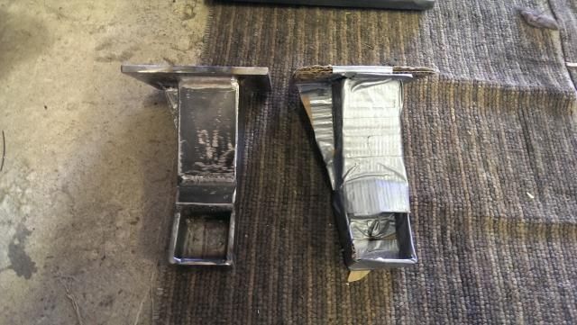

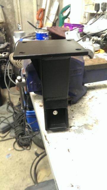

just cut cardboard and then stick it together and go like so

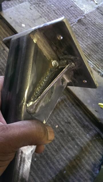

my welder is basic and cant do 6mm and 5mm steel so i gave it to Aidy (local mobile welder) and he spent an evening creating it for me.
exactamundo lol
wish i could make welds like his
zinc coated and then painted

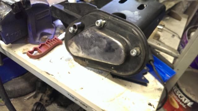

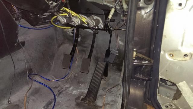

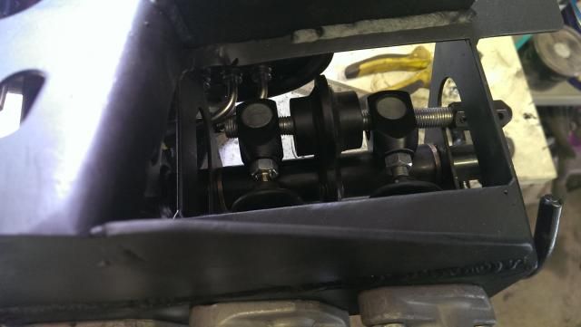

did some more on the pedal box
i cut the master rods down by about 10/15mm as the pedals were too high
bulkhead fittings er fitted

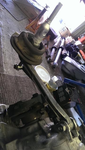

decided to fit a z3m quick shifter, its not too short and its better than the 328i lever but not stupid.
easy as pie to fit

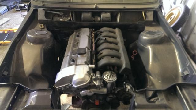

finally got the engine and box in. no trouble at all fitting it in. and it sits perfect. theres sooo much room either side.
had a test fit of the pedal box,
its gone in perfect although i still need to modify the accelerator pedal to work with my original one. bit of cutting and welding wont be a problem.

Nas
Before you put it all together permanently so to speak, check the bias bar is moving freely and that the cylinders release fully. I put a new rear circuit cylinder on the slug ages ago, but it was a different make to the original, even though I thought I'd cut the rod the same length it didn't properly release so the circuit just pumped up and locked the brakes up. Took a while to figure out, but no fun being unable to complete the sighting laps or get back up the hill to the paddock at Cadwell! Burning brakes on the track car is bearable, on your garage queen it'll be bad!

yeah I read that the pedal seems must retract all the way after you press the pedal, I think the clevis for the rear needs moving along to the right a few threads. have to get them exact so I still need to mess about, im still missing a few brake fittings..

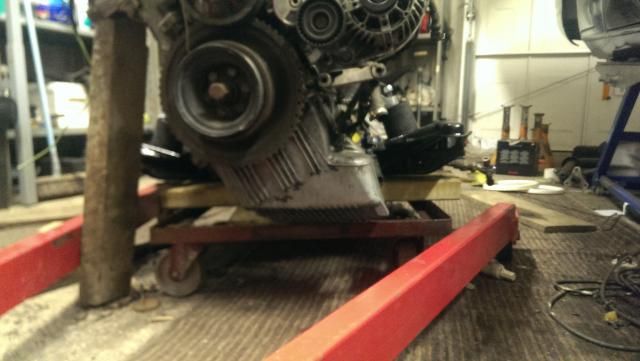

Having lowered my car to rough ride height . I don't think there's enough clearence for the sump.
It sits about an inch n a half / two inch below the subframe. Engine is coming back out. I'm going to get my sump modified.

I should have the modified sunp back by the weekend hopefully. Lucky I have a spare one! I didn't fancy taking the engine out tonight lol.
It needs roughly 1.5" taking off the bottom and I used my measuring jugs to work out that i will lose 800ml give or take. That means either side of the sump will require a 400ml wing. Easy for my alloy welder to do.

Nas, How are your mounting your diff bush?
If bolting through the diff and your new bush into the bodyshell, the poly will be doing nothing. It'll be like solid mounting.
This is the bush I used (No. 12).
Diff bolts to the centre of the bush and the body bolt to the outer ring.
