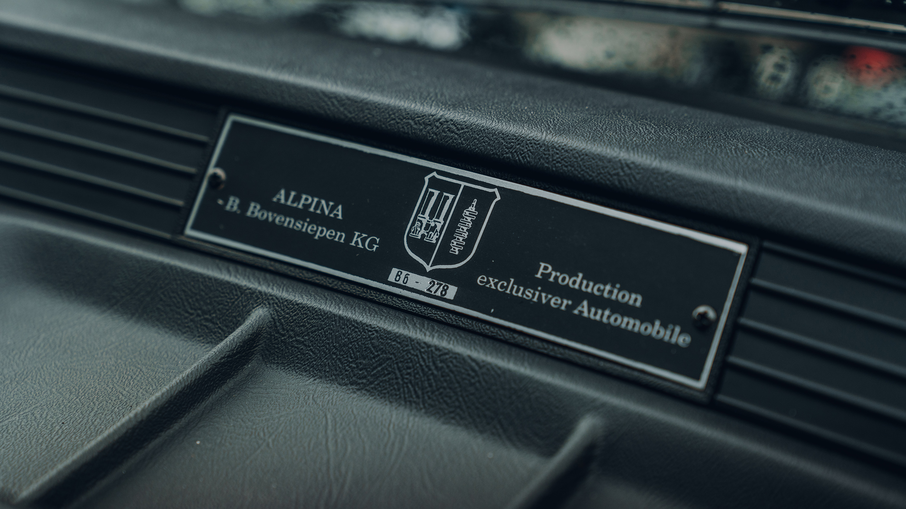

The C1's are always causing the most issues. Alpina did keep track of the production details of all B6's, but the C1's are a whole different story. Most of these were converted from 323i by local Alpina dealerships and many of these conversions were only partial and poorly recorded. So there is a chance Alpina has no details on the car at all, or can only provide a chassis or engine number. Apparently the car went straight to the UK, no documentation on a stop at Alpina, then it could be converted by Sytner at some point but with a pretty stamped service booklet I'd expect to find something about that in there.
The Alpina dash and engine bay plaques may be original, but the engraving isn't. It should say model and production number, for instance C1 - 244, see example below. Interior parts are limited to steering wheel and shift knob. As the C1's engine is based on the 323i's engine there's not much to see from the outside. A dyno test would be the easiest way to find out more about the engine.
I understand you are offering the car for sale at the moment but to be honest, at this point to me there is nothing that gives me the idea we're dealing with a C1 here, I'm sorry. On the other hand I have to compliment you on the condition of the car, and the extensive collection of high quality photos. Good luck with your sale.

I'm terribly sorry but i agree with Jeroen's conclusion. nice tidy 323i with Alpina "Optic"
the list on the archive is below:
https://www.alpina-archive.com/?cat=706
i couldn't make out the build number- also the chassis plate seems to have incorrect font .
