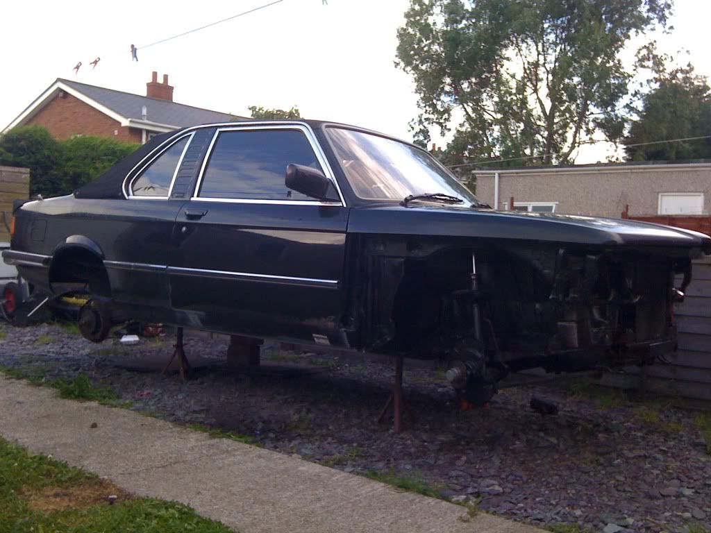

the e34 come up on the off chance and my imagination ran wild!! at the moment even the mot seems a long way off, but at least i have finish welding one side of the car now, (if you ignore the rusty door!!)
