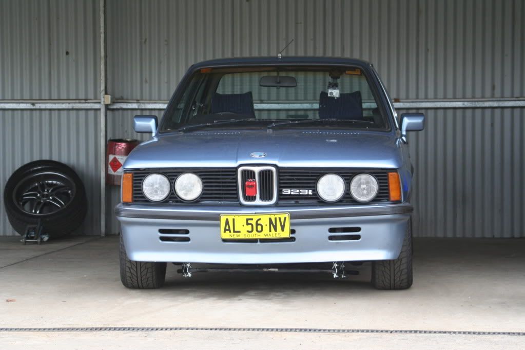

I put a second arb front and rear on the 323i and it made a bit of difference. There are a few things to watch out for. You can't just bolt on a second front as it will interfere with the tyres. I made up some brackets out of steel flat bar just to see if it worked. The next step was machined brackets, but I moved countries before we could get that far.
In the picture, you can see the brackets are not right out at the ends. We were adjusting them to see what would happen. It did make the car pretty tunable. I assume you have an LSD? If not, any stiffer rear arb will just spin the inside wheel.
IMHO 550lbs would be way too stiff. I know guys with full race prepped e12 535i's who don't run that. My track day 520i (1250 kg with me in it) only has 275 front and handles beautifully. 13s would make the car softer again.

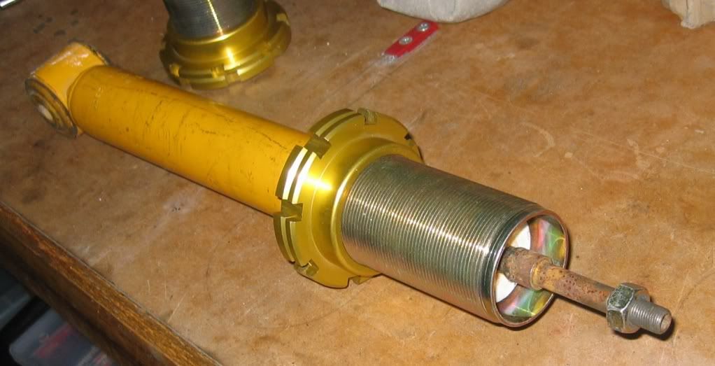

Make yourself a set of coil overs for the rears with some bilsteins. Then you can have best of both worlds. Here's mine but made with Konis.
