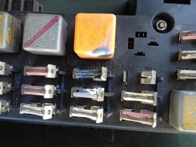

Ok so. I washed my car. And the heating doesnt work anymore. Checked the fuse to find this
I replaced the fuse. And still no luck. Any ideas?

Im sorry lads. I should have been clearer. The heater blower has stopped working. And the fuse in the middle thats blown says heater blower or something like that. I think my best bet is just to replace all fuses as a fresh start. But its soooo cold :(

Tbh I think you may want to check the heater fan itself.
I've never seen a fuse blow like that...

Ah damn. Im gona clean the terminals first to see if that does the trick. If not then ill have to some how full the fan out. Is it long procedur to take it out? Havent looked yet and think ill get an answer on here quicker
Posts: 30147
Re: Heating trouble
The fan can be reached easily under the black cover for the wiper mechanism. If the fuse blows big time like that it may have seen a lot of water or have seized. If it was squeeky before it will defo like some WD40. Better remove first for a good check then!

Yea it was squeaking like like a m***** f*****. Ha. I think water must have gone through. Black cover in the engine bay right? Sorry. Still trying to figure this cars layout.

All sorted. Attacked the blower with wd40 and cleaned it up and now works a treat. Thanks guys.
