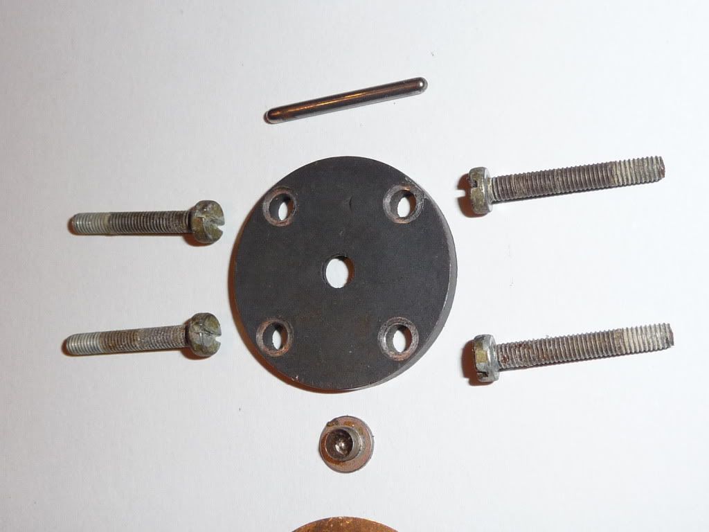

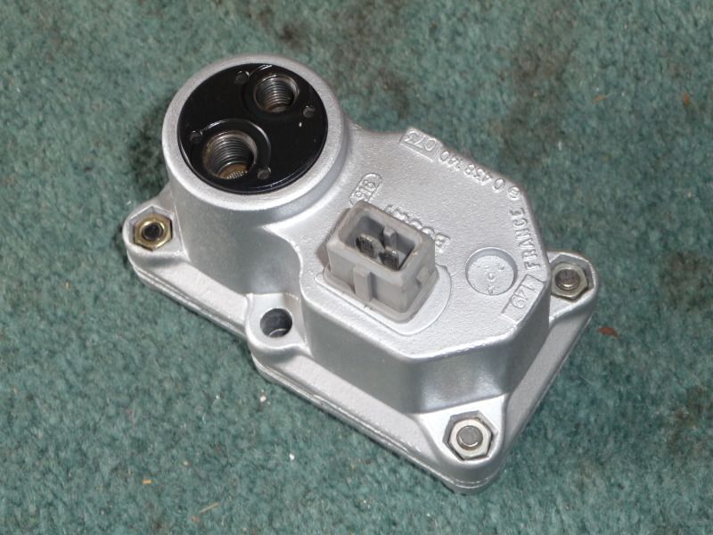

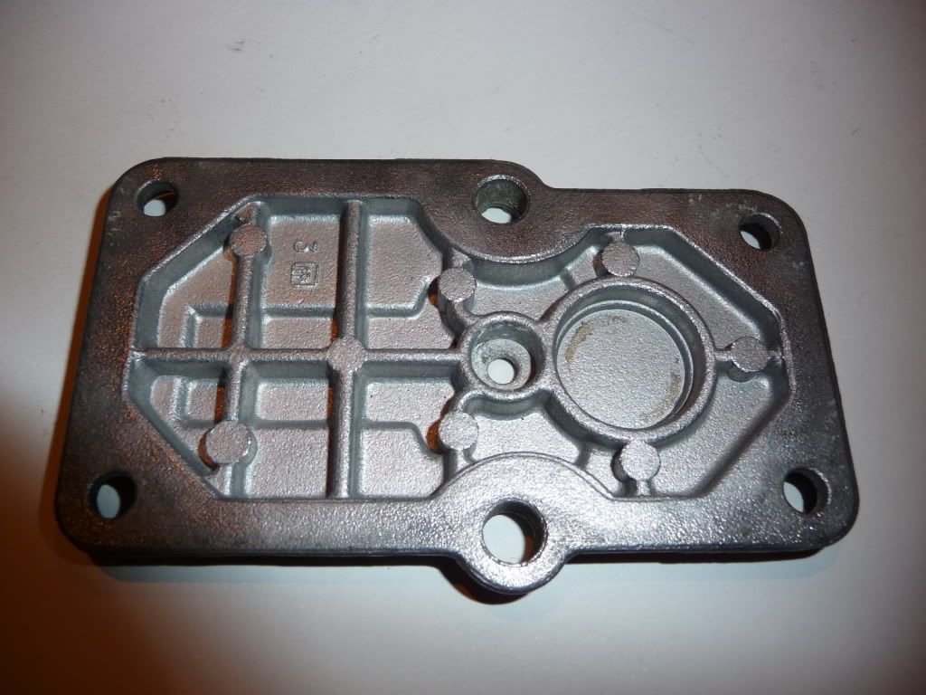

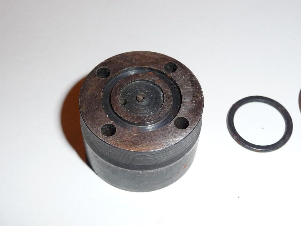

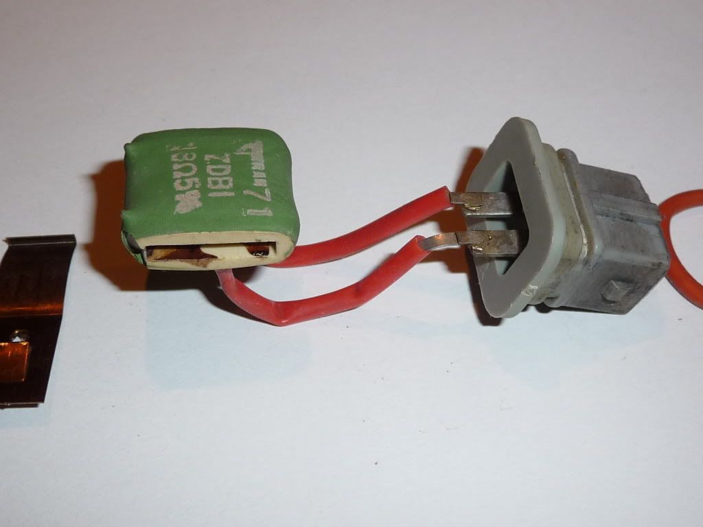

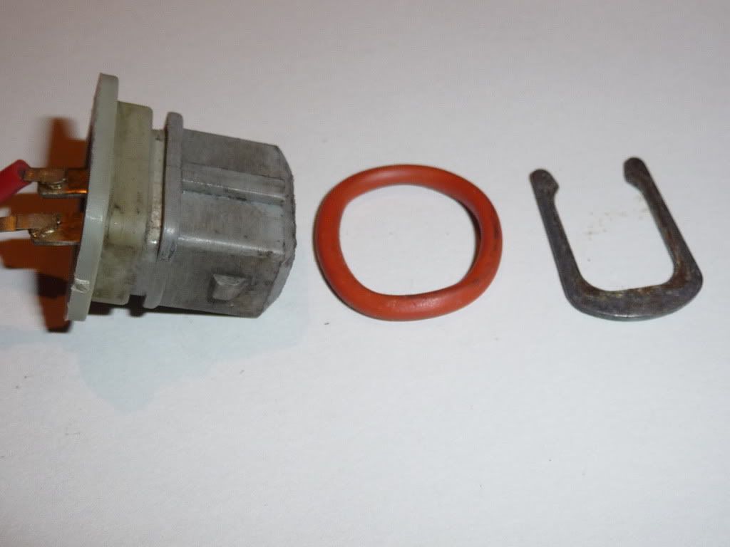

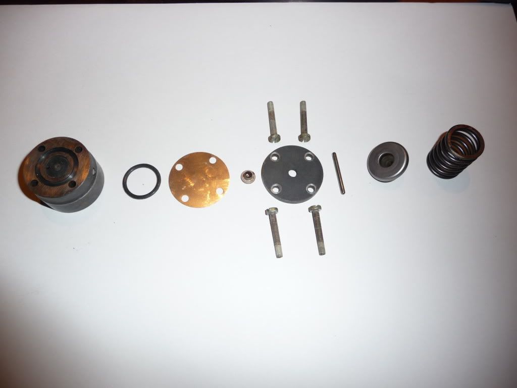

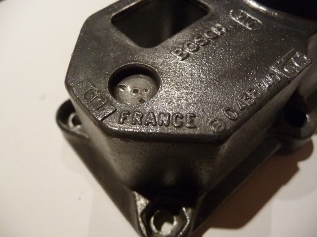

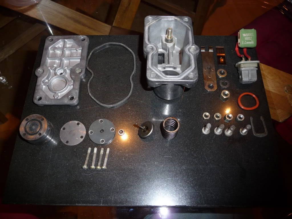

They're fairly easy to strip down and check, I did it with the one on my Golf GTI:
Took about 5 minutes to strip it down to its component bits:

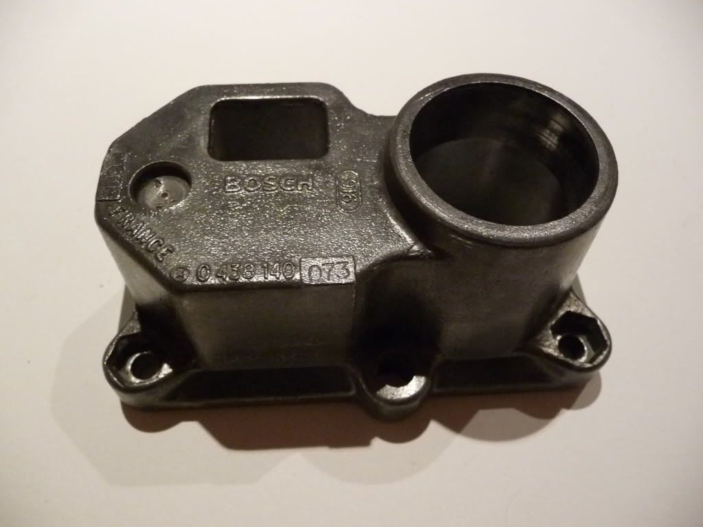

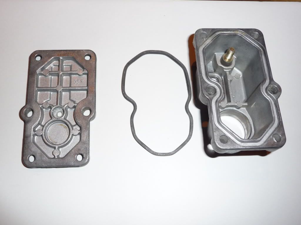

The casing and seal:

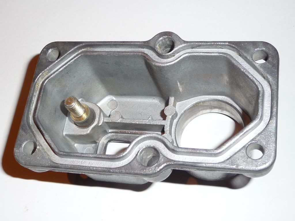

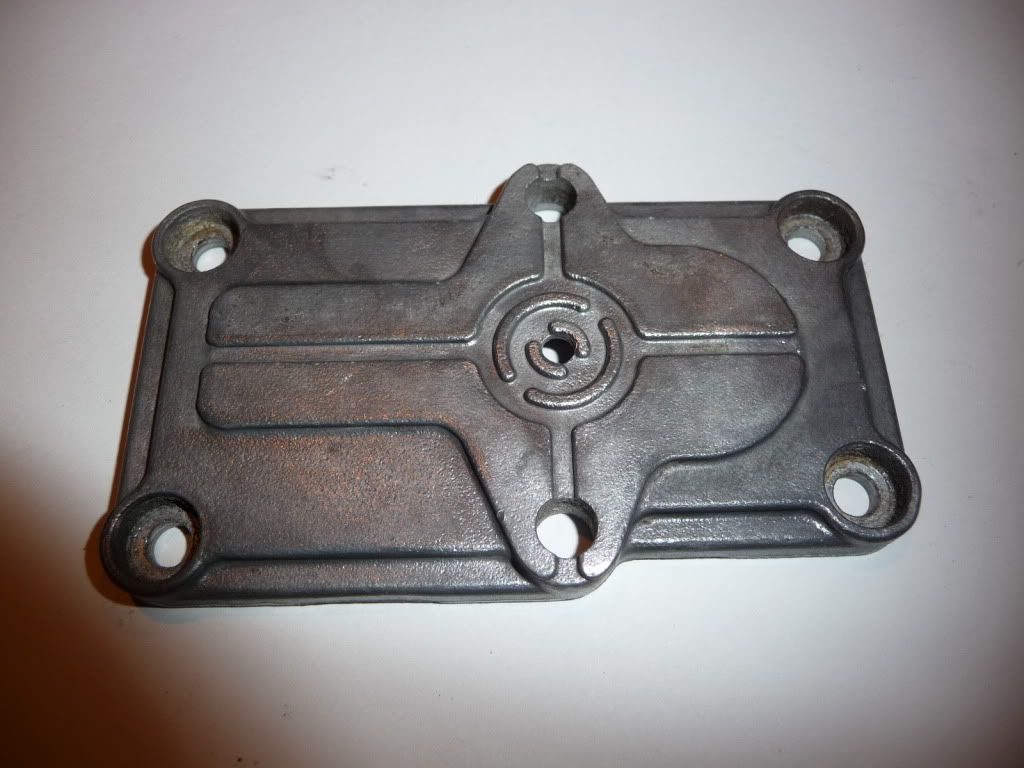

The feed and return pipes feed into this block, which has a diaphragm that's acted on by a fixed rate spring, but assisted by an electrically heated bi-metalic spring:
Regulator block:

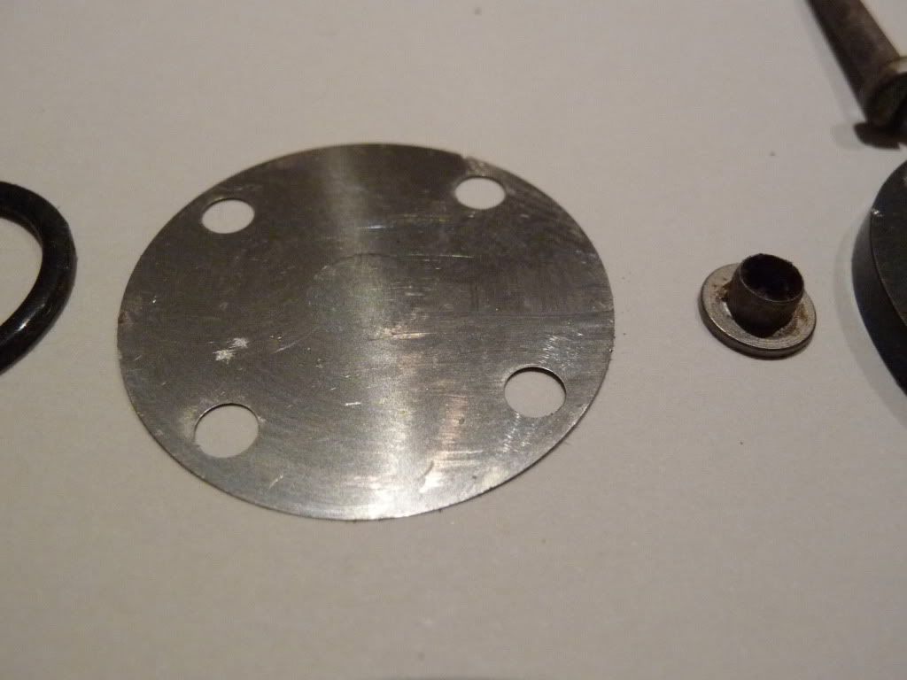

The diaphragm:
End cap:

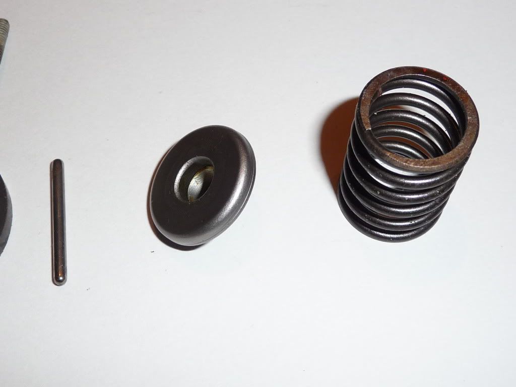

The spring and push rod:

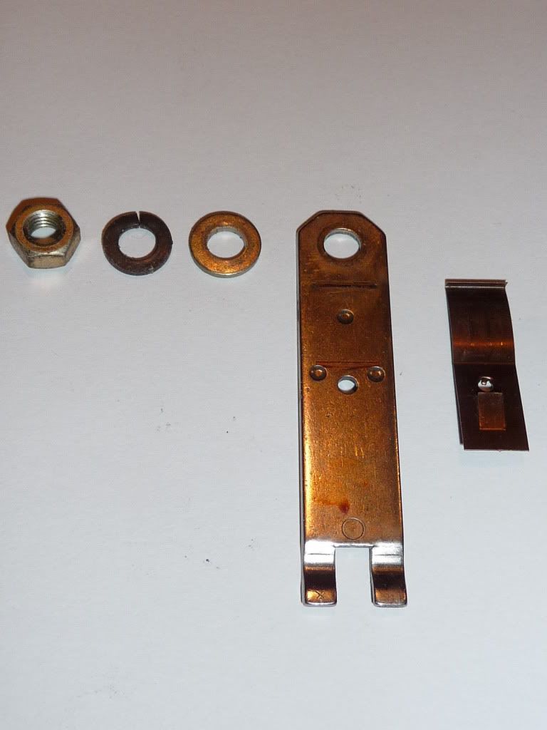

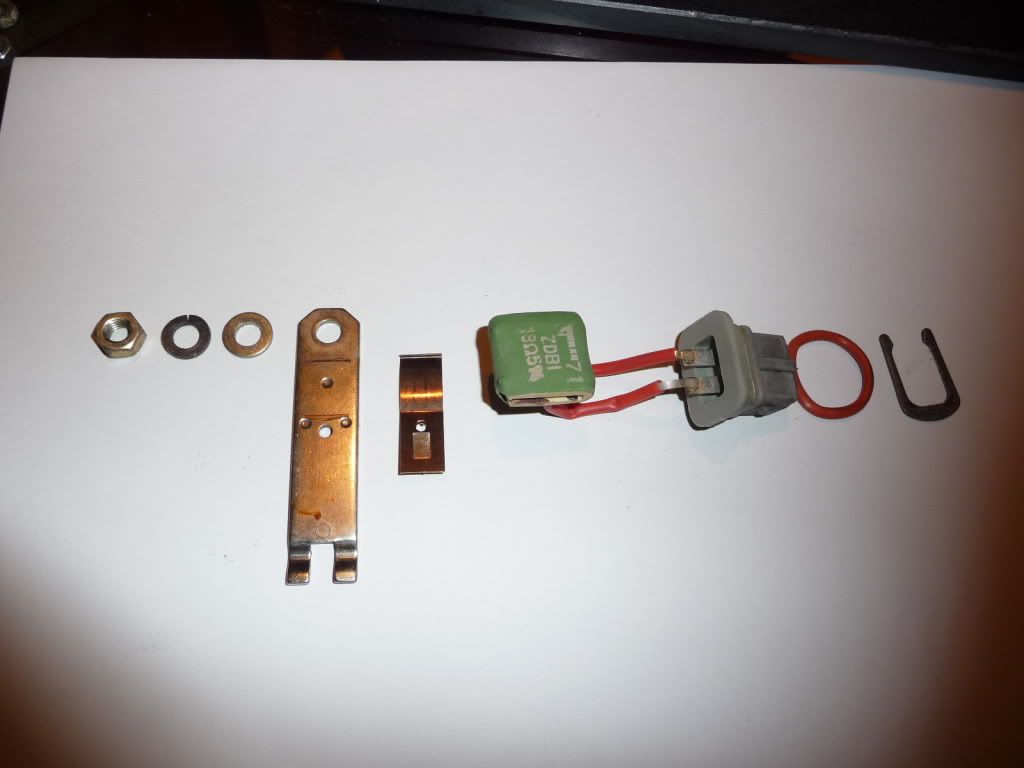

The Bi-metalic spring:
The spring heater element:
Plug retaining clip and seal:
The spring is electrically heated. In its cold position, the control pressure (which opposes the injector pressure fuel circuit) is lowered to increase the fueling to the injectors. This is done by the bi-metalic spring opposing the coil spring, aleviating the pressure on the diaphragm, and effectively bleeding off the control pressure in the metering head, richening the mixture. The heater element warms the spring to realease the coil spring, and so leaning the mix as the engine warms up. It only recieves this electrical input for a short time after start up, and from then on, the heat soak from the engine keeps the bi-metalic spring in the required position.
The reassembled warm up regulator
It's dead simlple, it's only weaknesses are failed heater element, which makes cold starting difficult, and rust in the diaphragm block, caused by water in the fuel. This one seems ok inside.
Regulator block:
The diaphragm:
