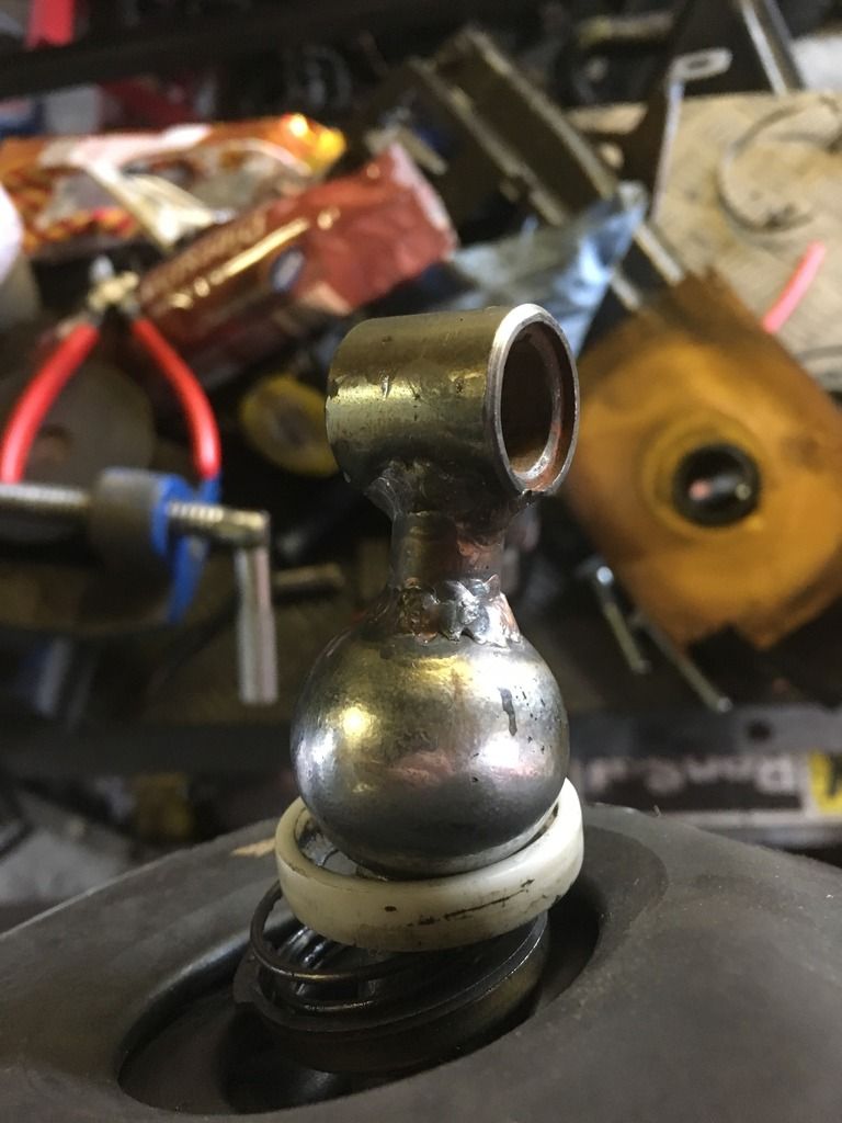

Having had a look at the lever off the car,
I might just extend the piece under the ball which would turn it into a short shift like the z3 versions available.
I know a stainless steel fabricator I'll enquire with.

I've had my shifter extended about 10mm, I haven't fitted it yet so we shall see.
