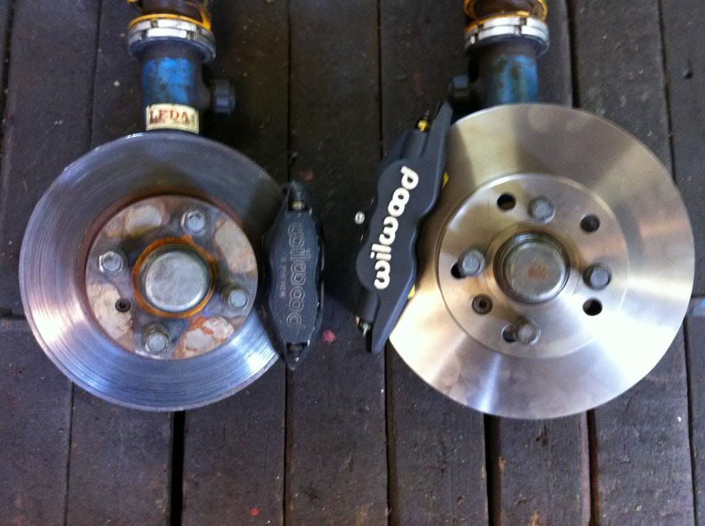

You may want to look at my setup, 296mm x 22mm (E39) discs with the wilwood superlite caliper. fits inside MSW & Mahle 15" wheels. Will not fit inside MIM 15".
The powerlite is only really n upgrade in terms of weight (unsprung mass), in fact the pad is smaller than the stock E21. I preferred a set of aluminium alfa twin pots over the powerlites I tried afterwards.
But the superlites a a big step in pad size and bite.

Ow wauw, what a difference!
Do you have the 20.6 or the 27.9 version? The bracket looks really sleek.

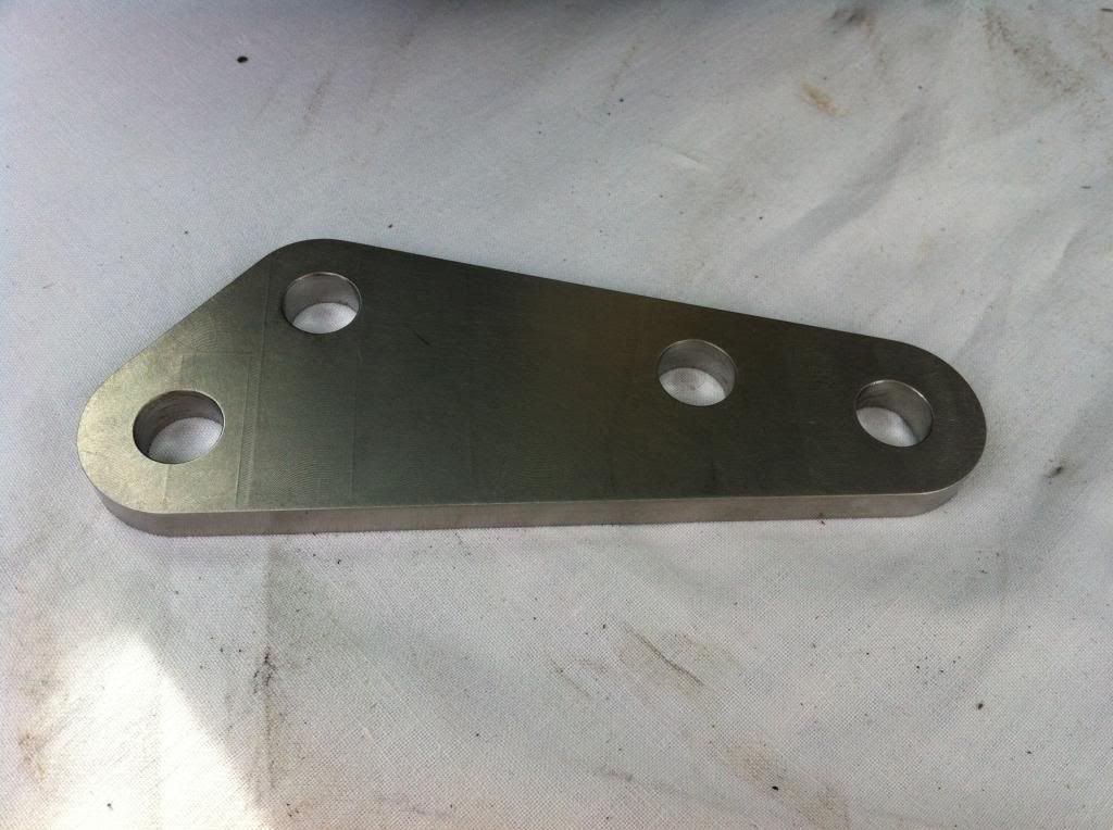

Brackets:
Thickness is 6.5mm.

The two mounting holes in the calliper for the bolts I drilled to 12.5 to clear an M12.
