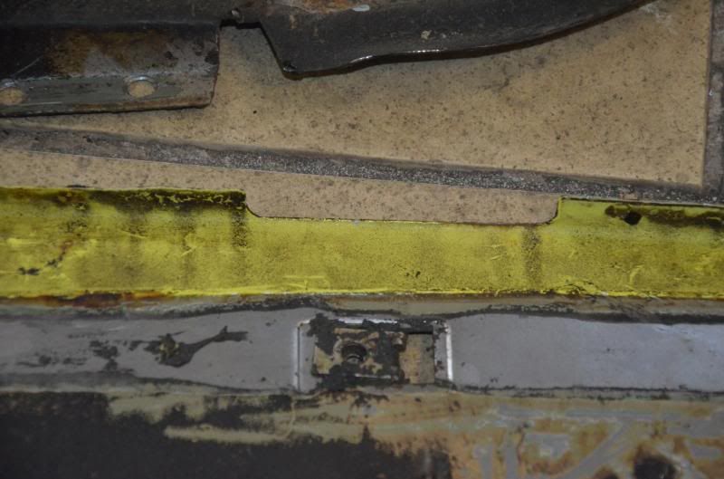

pretty sure, at least in Europe. Curious to find out where you think that I am wrong. Pre facelift is also different in the ledge under the vinnumber, flat and no "dent" that is spotwelded to the inner wing with 3 spotwelds.
For more info on this,see this topicFrom the top:
Old and rotten
Old and repaired
New and type 2, W&N
What’s the difference between type 1 and 2? Gap in the middle, type 1 is not round. The edge on top, that fits around the vinnumber. The are perfectly interchangeable, but that’s not how it should be. The advantage of the type 2 is, that that one can be attached to the inner wing, unther the chassisnumber.
Type 1:
Type 2:
