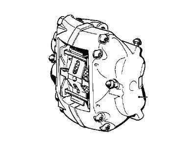

That is the left front brake caliper produced by Até. Yours is beyond repair? Basically it's the same LF caliper as fitted in most of the other E21 models, but with spacers fitted to be able to use vented discs. That P/N is 34 11 1 150 253 (please note that some cars were supplied with Lucas or Girling instead of Até and these are slightly different).
There are some aftermarket options for the solid disc E21's but I'm not sure if the spacers from Até calipers will fit, so that's a risk. My suggestion: get a used E21 LF Até and give it an overhaul, then you can fit the spacers from your own caliper. And you may want to overhaul the RF caliper right away as well, or perhaps that was already done.
On below image you can clearly see the spacer in the middle.
