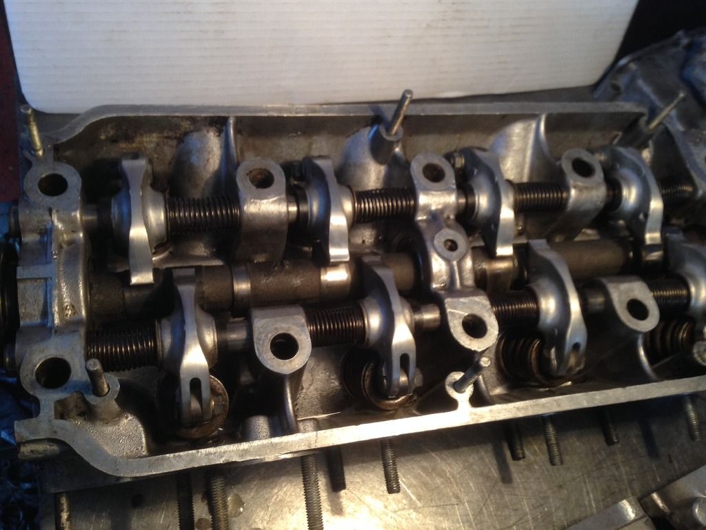

Some progress

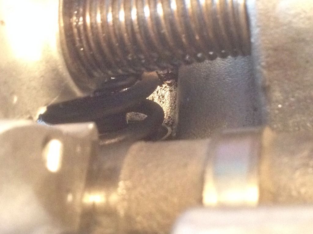

Double valve springs (can see it with a little effort) :
It 's coming closer to life, can already see some blood :-)

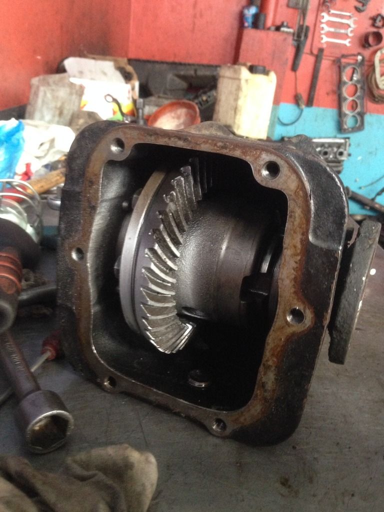

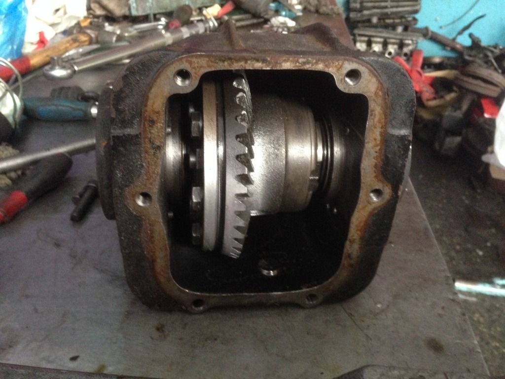

And the lsd, from Nas
Nas, our guessing is that it is a 2002 or e21 crown/pinion as well as diff case (the big part of the case. The cap is defo from e21), and the lsd plates are from e36?

I would appreciate some opinions here: Current setup is the open 4.10 diff with an eco 5 sp gearbox. I am quite happy with this setup, and I am sure that it will get even better with more power which will be provided by the new engine. However, I have a 3.64 lsd form Nas, and was thinking to give it a try (when the new engine's fitted). What do you think of that?

petroscf wrote:I would appreciate some opinions here: Current setup is the open 4.10 diff with an eco 5 sp gearbox. I am quite happy with this setup, and I am sure that it will get even better with more power which will be provided by the new engine. However, I have a 3.64 lsd form Nas, and was thinking to give it a try (when the new engine's fitted). What do you think of that?
It all depends on what power and torque you get out of the new engine.
A 3.45 and eco box is standard fit on a 323i with ~140bhp and 140lbft (190Nm)
But they are much livelier with a 3.64 and then more with a 3.91.
I don't know the full specs your new engine will have but lets say you'll have - ~130bhp and 130lbft (180Nm) as per the 2002 tii.
I'd guess the 3.64 would work quite well for fast road use.
If you were racing on track then a 4.1 is the way to go or even a 4.45 (if you can find one!).
To be honest it isn't hard to swap over the diffs so give the 3.64 a go especially as the LSD will make a big difference to how it drives.
If you don't like it and would prefer the shorter ratios, the LSD unit could be rebuild into your original 4.1 diff (I'm sure Hardeman could help there).

We decided finaly to go with the 3.64 lsd and a dog leg box (yes we managed to find one!), and in case I feel I'd like the car to be a bit quieter on the motorway maybe I will step back to the eco (however something inside me tells me I won't)

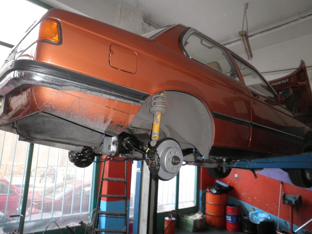

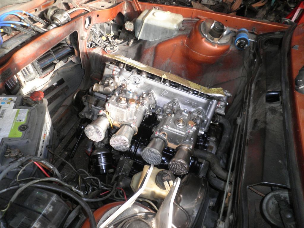

Haven't updated for some time now
so for whom might be interested

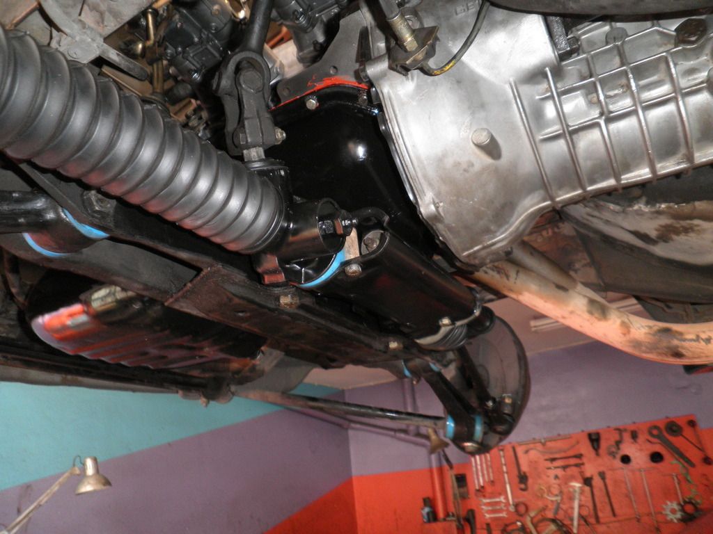

With disc brakes

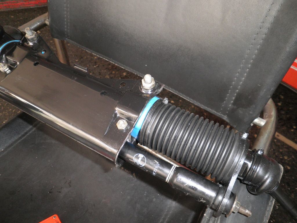

The new rack
Gearbox (dog leg from M20 to M10)

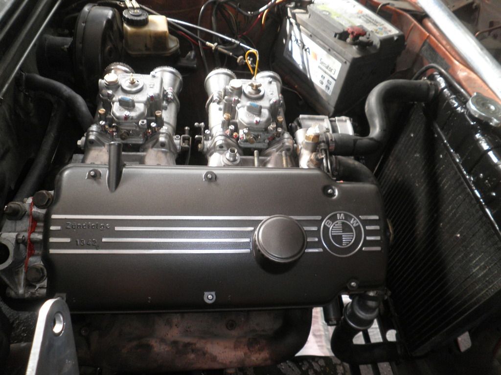

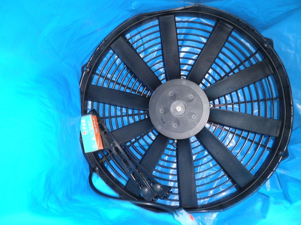

New engine in (have also some newer ones here)
Electric fan
Well this is a matter of taste (I haven't yet decided if I 'll leave it on)

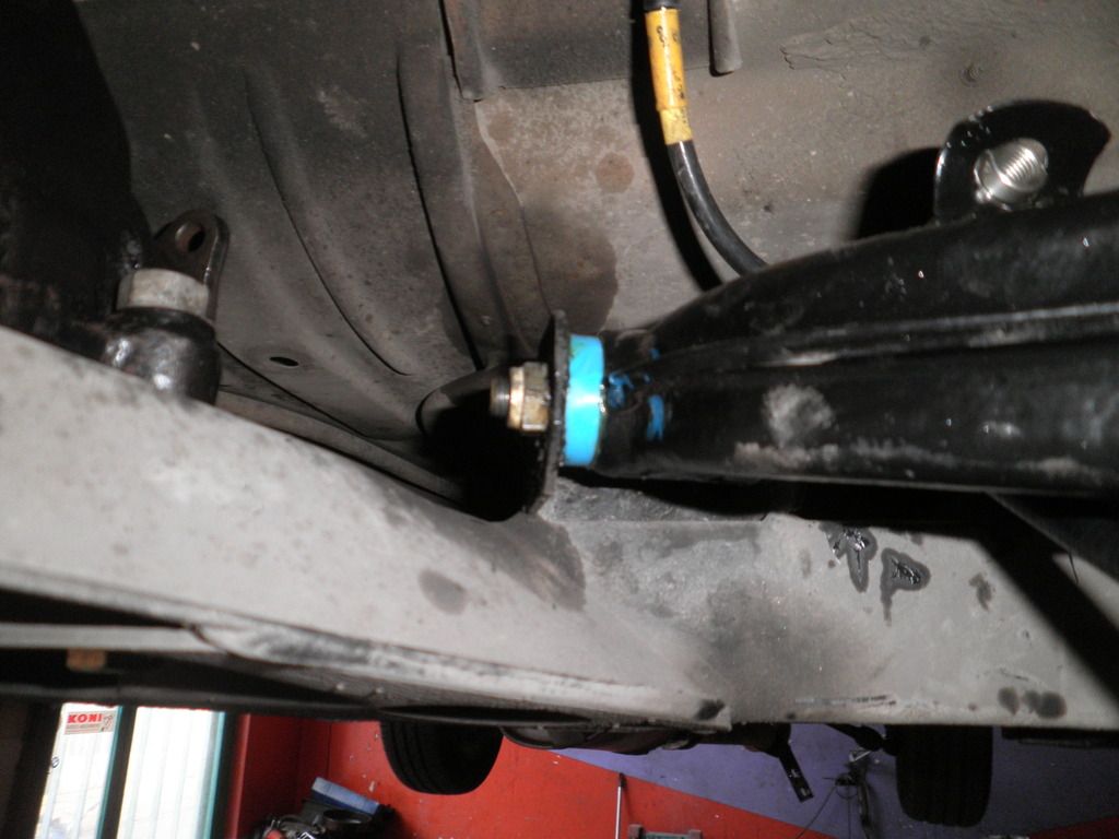

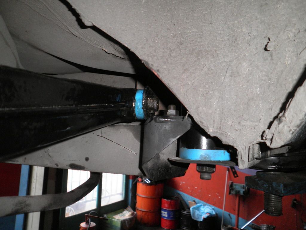

Eurometric Bushes
And the new engine coming closer to reality
Hope you like
