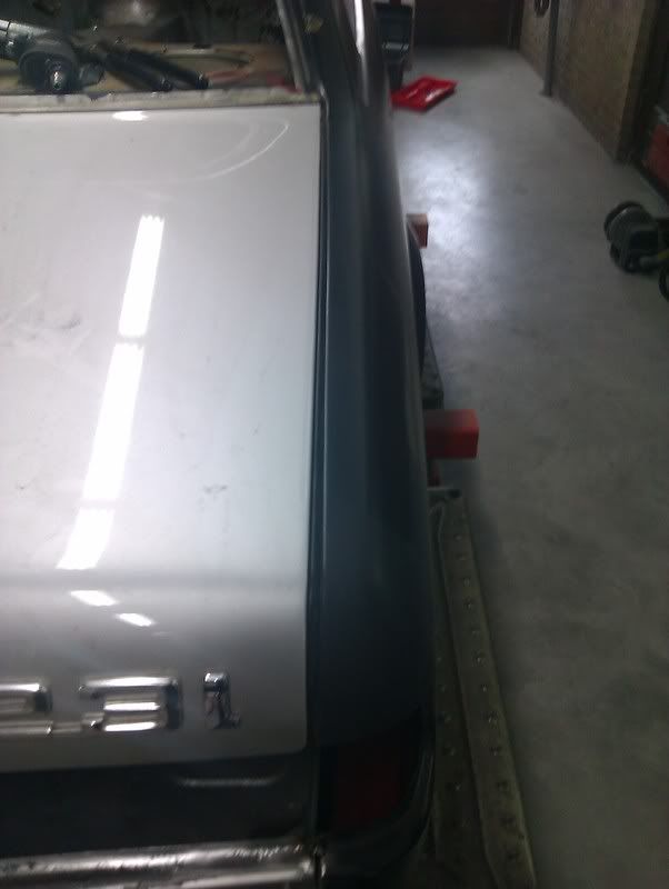

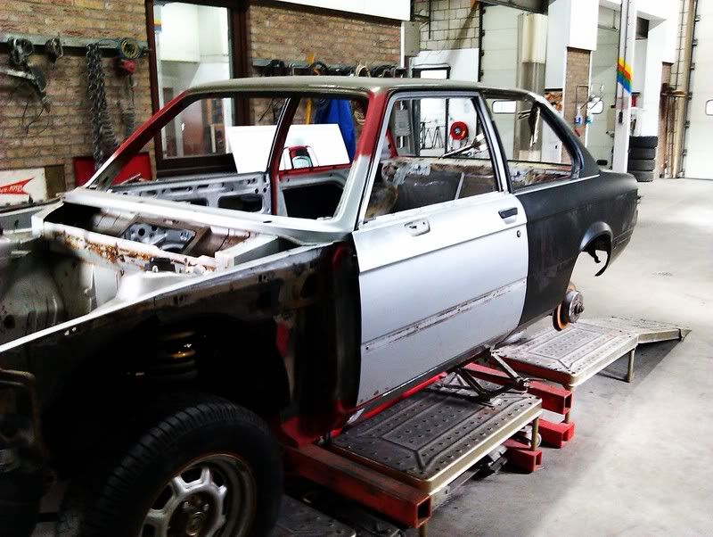

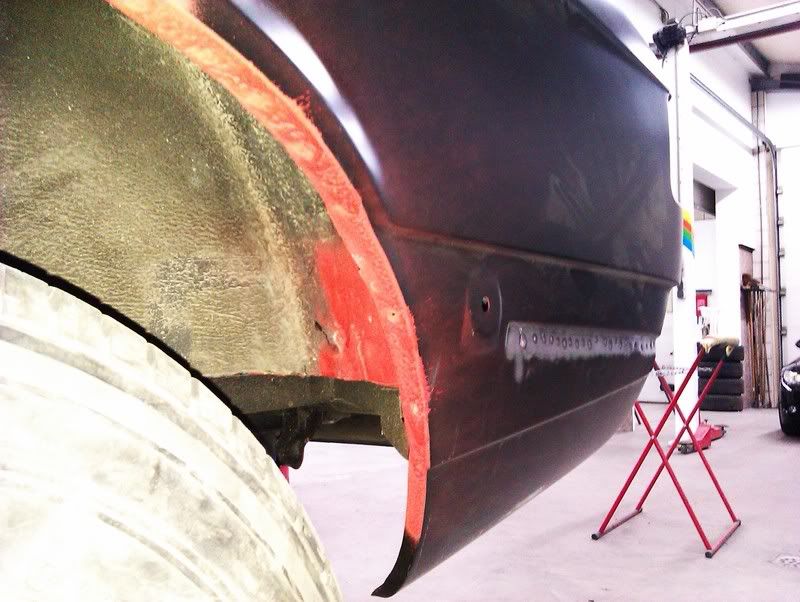

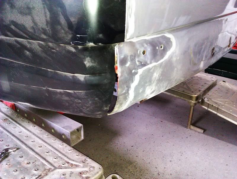

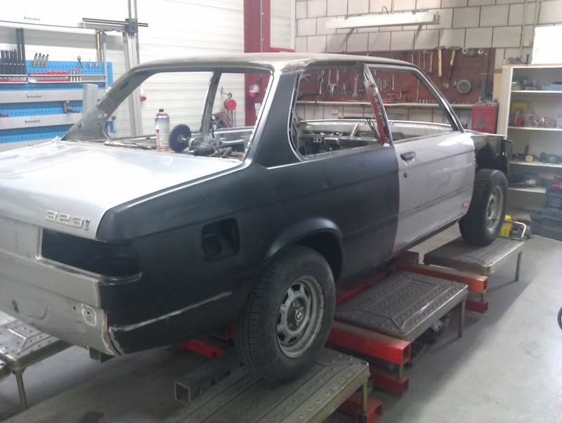

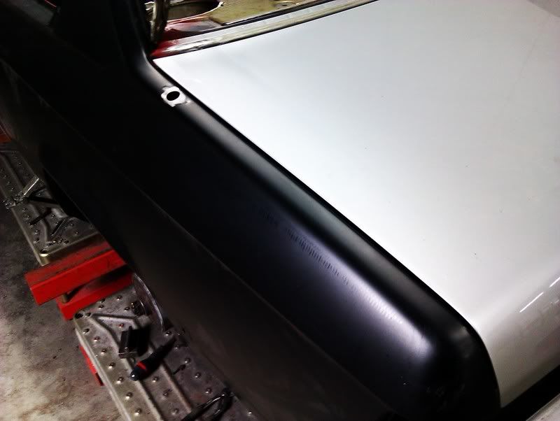

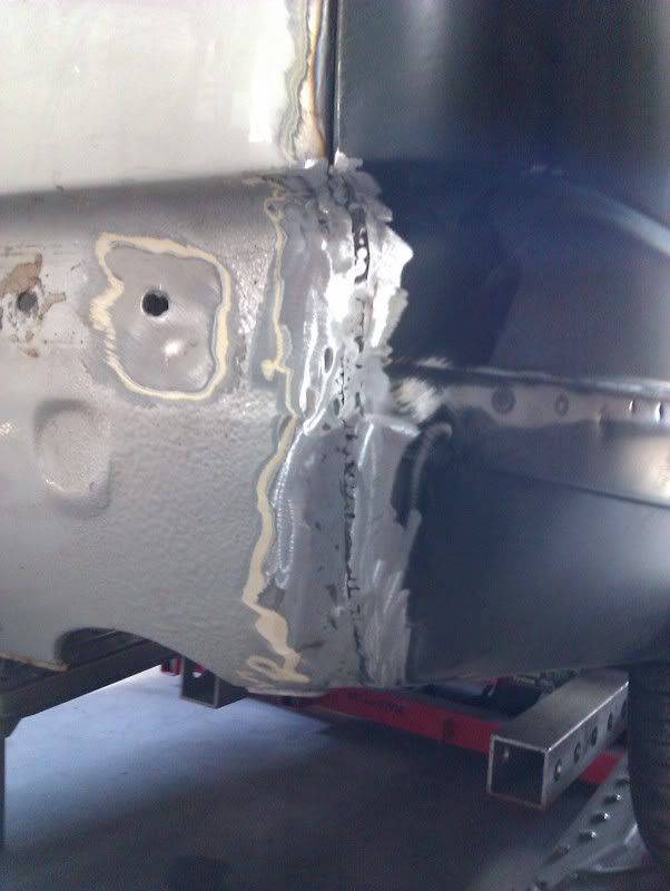

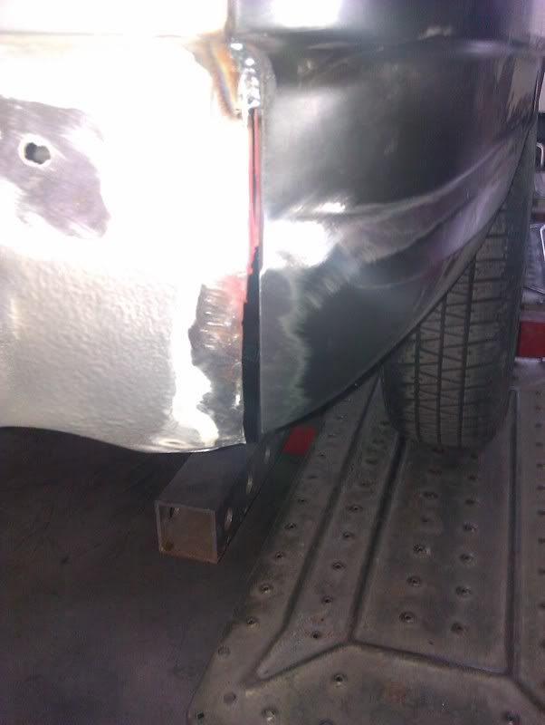

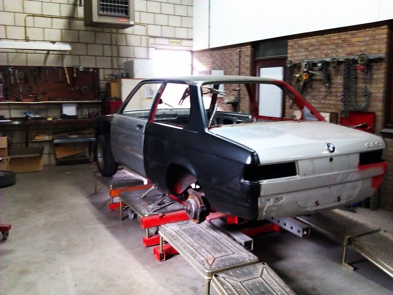

With the new sidepanel the gap between panel and bootlid has to be straight and even. Well, it is!
This gap has tobe closed
And this is were we stand right now. A damaged multi coloured beat up e21…

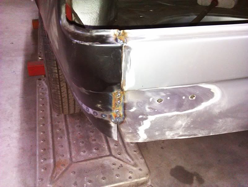

Almost to the day 3 years ago, July 15th 2011:
The right side is done, it’s ready! :cheers :thumbsup :shake :shake

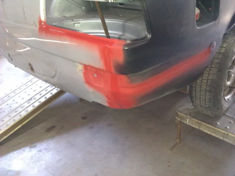

The final chores have been done :

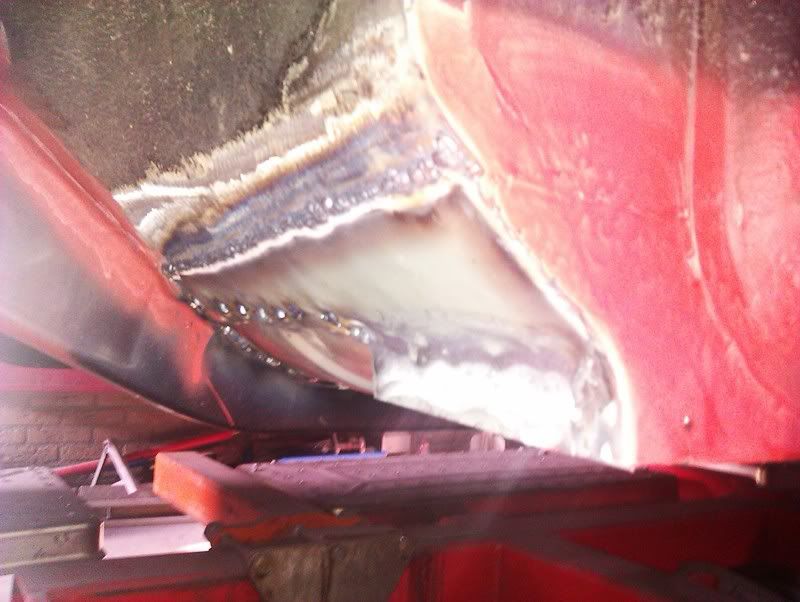

Welding under the taillight
Gap between side and rearpanel is closed.
And primered
Welded in the triangular shaped piece
And we started at the left side

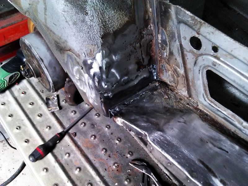

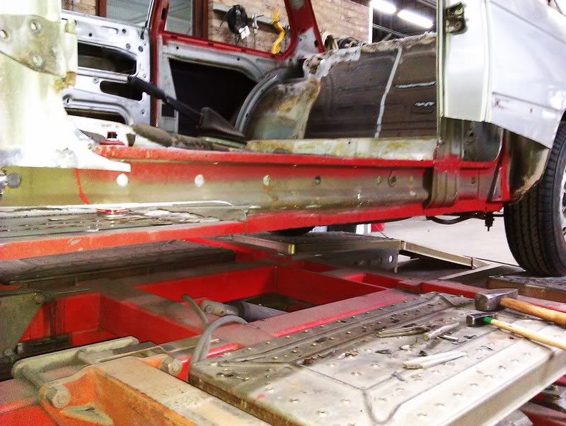

Grainded off the sill and guess what, it nealy came apart by itselve :hammer
The only spots were it still was attached are the little blank spots in the middle of all the rust.

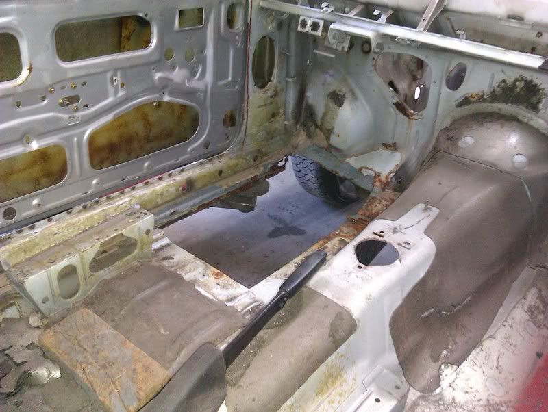

And we’ve cut out the floorpanel aswell, on this side the floor wasn’t welded to the chassisbar at all!!
The innersill is also very bad.
More to come.

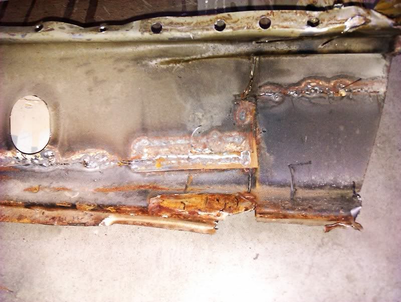

Posts: 19182
Re: Uwbuurman: 1978 323i polaris

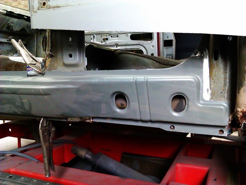

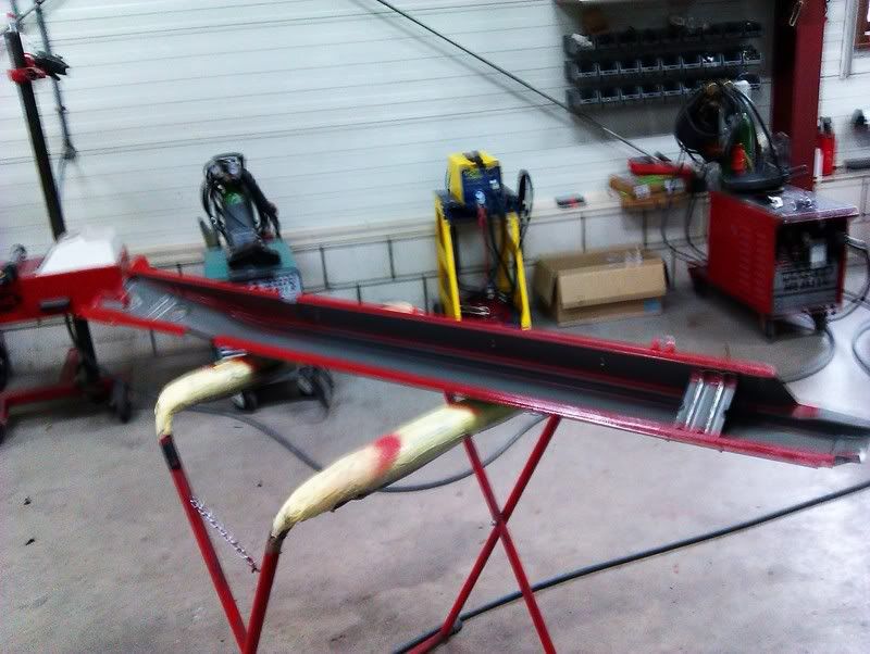

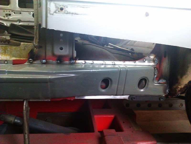

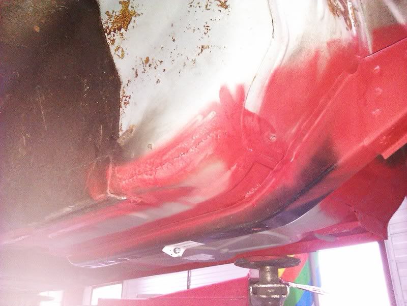

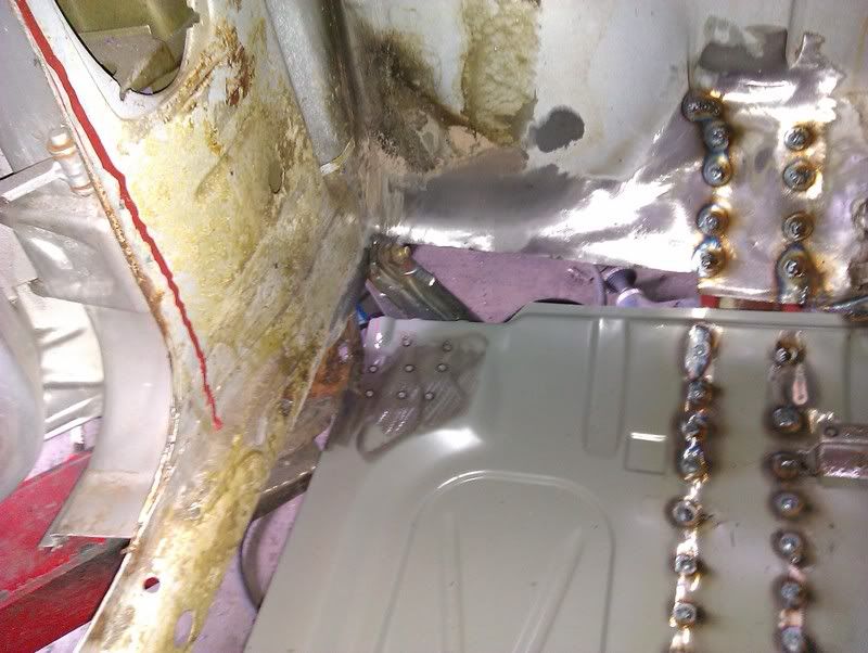

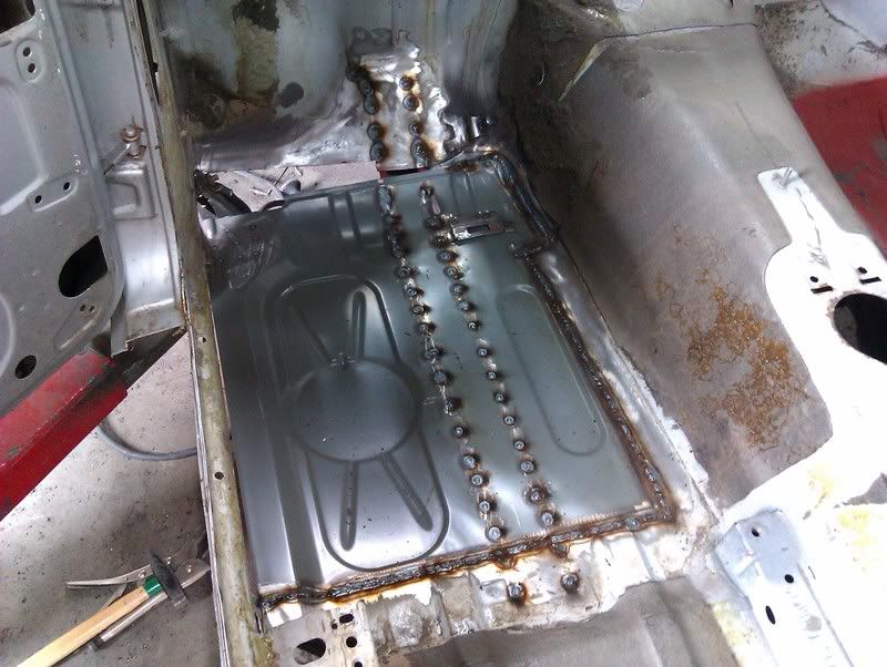

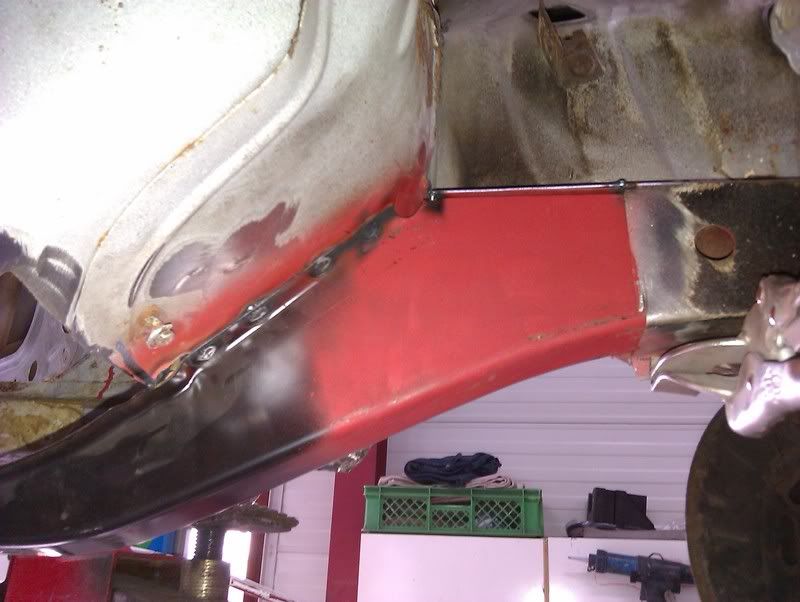

After cutting out all the rusted parts we replaced the floorpanel and the chassisbar at the left side!!! :cheers

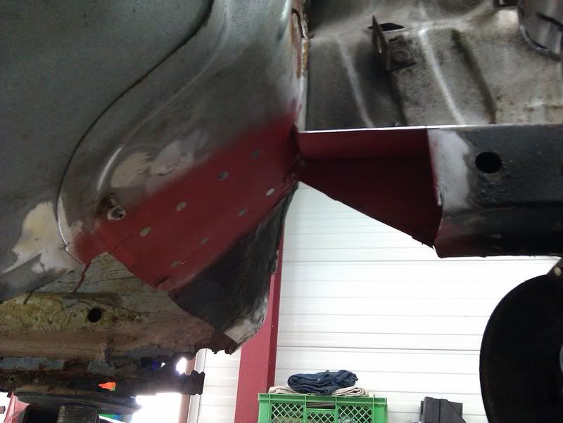

At first we had to prep the chassisbar
And then the car for putting in the chassisbar
And fitted

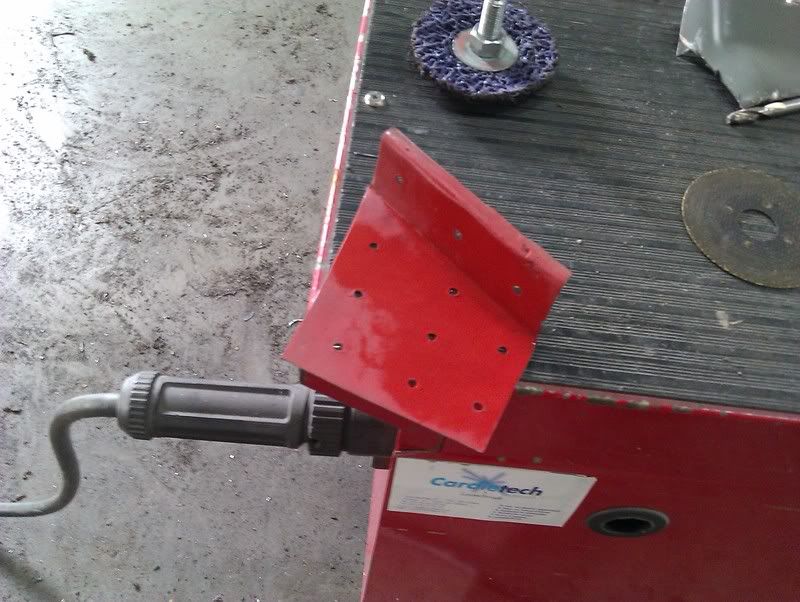

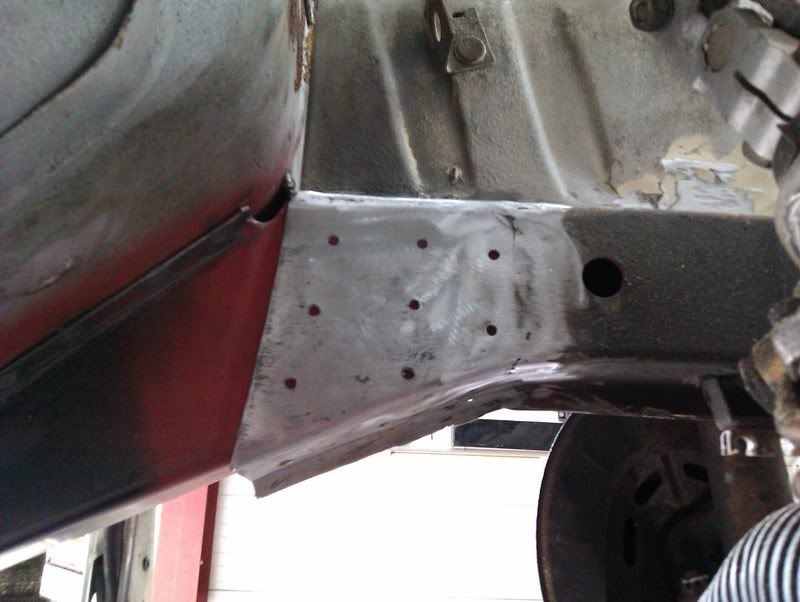

To make it all like BMW intended a repairplate is made
And fitted

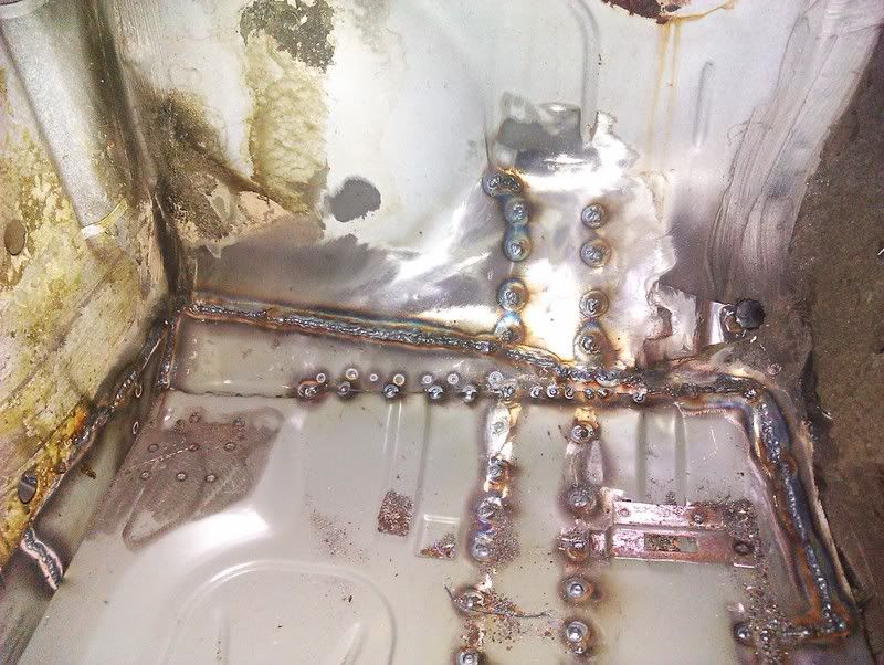

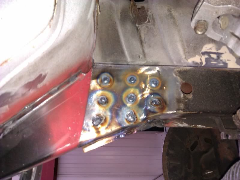

To make it look like factorywork some spotwelding :cheers
Just compare it to the otherside :banana
Trottlebracket welded on to the new floor
And the floor fitted
This gap has to be closed and the inner sill has to be repaired.

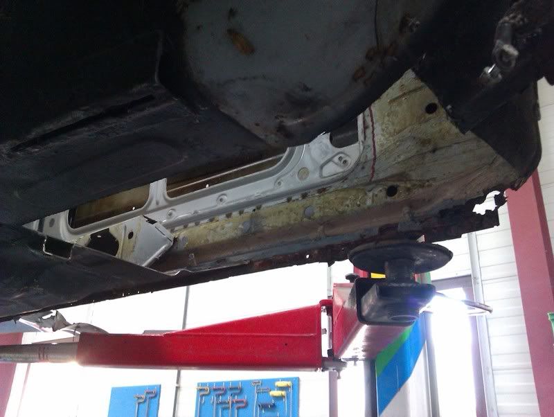

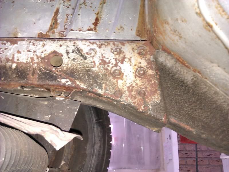

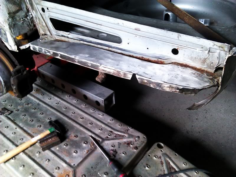

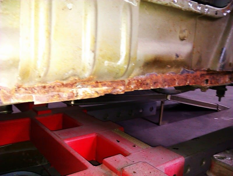

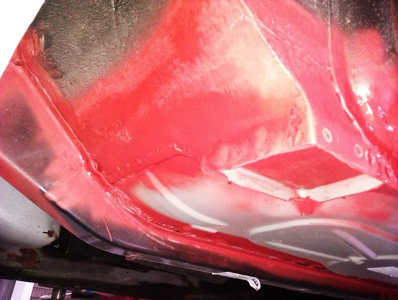

Monday July 19th 2011

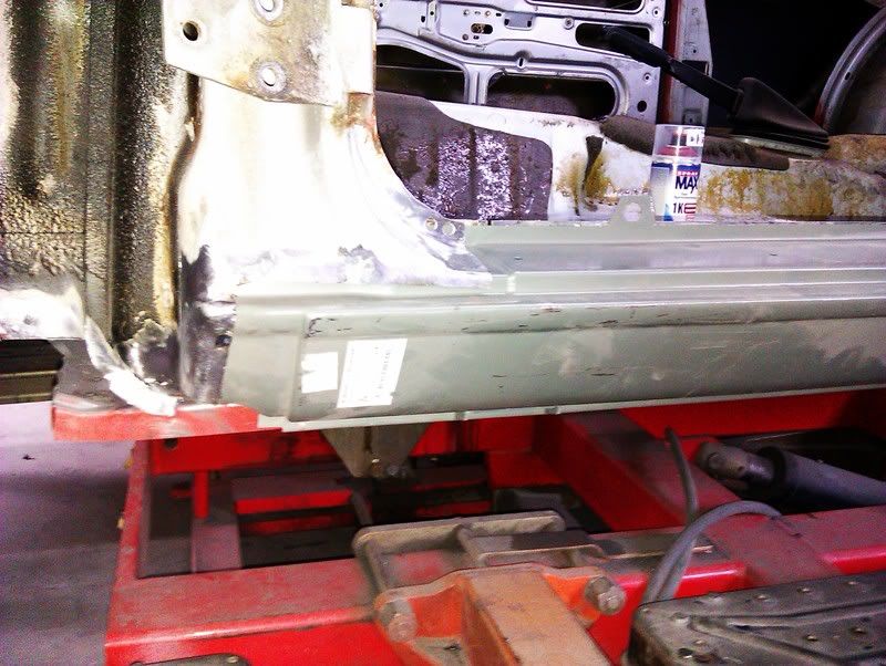

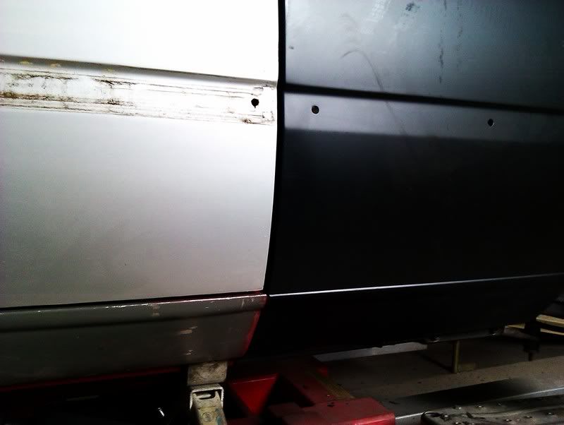

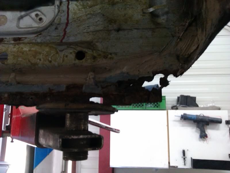

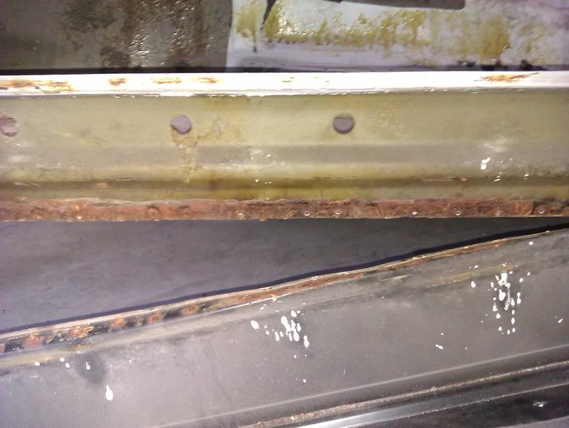

We took off the outer sill and discovered this crap

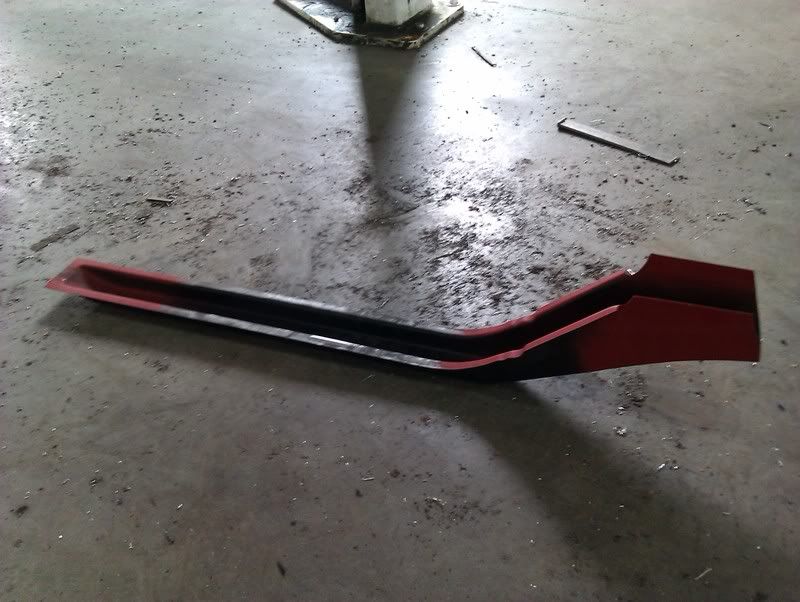

Prepping the new sill
Prepping the innersill

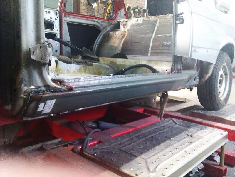

Fitting them dry
And the day is gone, so more to come!
Posts: 19182

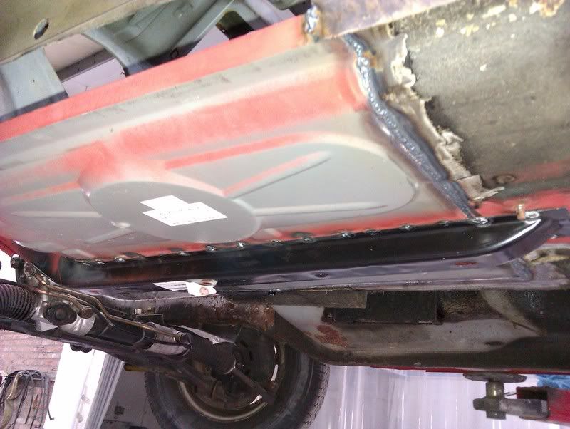

Tonight we made a good haul but the camera was charged, so no “work in progress pics”

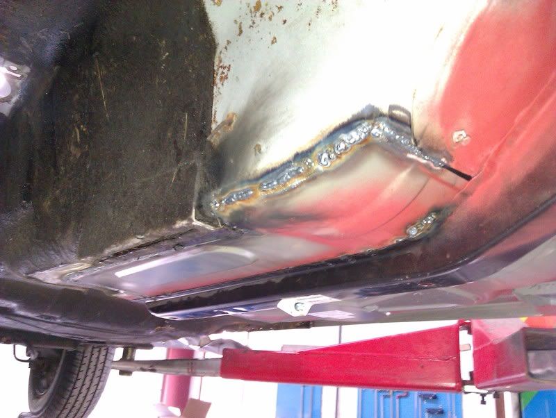

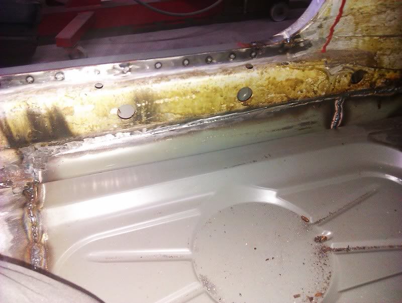

The floor/inner sill is ready, just needs to be grainded
The outersill is also welded on, also needs grainding

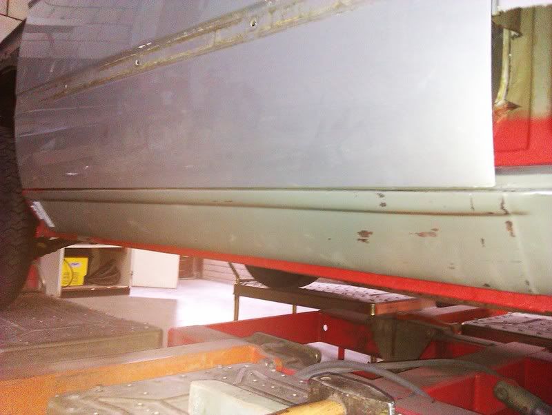

July 21th 2011

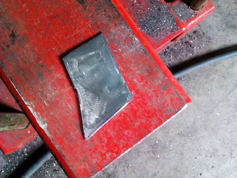

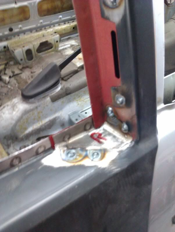

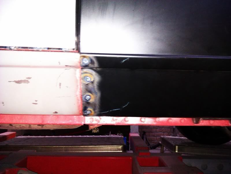

We grainded of everything and spotwelded the sill on the lower side. Then we took of the antennamount on the Apillar, because my electric genuine BMW antenna will be put at the rear! :cheers
Grainded of the floor
Closing the holes from the antenna
And remounted the door

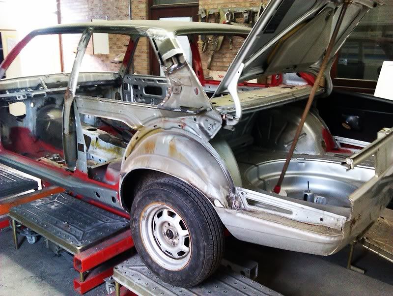

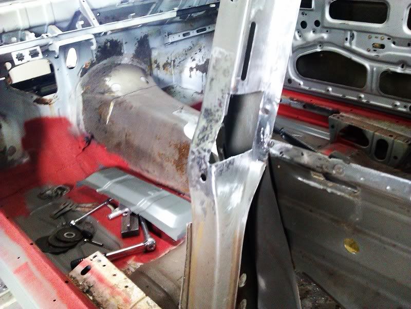

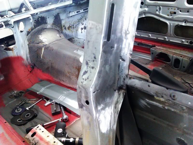

Seen what the car hided so far, it would be a real surprise what we would reveal after taking of the left sidepanel

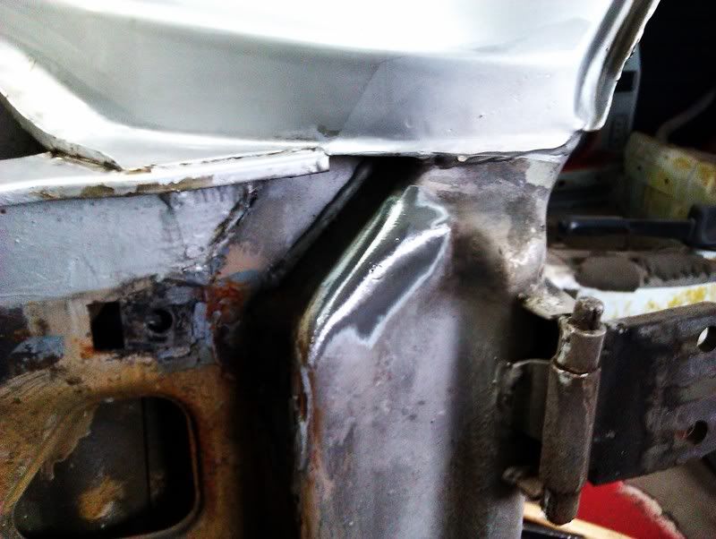

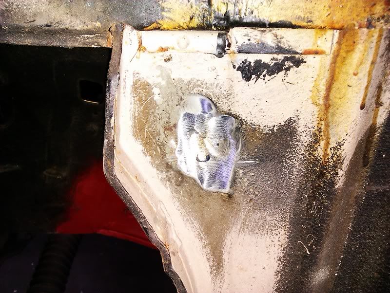

The Bpillar is much more rotten then at the right side, but was nicely repaired

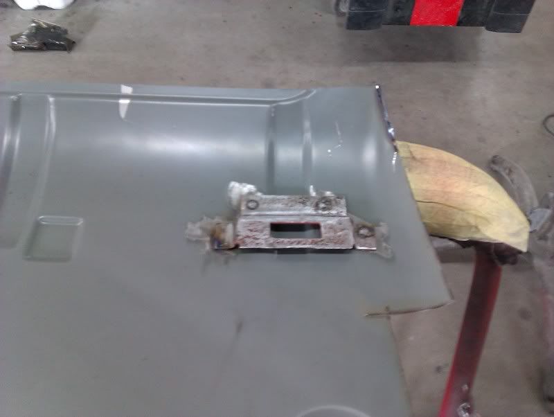

Doorcatcher is just as rusty as the other side
Grainded of the rust and primered it

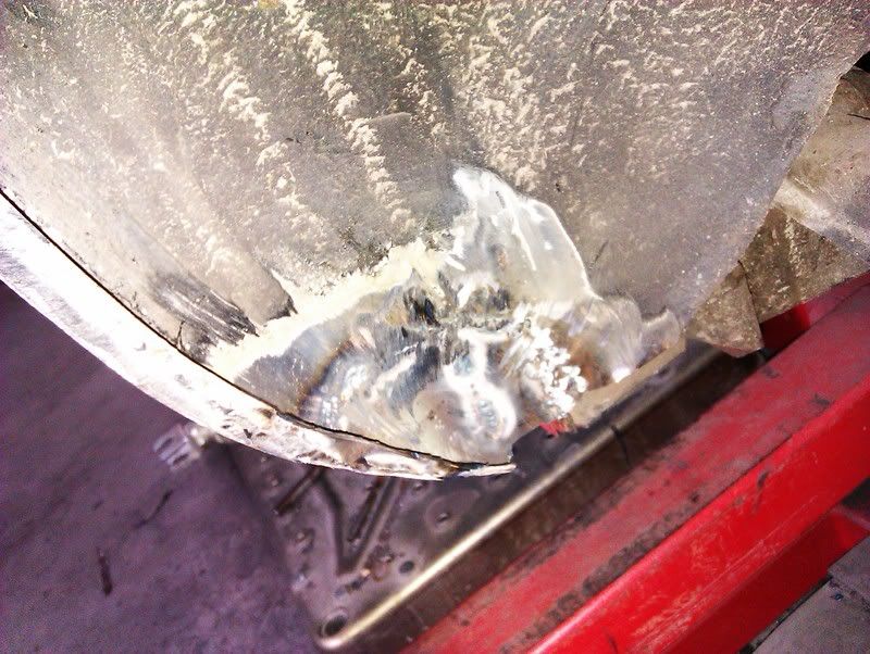

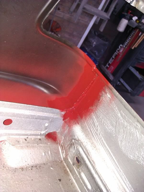

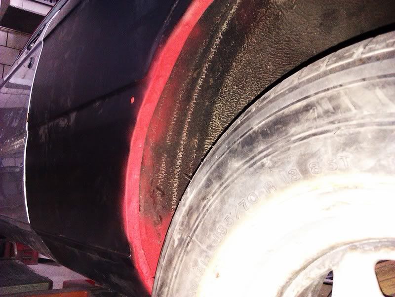

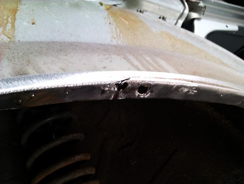

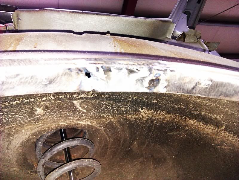

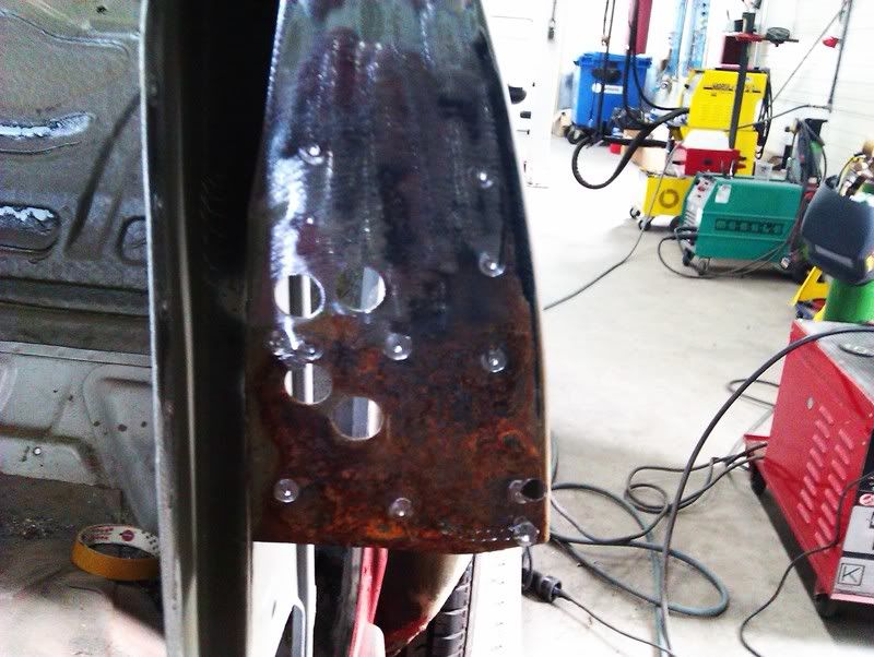

And then we discovered this nice litthe hole in the wheelhousing/bootfloor
But we fixed it up again!

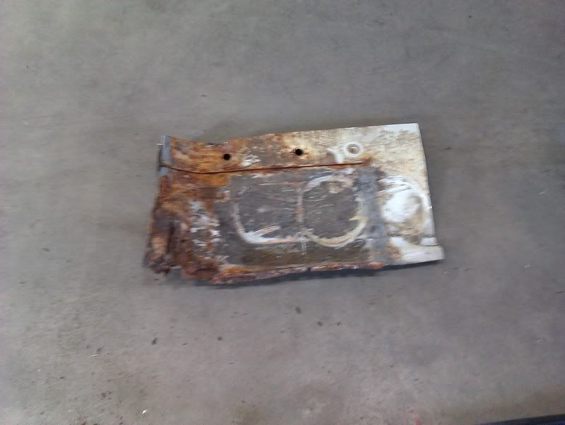

Wheelhouse is rotted in the middle and in the lower part
And fixed

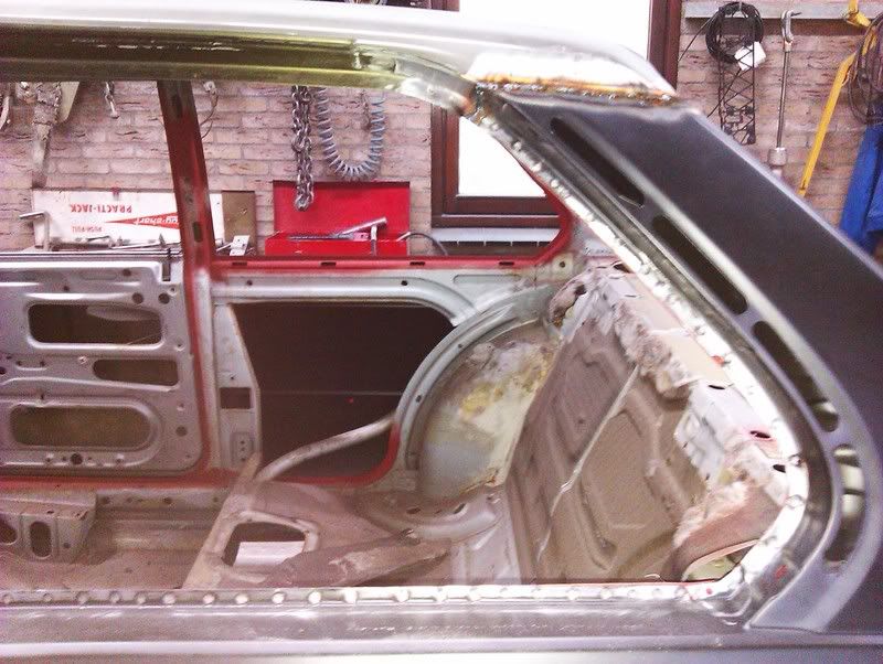

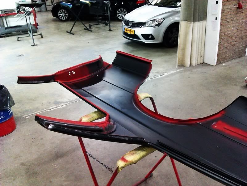

And then, finally, the work on the sidepannel was started. Fitted it to size.
Checking all the gaps
This gap needs repairing
And than we have this!
On Monday we’ll fix the last work on the sidepanel

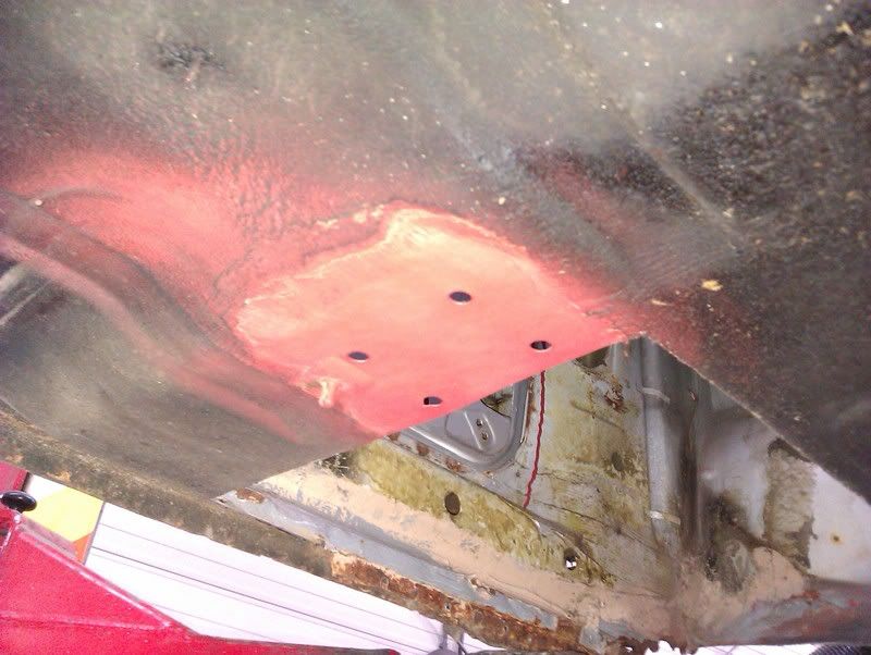

My thoughs were to have the bodyshell put in a acidbath and then to be dipped in a paintbath. The acid will eataway all the paint, filler and left over sealant. But as it turned out, in the Cpillar, some plates between the skin are glued in, and smeared with sealant. But also the fuelcover, where the fillerneck is fitted (how the hell is that piece named?) is glued on to the sidepanel. If I was to put the car in an acidbath, those parts would desolve and let go. So thats not an option.
My new plan is stripping of all the paint and filler, have it sandblasted and then coated in expoyprimer. After the paintjob, I'll drown her in Dinitrol, so she'll never rust again!

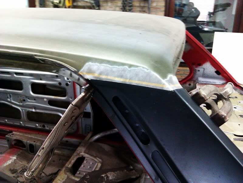

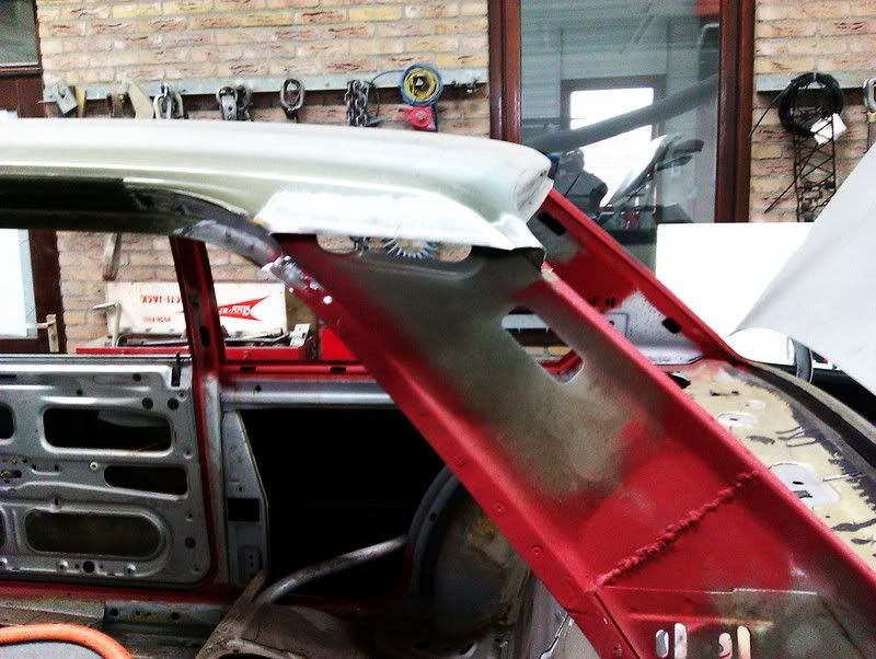

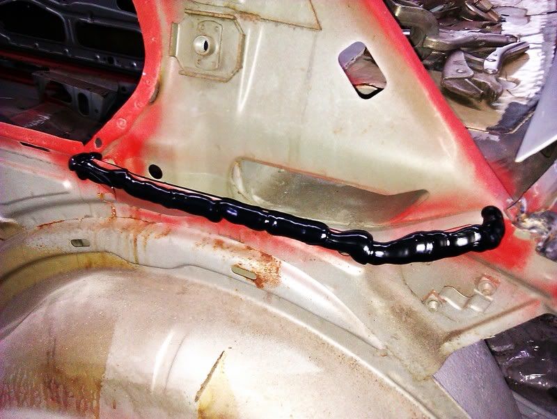

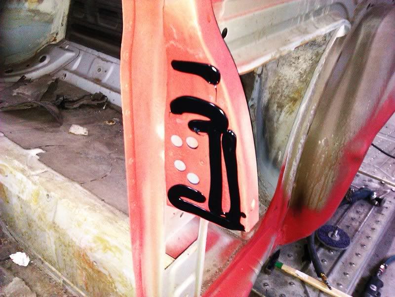

And the lift sidepanel is reattached!! :shake :shake
Here you see the panel being prepped
The glued parts
Spotwelding the wheelhouse
Rooftrim CO2 welded, windows spotwelded
And welded the sill
The gap underneath the taillight has to be closed and that triagular piece near the Bpillar has to be put in.
So in short: completion is near!!!! Next Friday she’s coming home! :cheers :cheers
