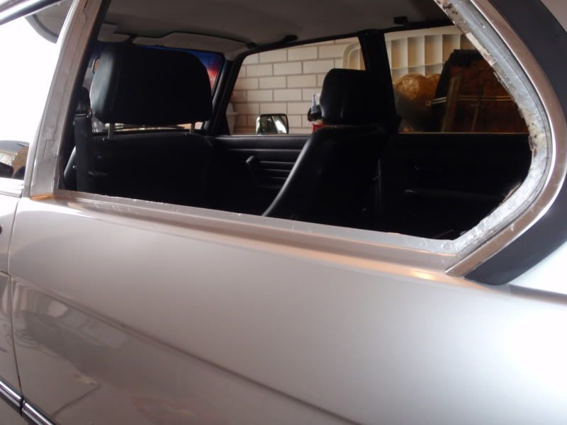

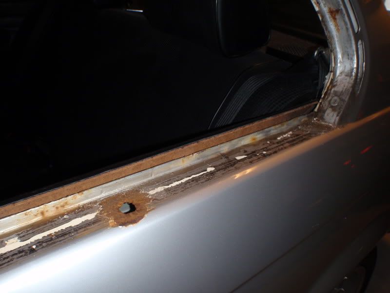

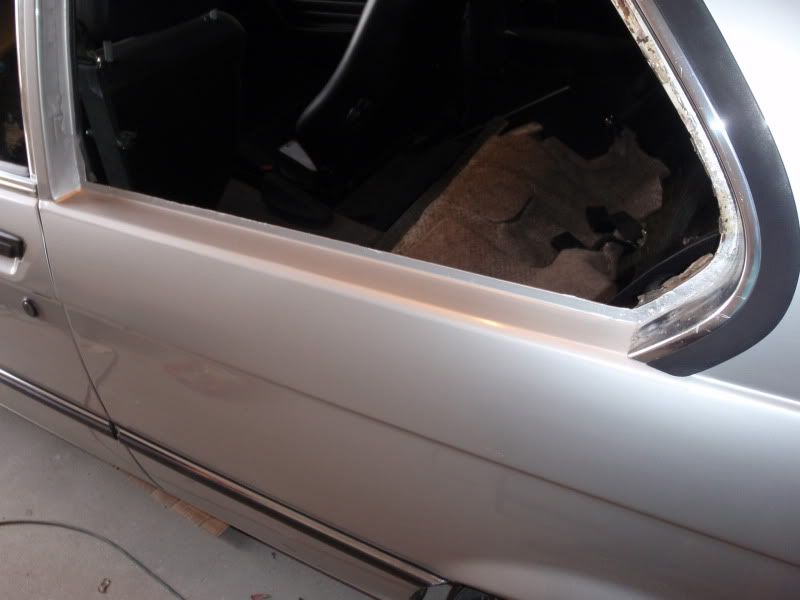

Well, the e21 is very nice but not perfect. I knew that when I bought it. The day after the very first Sharknosemeeting ever, which I attended, I took out the left rear window. As it turned out, the whole rubber sealing was glued in, so I had to use great force to push it out. Of course, I took of a nice strip of paint…
Under the rubber seal I saw: rust and a hole, more rust in the corners and lots of filler. I’m learning that this car has lots of filler, putty and sealant under the paint. So at this moment, august 29th 2010, I think that there is quite a bit of extra weight on my car in putty. Probably the whole car has to be stripped down in the next 3 years for some restoration work.

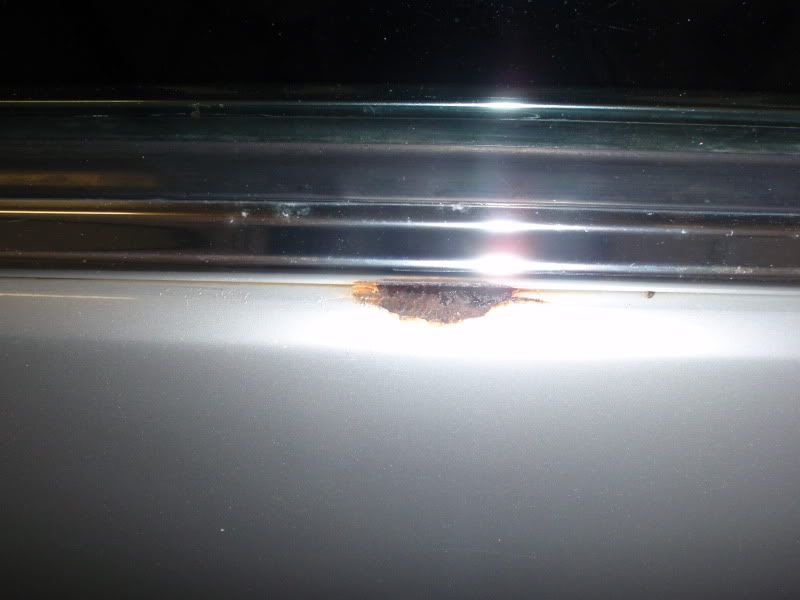

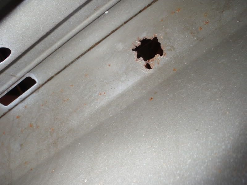

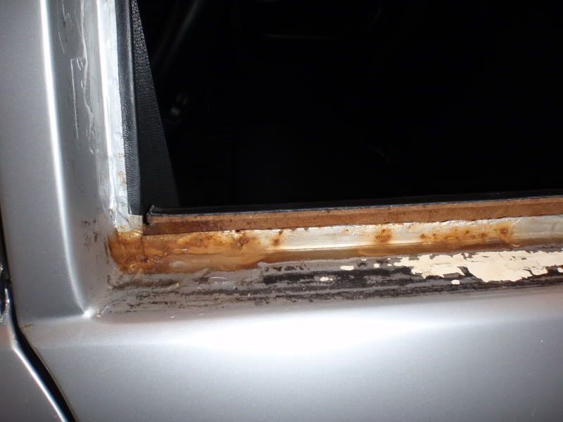

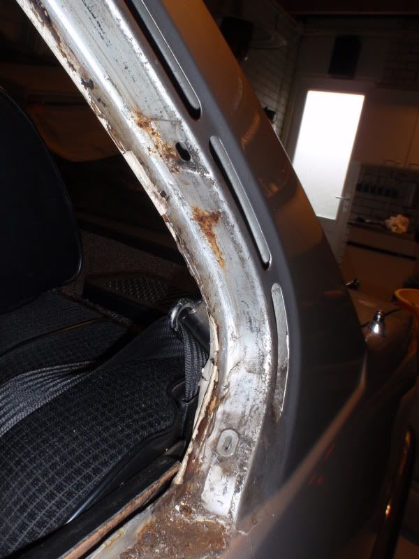

Like I wrote before, the 323i has some attentionpoints. Right now, in 2010, it’s 32 years old old, so it just happens. The most urgent matter is the rusthole under the left rear window. This is wat it looked like, before I took out the window. At this point I still had the hope for a simple repair.
En van binnenuit, de achterkant van het gat:

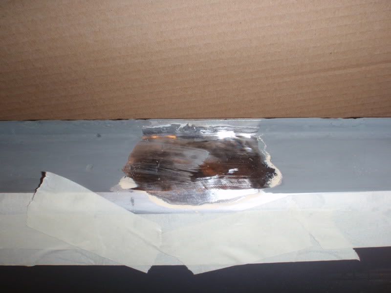

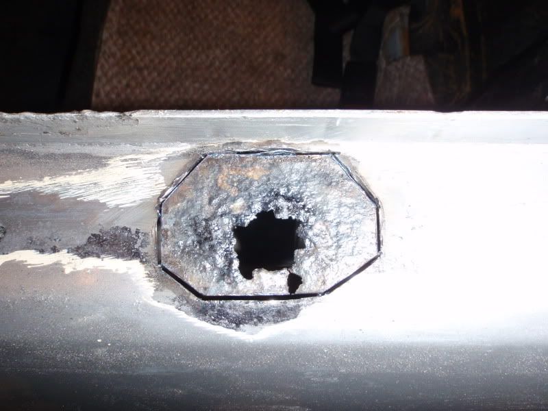

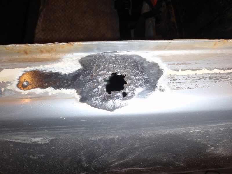

At first I cleaned it all up, to see the full extent of the damage.

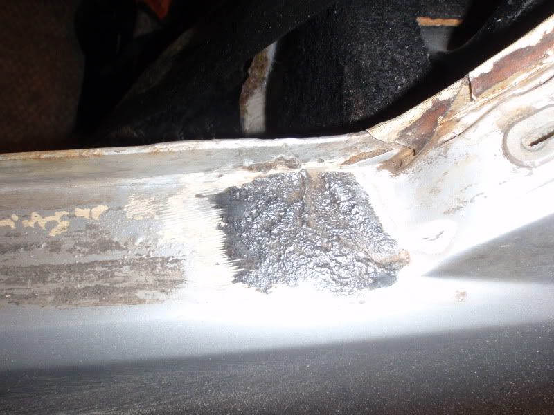

Than I put some rust converter on it. That makes a chemical reaction between the metal and the oxygen and solves the rust, converting it to solid material again. After that I cleaned it up and put some zincspray on it
The rotten part had to be cut out, so a new piece could be welded in to place.

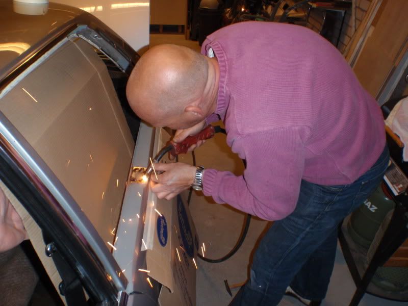

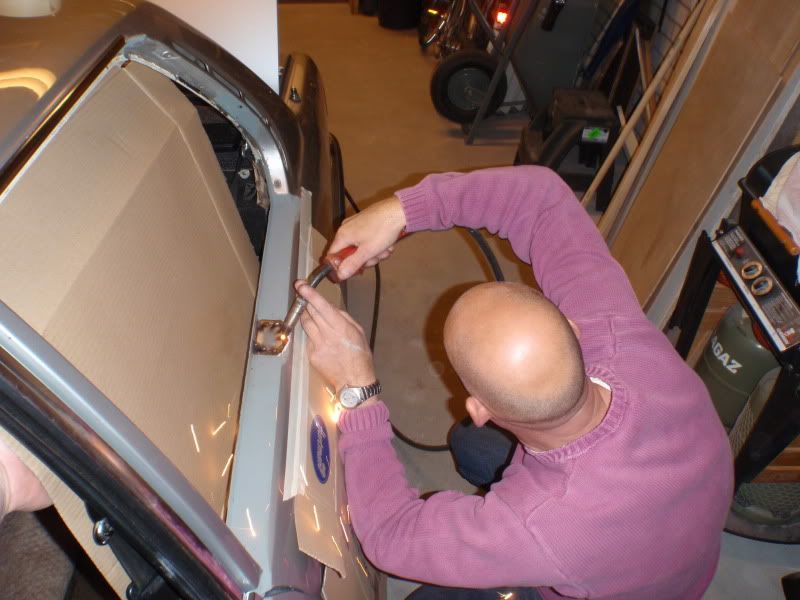

At this moment in 2010 I don’t know how to weld and I don’t have a welding machine. But our great member Arnold D. has a nice welder and knows how to use it.Image . He helped me out, big time!Image

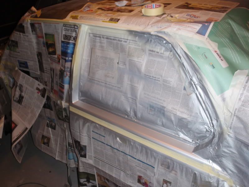

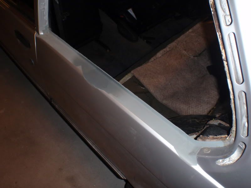

After that I grainded down and primered it again.

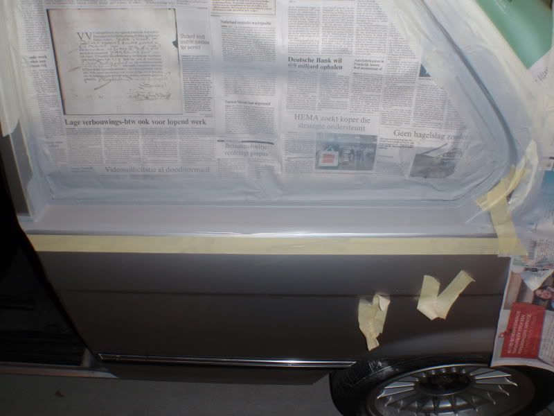

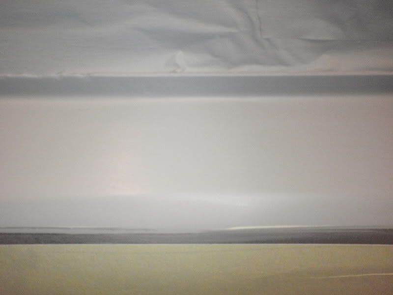

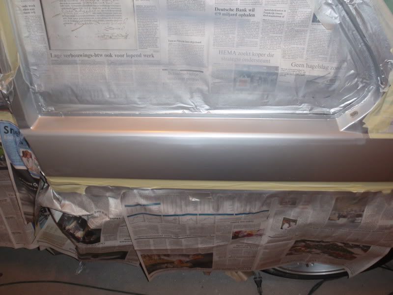

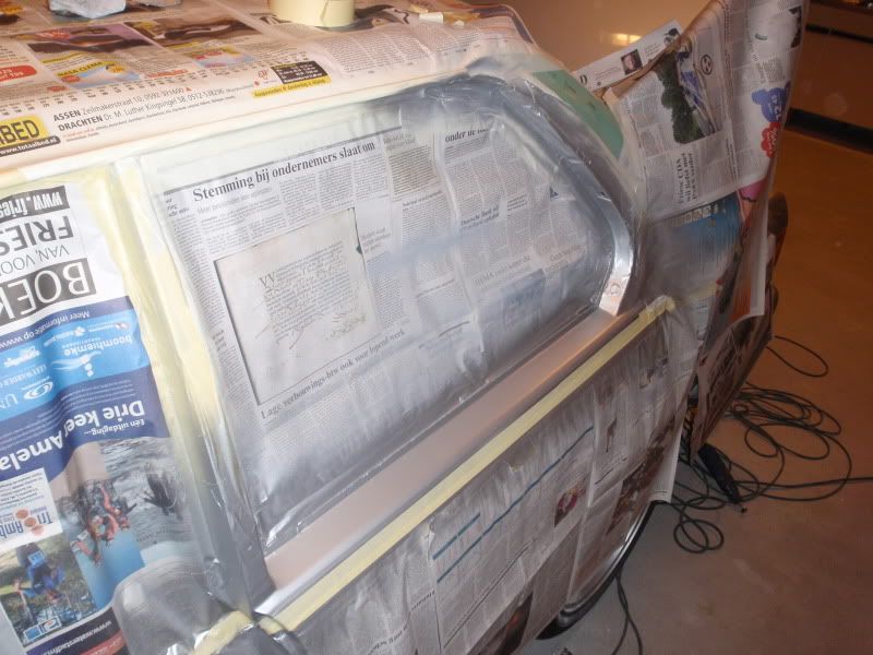

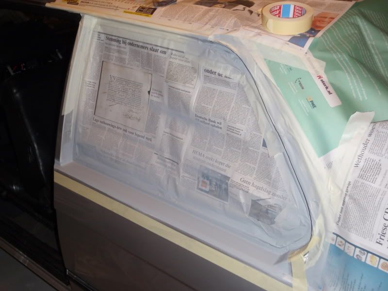

After that i finished it up, filler, primer, colour and clearcoat. Doing it the best, the whole panel had to be painted, but I need a new door as well some time soon. I’ll have it painted all together, but not now. So I bought a praycan at the dealers. OEM BMW Polaris paint.
Primer:
And colour

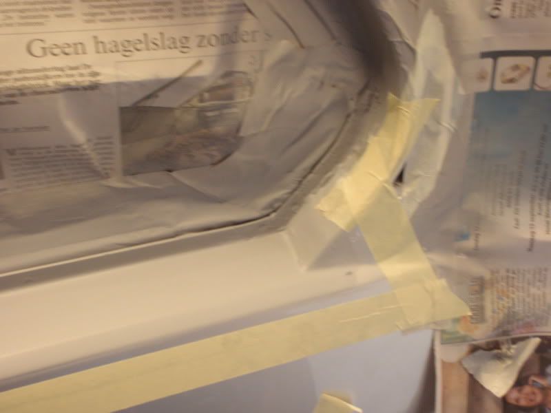

clearcoating
At the end of the day, my rusthole is gone!
