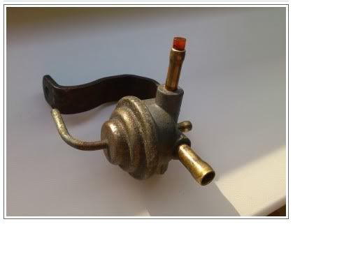

Hi ! my car has two fuel pipes , I've heard that some cars got the return pipe, some didnt (different carbs maybe ??)
the stock regulator looks like this :
There is a pic. of it in haynes for 4-cyl. engines , it is mounted on inlet manifold..
Thanks for the help :cheers

Thank you Reck! hopefully someone else will see this , now i think it's carb related, I managed to find older working valve but the problem stays the same...I can see carb rebuild in my near future :crazy
fuel pump works well...
