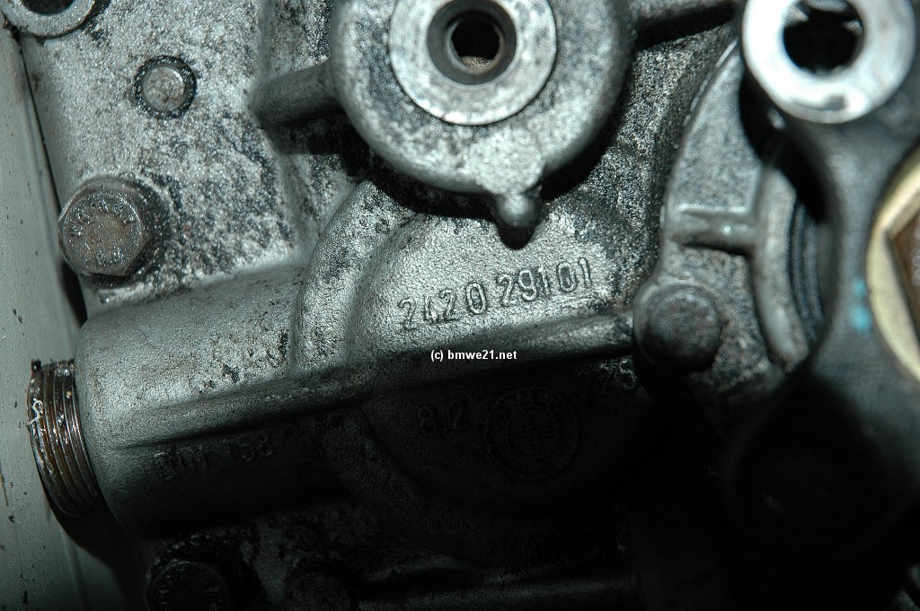

usually find by looking at the serial it will indicate its a 242. The sport boxes usually have removable belhousings and are shorter in length than the O/D 5 speed. So along with the shift pattern, you should be able to find out which is which.

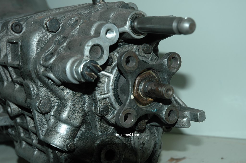

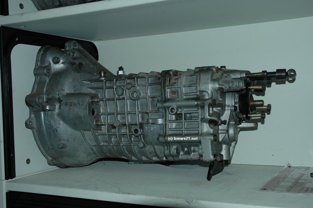

Here's some pics... lemme make this topic sticky as these questions pop up on a regular basis. The easiest way to recognize ANY 5 speed is the extension of the gearbox housing. All M20 gearboxes have the letters "M60" cast in them (the original model designation for the M20 engine).
BTW I apologise for the pics that are slightly larger... just so y'all can see things more clearly:
Let's start with the 245 overdrive boxes:
U can see the reverse switch on top and the M60 sign slightly left of the copyright sign.

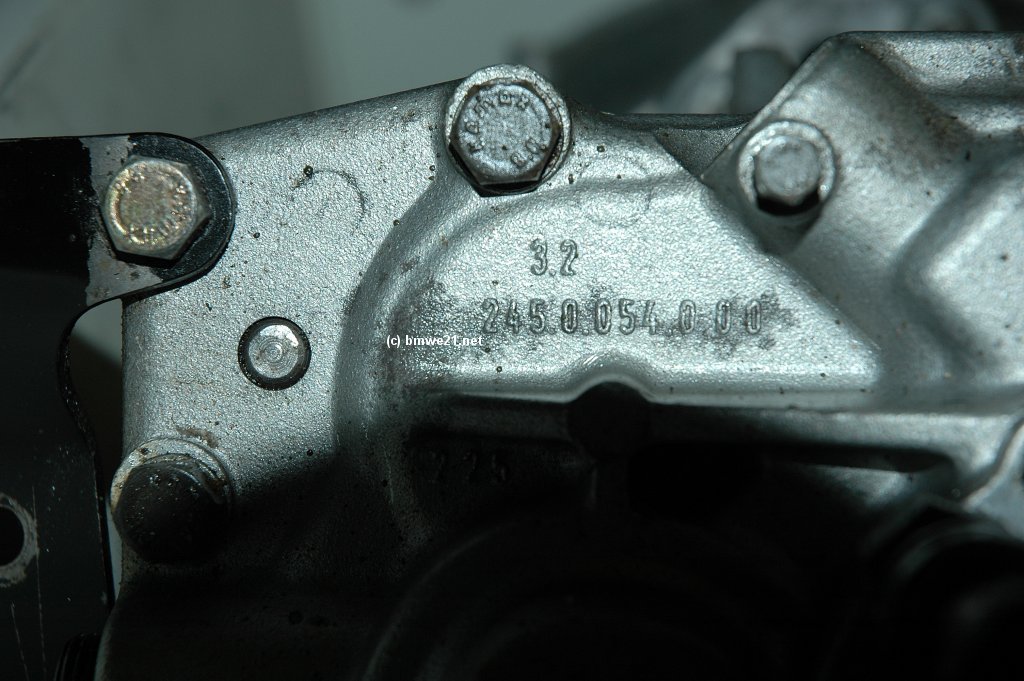

The tail. Notice the speedo drive connection just above the copyright sign (U need this for an E21 and E30 boxes don't have 'em). The part no is just right of the copyright sign.

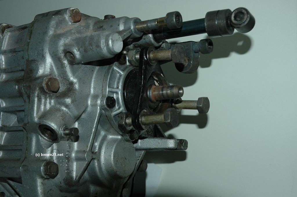

Even though there were some 245 sports boxes, most of them are marked 242 just like the 4 speeds... easy to tell those apart by the extension. This confusion is quite common, sometimes I get the idea Getrag fitted covers upon availability, in many cases the numbers aren't right.
Didn't clean this one so the M60 sign is a litle harder to recognize.
There's the reverse switch at the tail. The box' part no is right next to the copyright mark.
One last thing to notice: 3 or 4 lug output flanges. The early ones up to 9/80 had the 4 lug version, the later versions the 3 lug.
