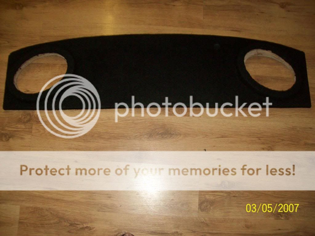

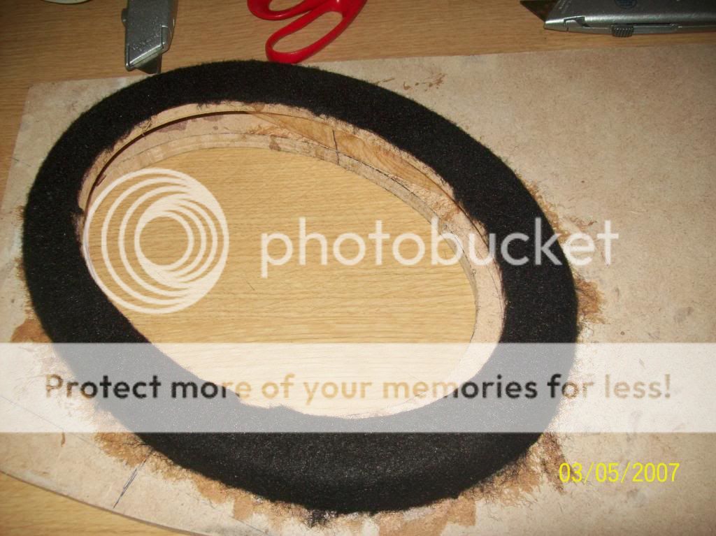

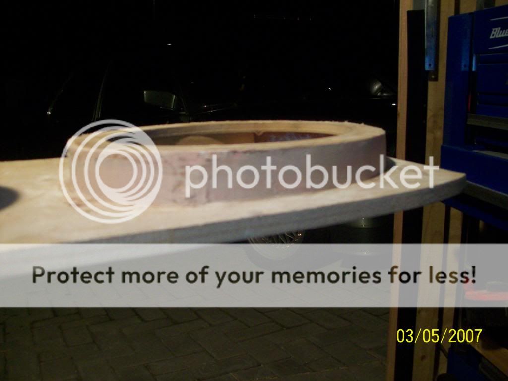

check out my pictures mark i made a parcel shelf for my 6x9s and they dont hit the window nor did i have to do any cutting
you need spacer rings 12mm mdf some bodyfiller spray glue acoustic carpet. in my car ive jl 6x4 in the kickwells jl twetters on the doors jl 6x9 rear shelf and a 10"vibe sub and its sounds awsome its not about what you got but how its all set up
