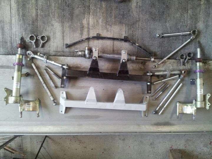

found in my archives a picture of some GR5 front suspension and steering assemblies. doesn't look too hard to fabricate!
