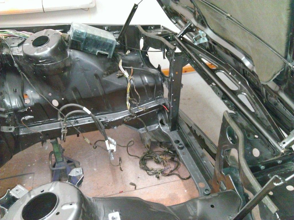

Im sorry i forgot today, i have got these two saved if any good
and i will 100% get more tomorrow :stupidme

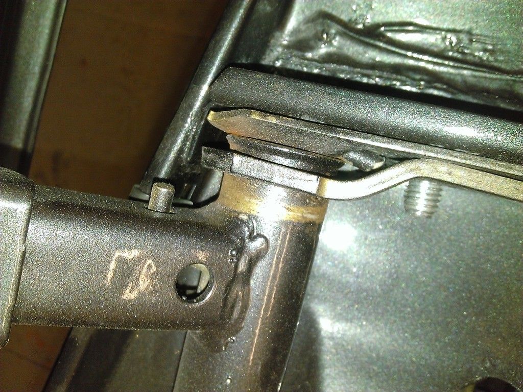

Thanks. It's the spring on the hinge part I've got wrong. The ends are hooked over the uprights where the hinges bolt to the slam panel
jimbob
Posts: 611
Location: Norfolk England
Re: Bonnet hinge springs
Post by jimbob »
ah you mean the spring inside the tube.

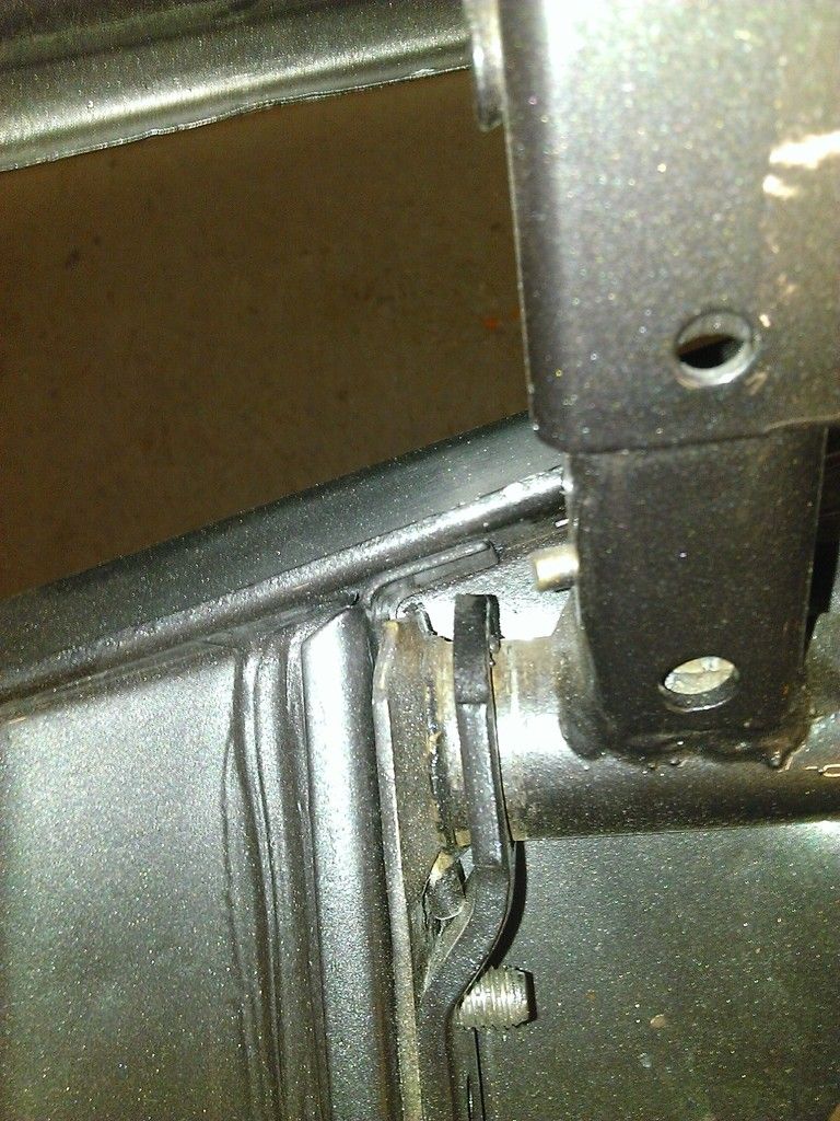

It is the springs in the tube. Just haven't figured out where they locate.

got these today dont know if any help
E36 328i Daily driver
E36 328i Touring
healeyneil
Posts: 187
Joined: Thu Aug 16, 2012 1:45 pm
My E21(s): '81 318is Baur - ahead of its time !
Location: Glasgow Scotland
Post by healeyneil »
That's perfect, thanks. I'll skin my knuckles tonight, then
