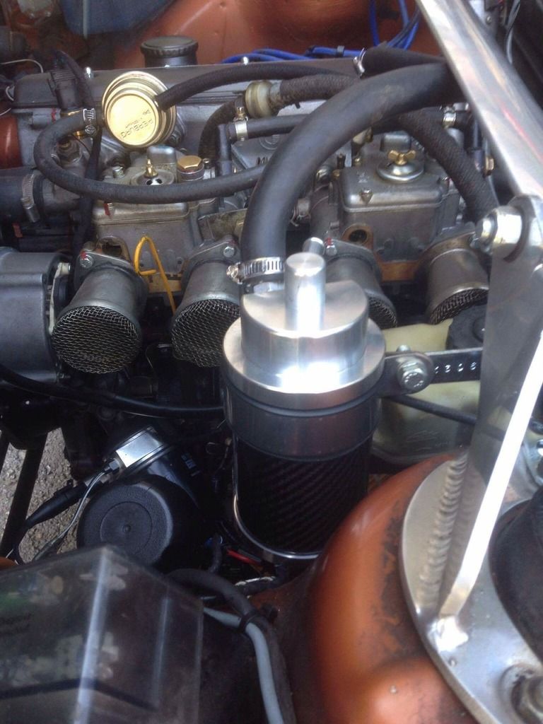

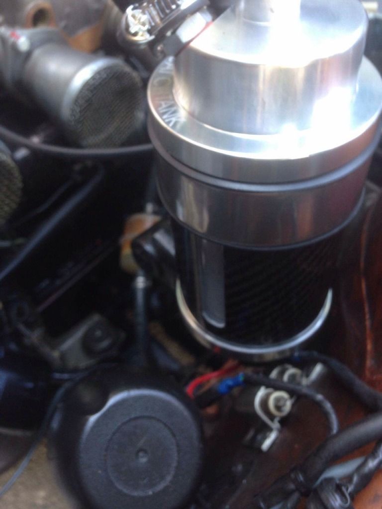

Re: Oil fumes from the head cover
We already connected it to an oil collector can, but still fumes escape
Let's see if it is just about some oil fumes from the breather, finally... :
Did about 150 km yesterday, to be the car's first short trip out of Athens area
Opened the hood, and there was oil spilled almost everywhere...My nice and clean engine bay - and engine- is now so dirty! Also, checked the oil level, and quite a big quantity was gone, for such a short (even though quick!!) drive. Had to top up today before setting off to return.
