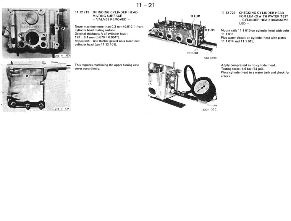

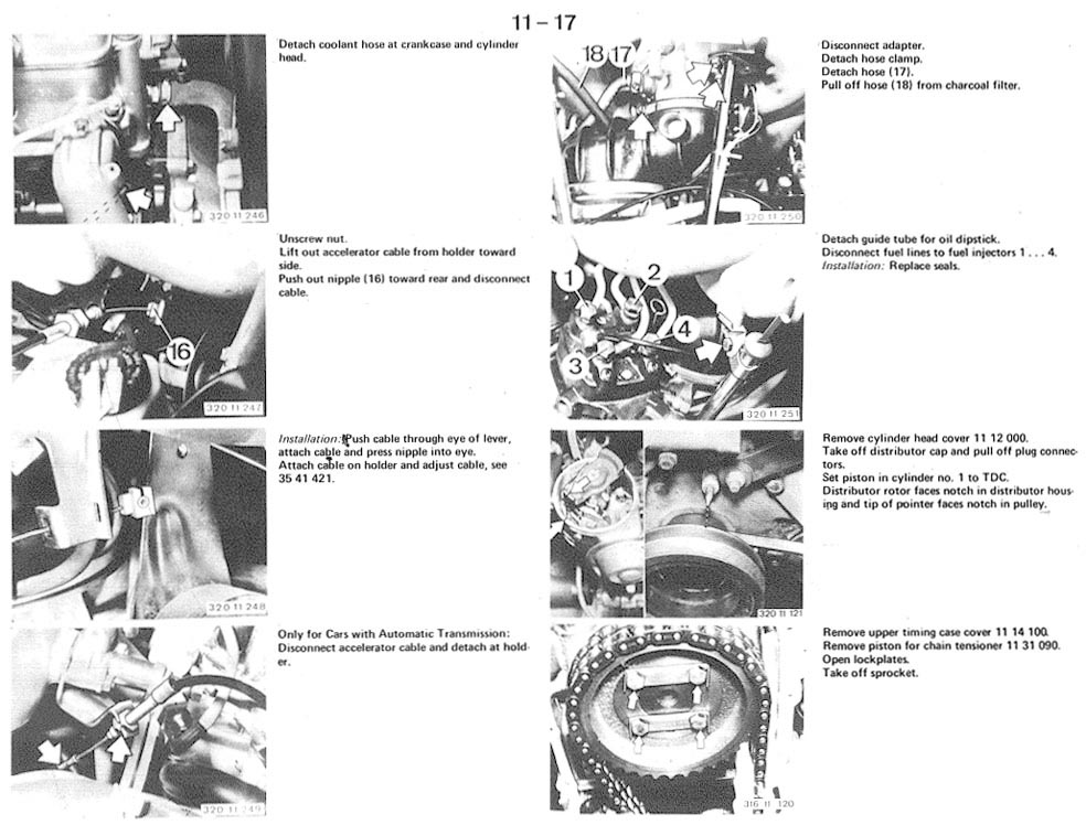

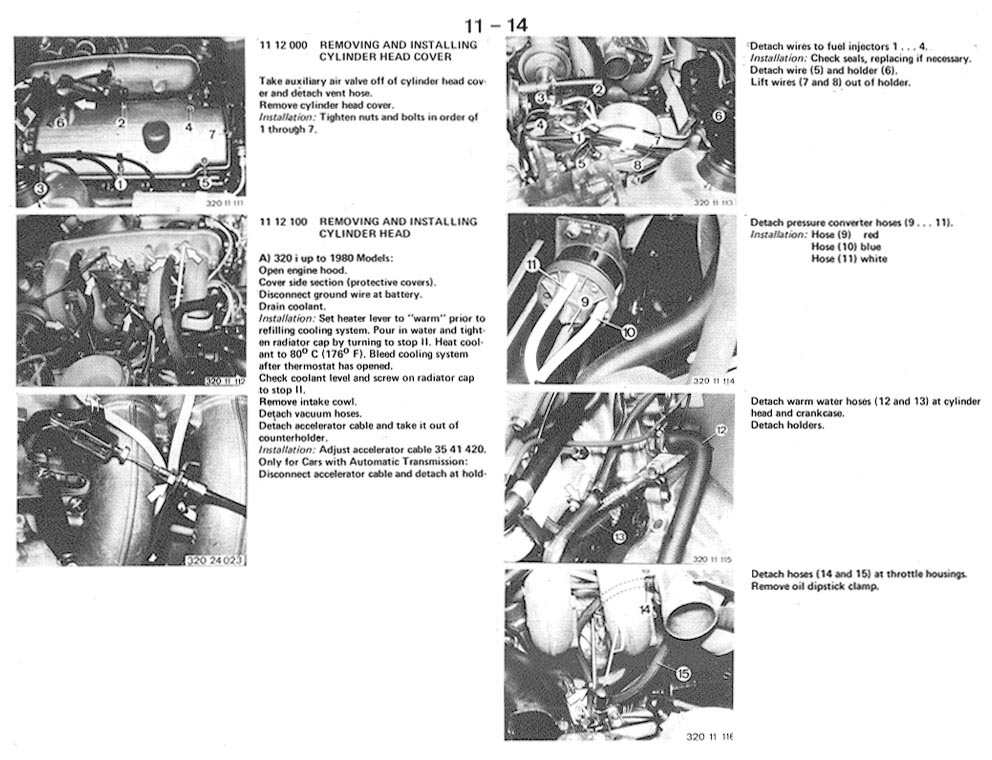

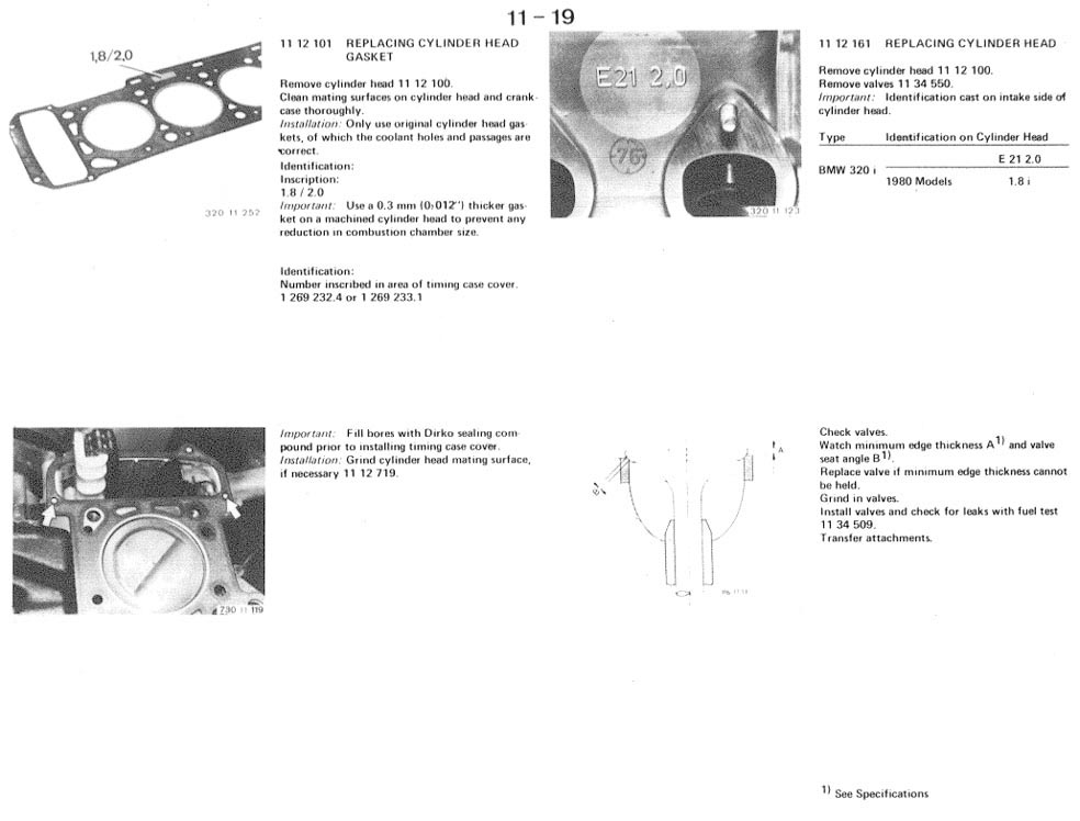

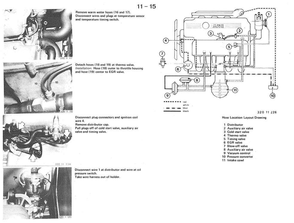

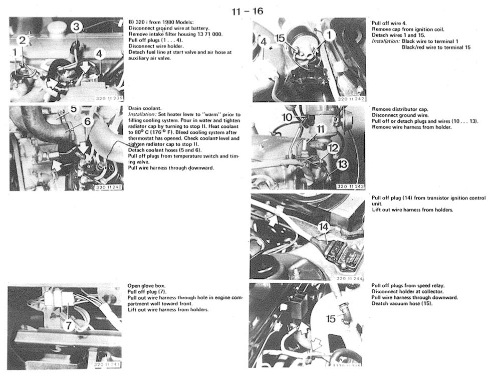

But I think it is easiest to remove the manifold since it is so large. I will put on a new gasket within some weeks and I do not intend to use any paste. Only around the oil holes the Haynes recommends to put something.
But carefully check whether the head is not warped or unflat. The flatness should be within 0,1mm. If it is more than that, contact a machine shop to flatten it. Don't forget the cover since it needs to be decreased in height the same amount.
What is the reason you are replacing the gasket?

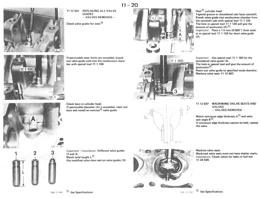

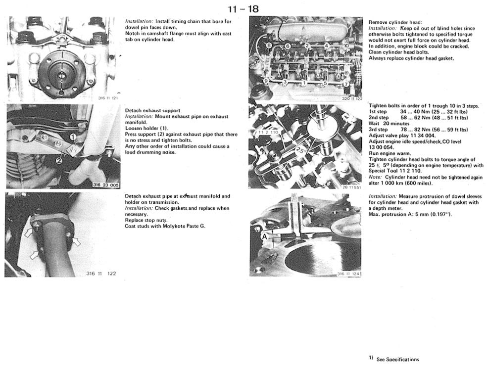

Here are some pages from the BMW Blue Book:

Before removing the head, I would apply pressure to the cooling system and monitor a pressure gauge for any leak. Unless you really want to learn the removal procedure.
