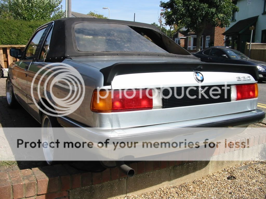

As you can see in the pic below, the original top is past its prime. A fellow e21 enthusiast and old freind of mine is on his way down from London either friday or sat. to help me change it. I have been asking around for advice, but it seems that not many of us have changed one personaly before so I thought I would take some pics and talk you through our adventure! I hope you get something out of it. I will post pics and updates as we go.

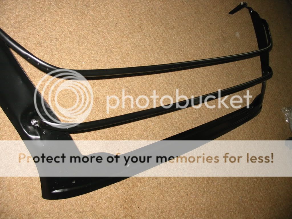

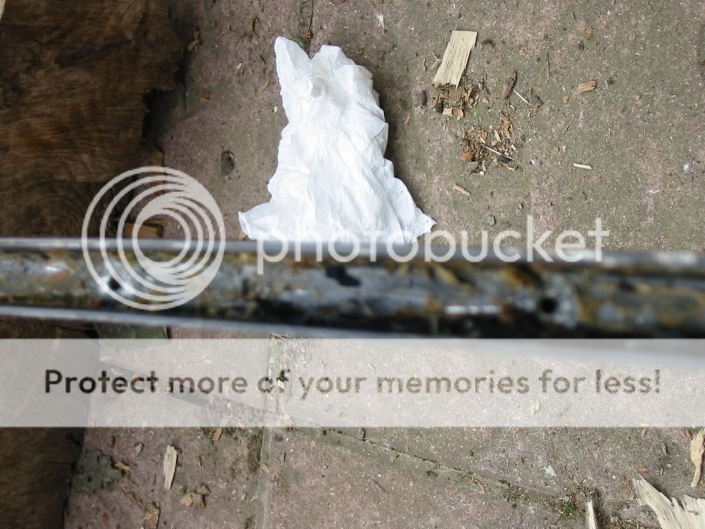

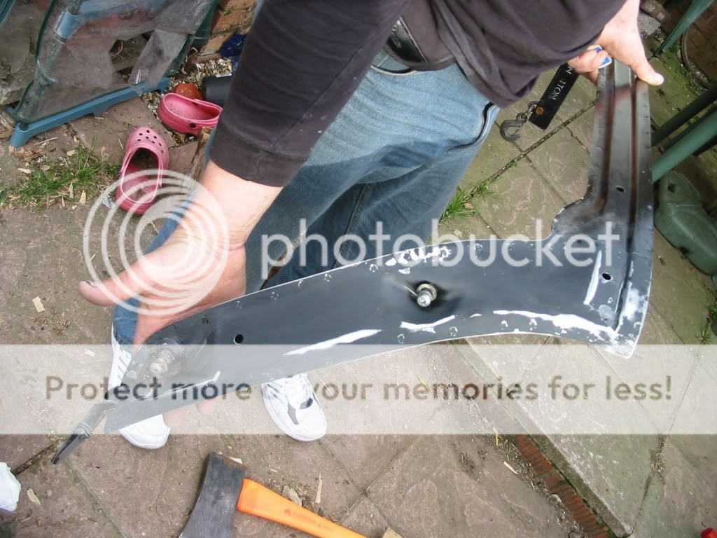

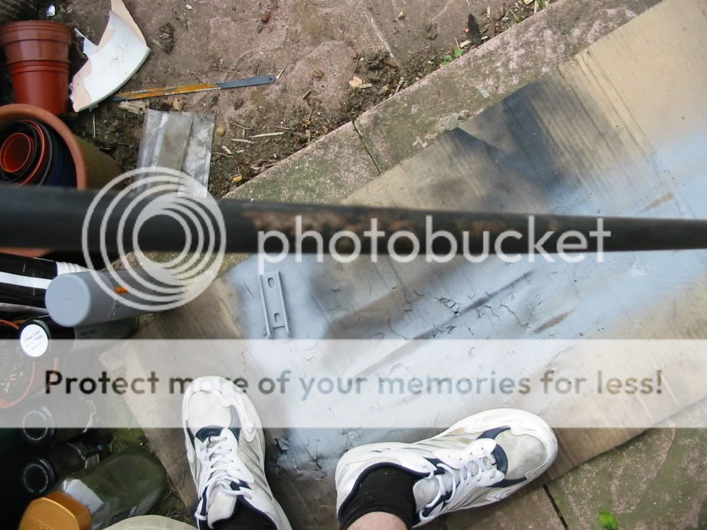

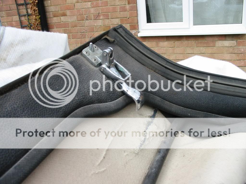

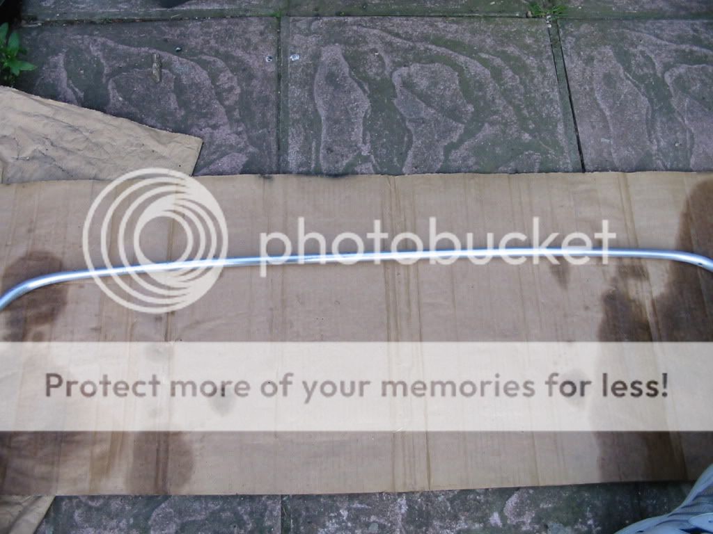

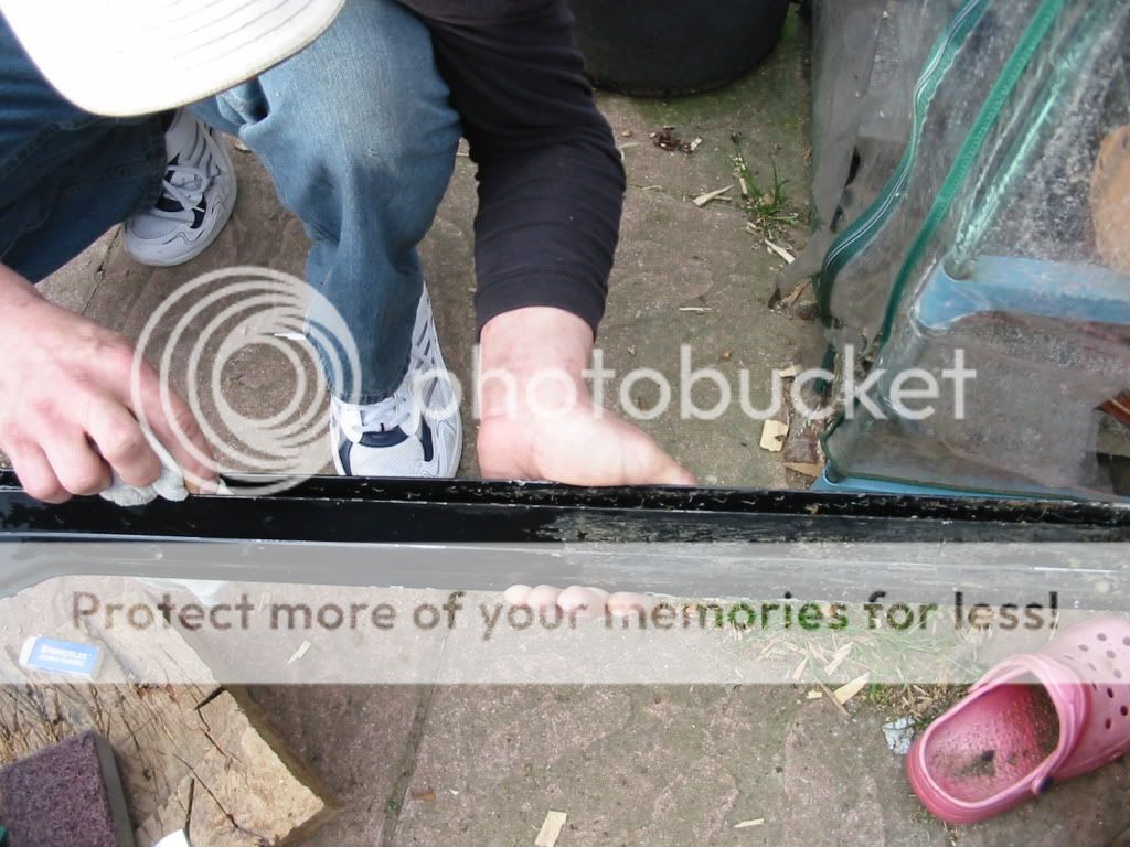

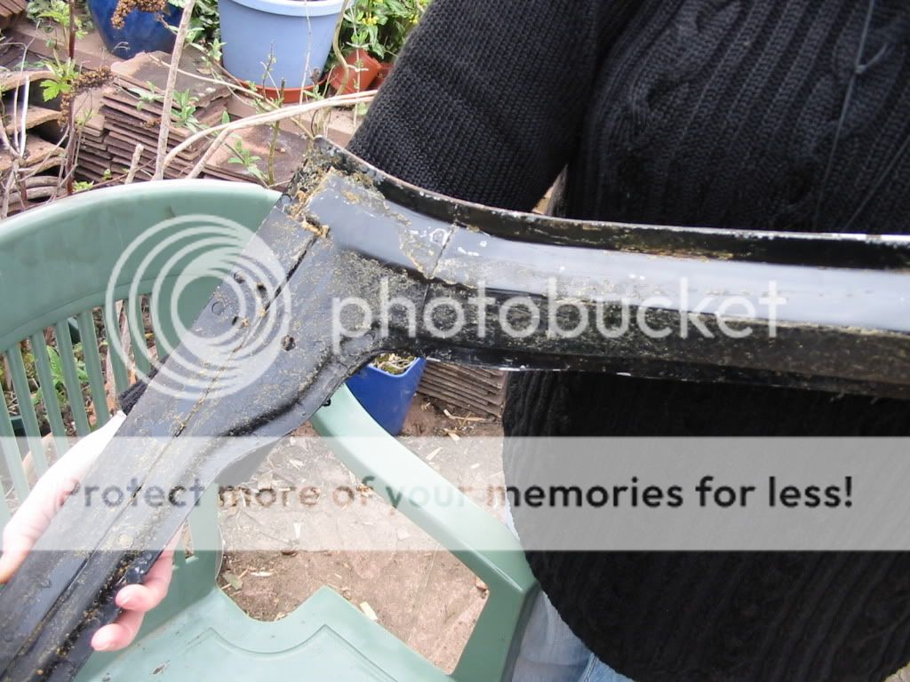

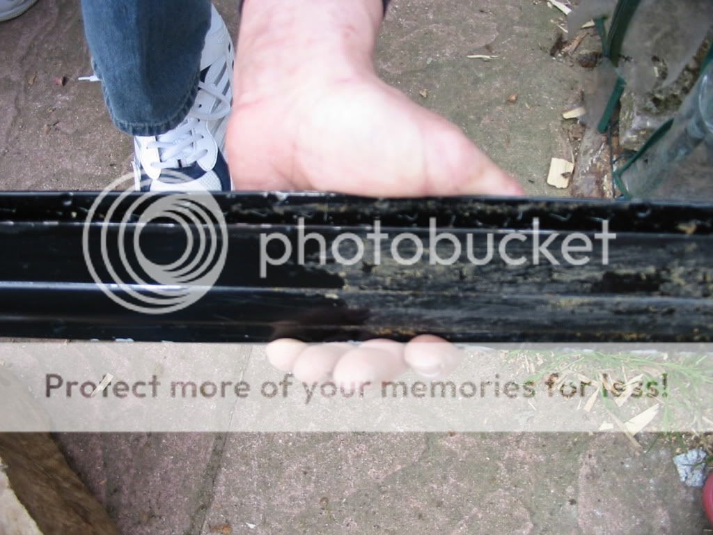

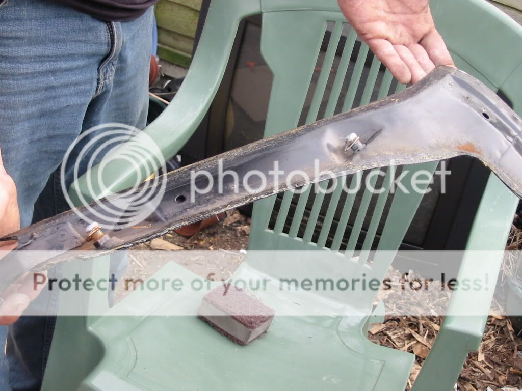

So first step was to get the top off and strip the frame. Luckily the frame was in good nick just needs a clean and a respray.
http://i701.photobucket.com/albums/ww15 ... 54_IMG.jpg
http://i701.photobucket.com/albums/ww15 ... 67_IMG.jpg
http://i701.photobucket.com/albums/ww15 ... 49_IMG.jpg
those are the befores now some middle and afters
http://i701.photobucket.com/albums/ww15 ... 60_IMG.jpg
http://i701.photobucket.com/albums/ww15 ... 59_IMG.jpg
http://i701.photobucket.com/albums/ww15 ... _IMG_2.jpg
http://i701.photobucket.com/albums/ww15 ... 89_IMG.jpg
http://i701.photobucket.com/albums/ww15 ... 63_IMG.jpg
I found that good old petrol was just the trick to remove the old glue. It also worked great at cleaning the brush I used during construction.
