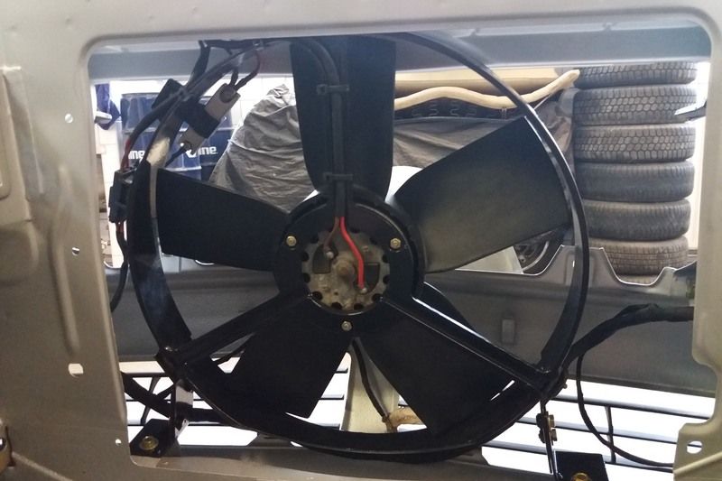

My car is a type 1, so it is fitted with a electrical fan, instead of the later type 2 visco fan on the waterpump. According to the last MOT papers the fan was not working properly, second stage did not kick in. The fan uses two sensors. The first one kicks in at about 90 degrees Celsius, to a 60% resitor. Second sensor kicks in at about 99 degrees Celsius and gives 12volts on the fan, so full speed.
When I tested my fan, the bearing made noise. Of course I snapped the axle when I tried to losen the nut, that turned out to have a left threat. So I got a different fan, from a e23 745i. The fan it selve and the house are the same. I took that one apart and cleaned it. Could not get the bearing out, to clean it, so I boiled out the grease dirt and used pressed air. After five times it was clean.
All greased and put together: works like a charm at two speeds!

And from the enginebay. Rad sits behind the fan.

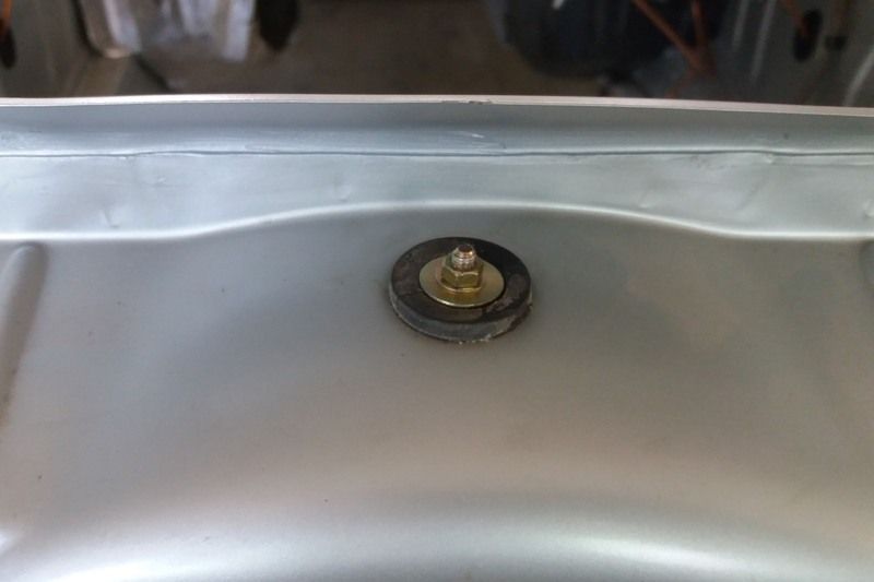

And the crown to my work: the nut!
