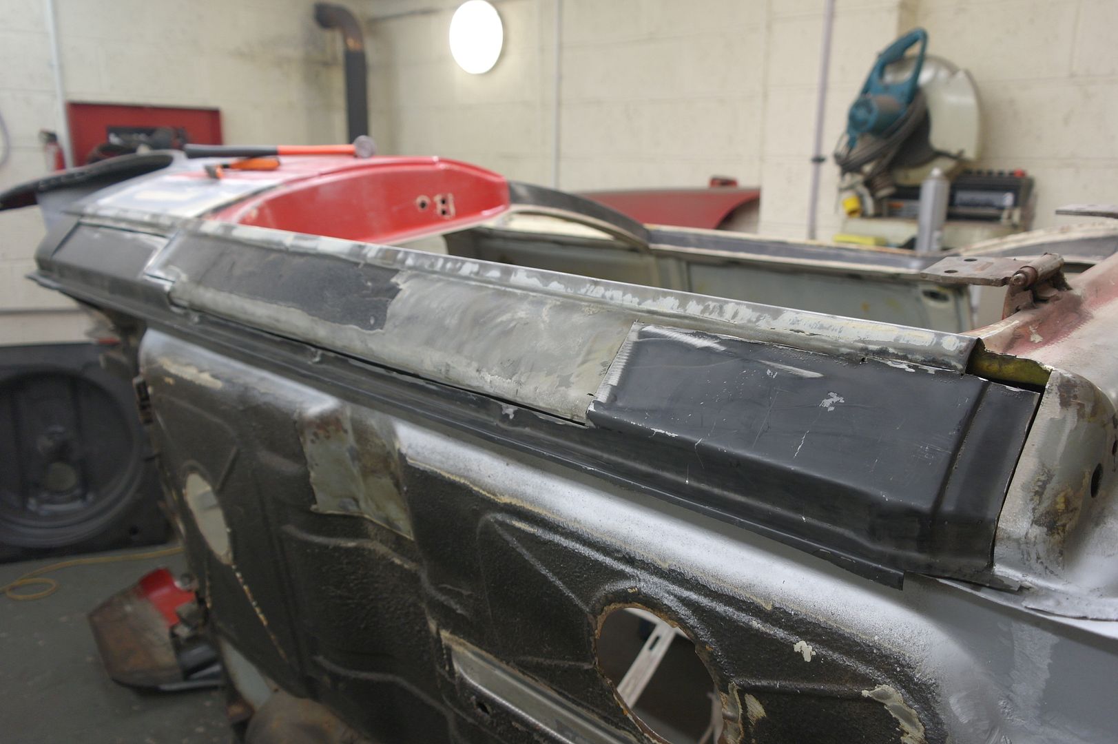

Not much new to show but started the same the other side.
removed the repair panel and it was in better condition than the other side :banana
Im getting faster at this only took and hour to get to this stage. :popcorn
