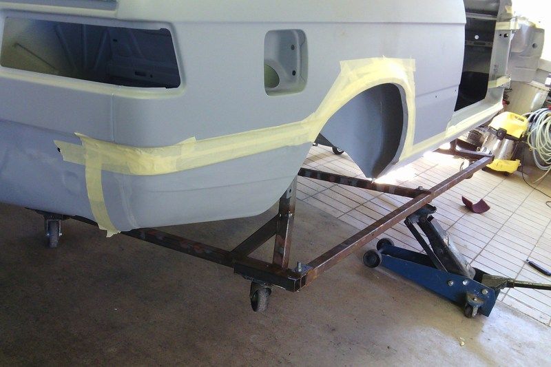

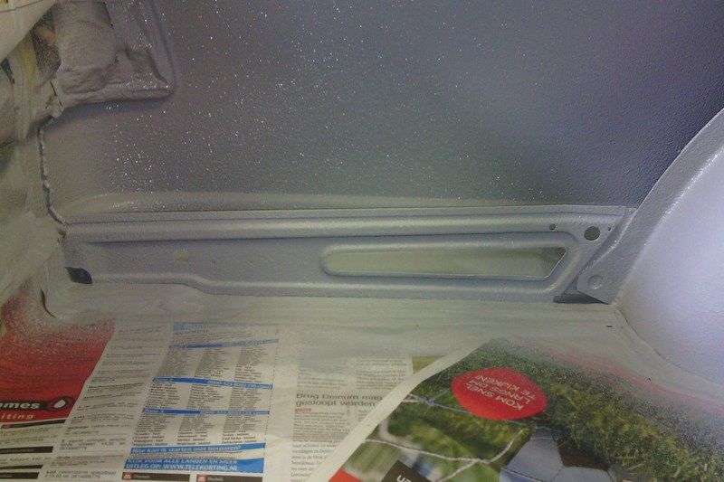

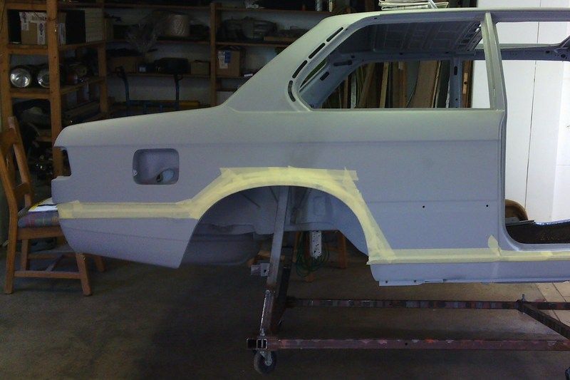

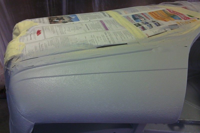

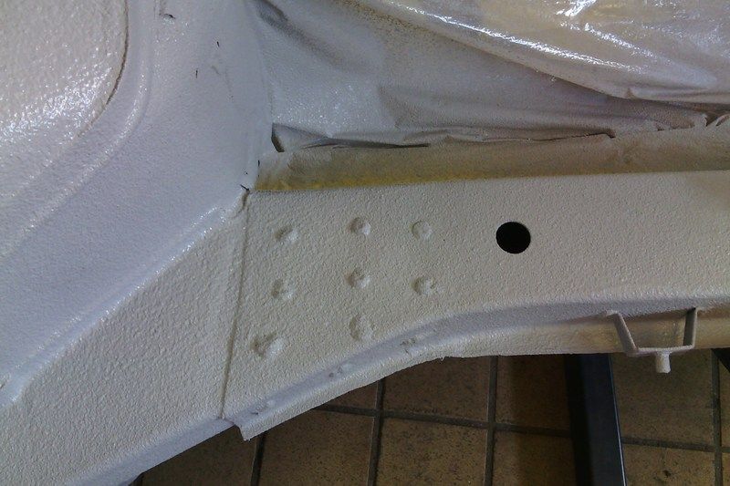

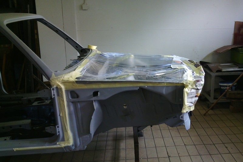

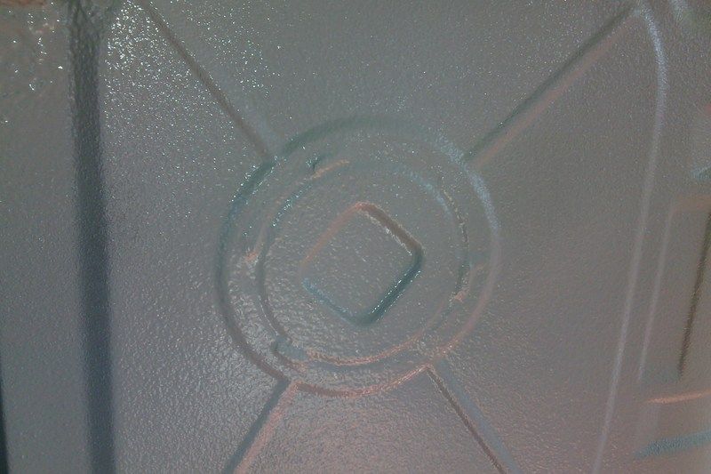

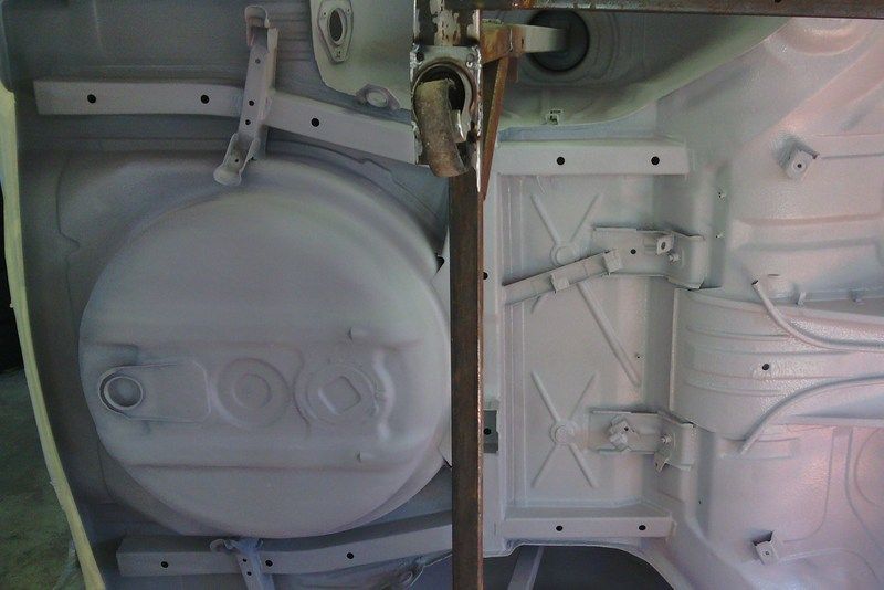

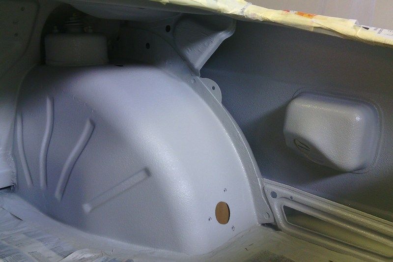

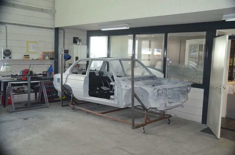

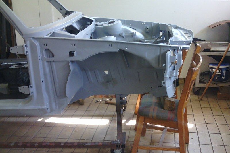

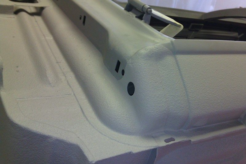

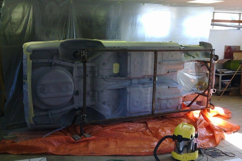

The inside is covered with the damping material. After that I got the frame from under the car, so I could sand and paint the contactsurface with the frame.

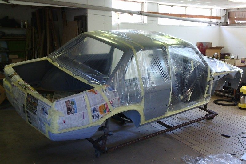

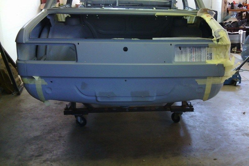

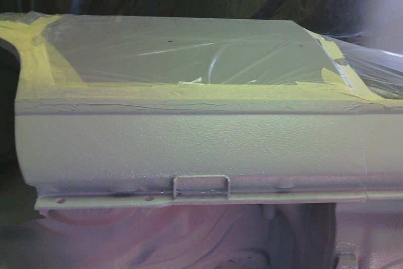

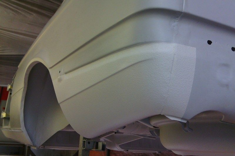

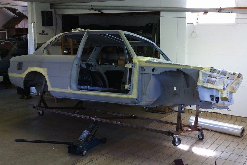

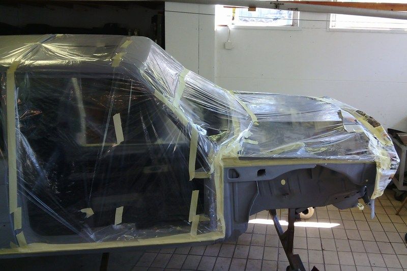

After tha, I prepared the car for spray on anti stonechip undercoating. I used Dinitrol 448, which is waterbased. Started with wrapping the car.
Rear side was a bit tricky, because i didn’t know where to put the tape. Where does the seam go? I took measures from some very original cars, but BMW’s did a poor job, none where the same. I even found one car with two very different sizes of the stonechipcoating.
I put the tape on 50mm from the panelseam.
Then I build me a nice paintbooth :bag
The result is very satisfying.

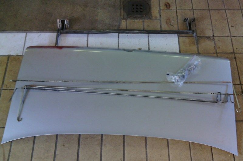

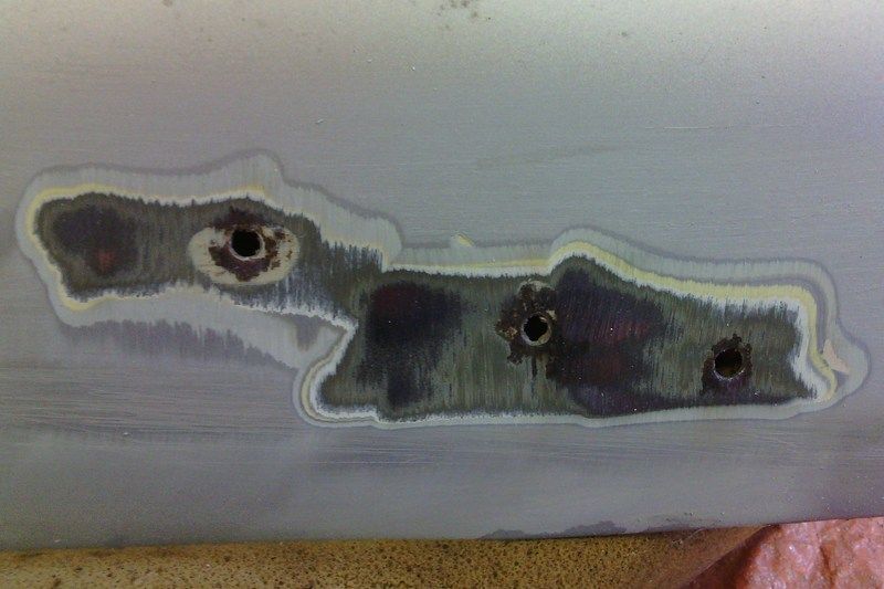

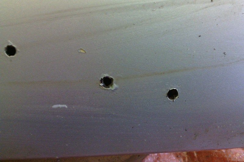

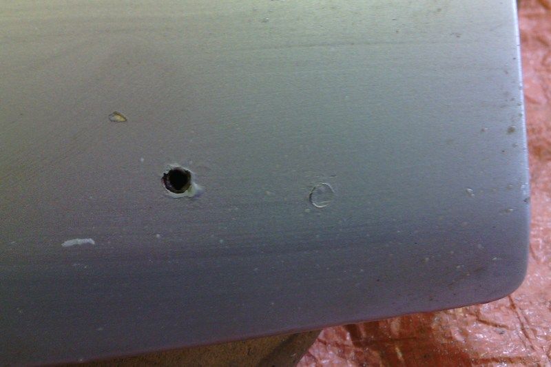

The bootlid, seems to be in a good nick. But the holes for the typeplate are not how I want them. Not straight and a wornout hole.
A closer look shows a strange round shape.

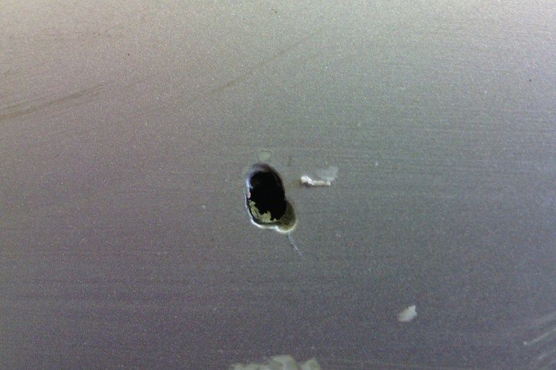

A push and we have an extra hole. This stupid car never seizes to amaze me…
Another hole looks like two holes joined.
Sanded it and found some rust around the holes. So I cleared the rust and welded the holes shut.

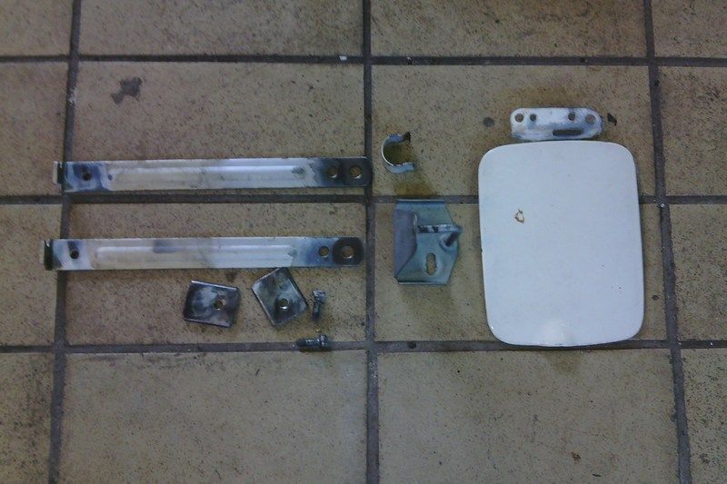

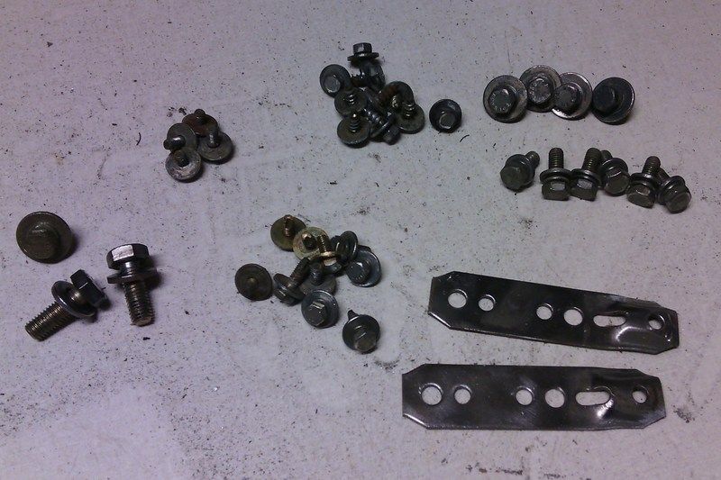

Nuts and bolts from under the bonnet, front wings and bootlid and some other stuff that needs to be painted.
Boothlid with torsionbars and bonnetbar.

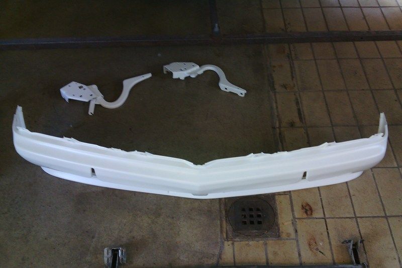

My fresh sandblasted and primered front valance and boothinges

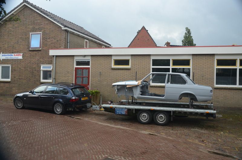

When all was done, the car was ready for transportation to the painter.
At the painter who welded the roof back in 2012.

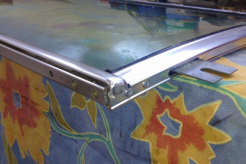

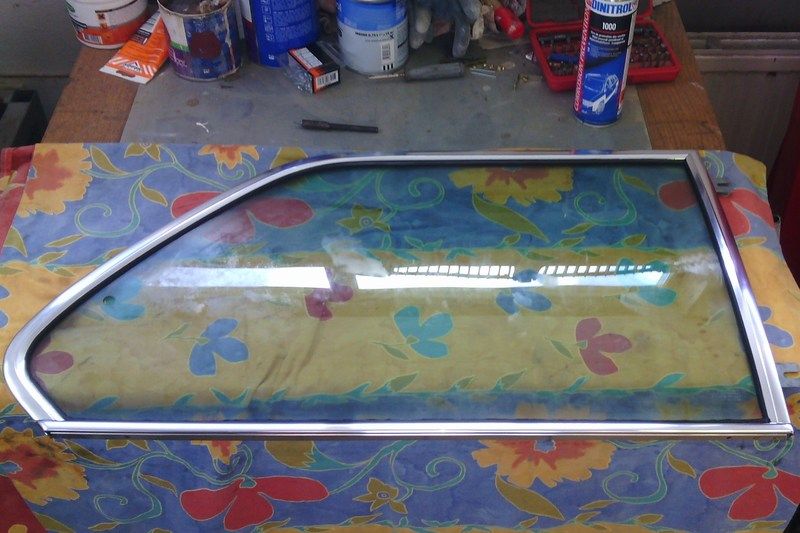

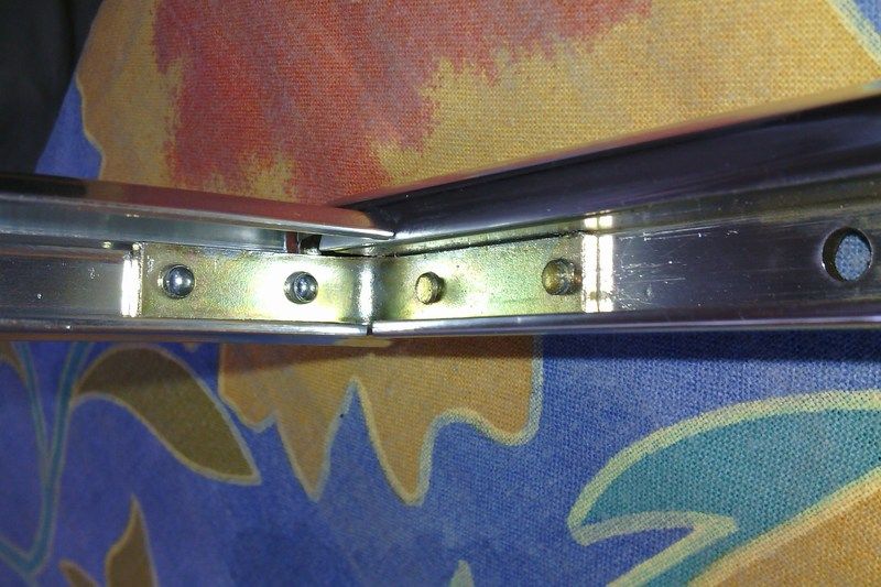

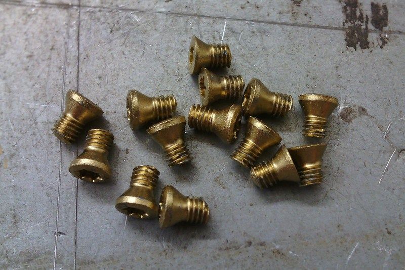

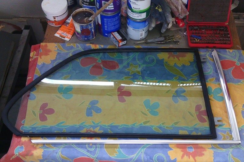

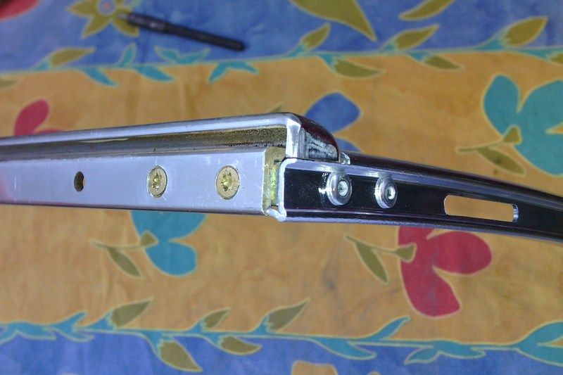

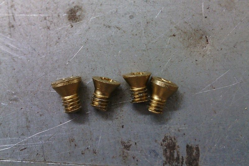

Now the car is gone for paint, I have some time for other chores. I went on with my popout windows, for which I bought those Chinese screws. But those screws were too long, so I cut them off. The head of the screw is slightly too thick for the lower moulding, so I grinded it down, because I didn't want them to scratch the lower moulding. After that I had the screws zincplated.
Two normal and two grinded heads.
Besides the screws, I need some ribbets to put it all together. I found these blind rivets, 5mm long and 3mm thick. Perfect fit.
And put it together.
Mouldings, rubber and glass.
And this is what a brand new pop out window looks like. New mouldings (NLA), new rubbers (freakin’expensive), new glass (long, long wait)

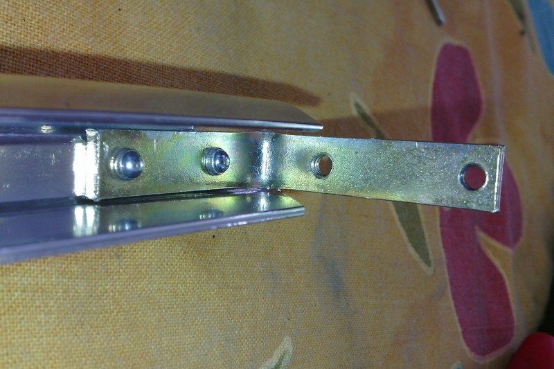

To put the glass in the rubber and that in the mouldings, you need some lubricant. I used Dinitrol, which preserves the mouldings and metal connection angles. I ordered those angles at BMW’s. The upper one, 90 degrees, is NLA. So they send me the 60 degrees one, double. But as I tried tob end it to use it fort he upper corner, it didn’t fit. All three angles are only usable fort he corner that theay are meant for. The holes don’t line up on the other corners.

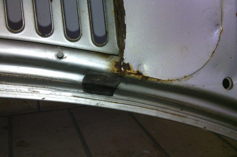

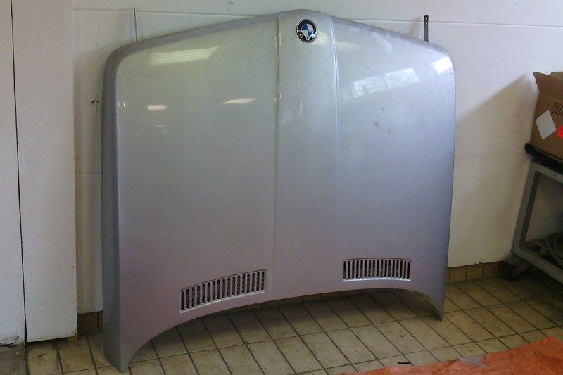

And we started on the paint job!! At first we started to prepare al the loose parts, starting with the bonnet and trunklid.
The bonnet was the best of two I have, but still some spots, lots of dirt and a rotten ledge.
This much dirt came off…
This ledge is repaired, here before grinding and sanding.
