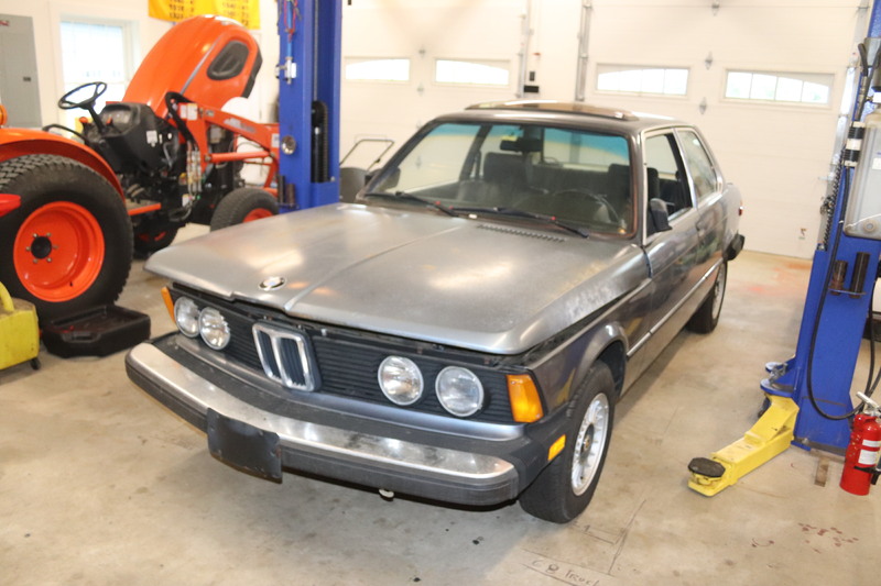

Greetings.
I am a new member from New Hampshire, USA.
I recently purchased a 1983 320i from a friend of a friend. It has not run for approximately 25 years. The transmission was sold from the car several years ago so I need to find a 5 speed with manual speedo provision. That is a problem for another day as I want to make sure I can get it running first.
I first checked to make sure the engine spun freely, then checked for spark and it has spark so ignition seems to be in order.
Next I pulled fuel injectors and found no fuel from the injectors. I did not hear fuel pump run.
I pulled the internal fuel pump and hooked it to a battery and it does not work at all.
I then removed the external pump and it also is dead.
I looked in the tank and it had quite a bit of corrosion so I pulled both tanks from the car and I am in the process of cleaning and sealing them. I have orders fuel pumps, fuel pressure accumulator and a filter. When I finish the tanks, I will put it all back together and hopefully fuel distribution box will be good otherwise that will be the next project.
While I have the tanks out, I will replace the brake lines to the rear brakes. They are badly corroded so I will replace the hard lines between the two sides as well as the rubber hoses. The drums and shoes are in good shape so I reconditioned all the internal parts to the rear brakes and square that all away before reinstalling the tanks.
That is where I am at this point, hopefully I can get it running and then I will start to think about a transmission. Hopefully I can find one.
The car is in pretty good condition with no serious rust and just need some minor body work and a good polish. The hood needs a respray but not sure I will even do that. My goal for the car is to make a nice reliable driver and have fun with it.
Future plan would be to look at all bushings, control arms, suspension and really get it back to a solid, comfortable ride. I am very much open to advice, tips and tricks, ideas and opinions.

I have replaced most of the fuel delivery system. Starting at the back I replaced both fuel pumps, the fuel accumulator and filter. I replaced the feed and return lines from back to front, I replaces the vent hoses and the hose from the filler neck to tank and the hose between tanks. I had taken the tanks out and cleaned them out, had the holes welded up and a patch done where it was too thin. I put rocks in the tank and acid, shook it up and cleaned it really good. Then I put Evaporust in there to get any residual surface rust, cleaned that all out with water and then dried them good with a heat gun. Finally sealed the tanks with a tank sealer and cleaned the outside really well and painted them.
On to the front. Replaced both the hoses from fuel distributor to input and return lines and all fuel injectors.
Now I am waiting on the hard black plastic lines that go between fuel distributor and warm up regulator. I am going to take that off, clean it good and put it back with the new lines when they come in. The car is running pretty well when warm now.
I found a Getrag 5 speed transmission, cleaned it all up, changed the fluid and installed a speedo gear in it.
Replaced the rubber bushing on the drive shaft as well as the carrier bearing.
Not sure I already mentioned it but I replaced front brake hoses, pads and calipers. Rear brake cylinders, soft lines and most of the hard lines. I also had to make a new hard line for the right front. Brakes are a little spongy but I'll bleed them really well before I go further there. At least they work. So the car now runs, moves on it's own and stops.
When new fuel lines come for regulator if it is still hunting while idling, I''ll probably take the fuel distributor off and really go through it but I am hoping to avoid that if possible. We'll see how it runs.
